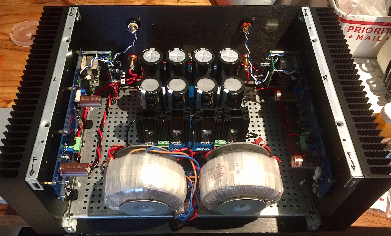

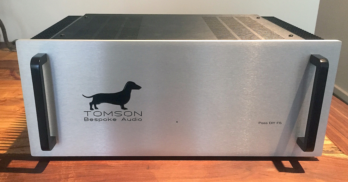

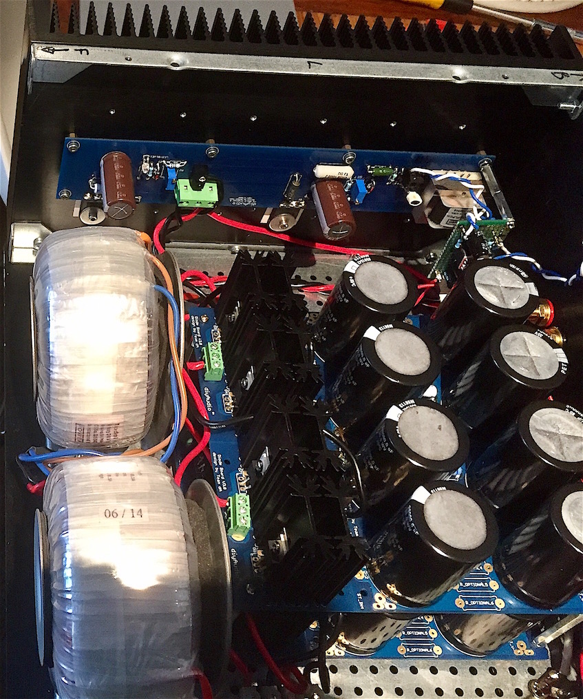

I built a dual mono F6 with 2 x 400 toroids in the deluxe 4U chassis and it is totally dead silent with my ear to the speakers - but that is on 86dB SPL speakers (Quad electrostatics), I'll add pics.
PS, the handles come from the local hardware store, they are kitchen cupboard handles, $18 each - a bargain I thought!
