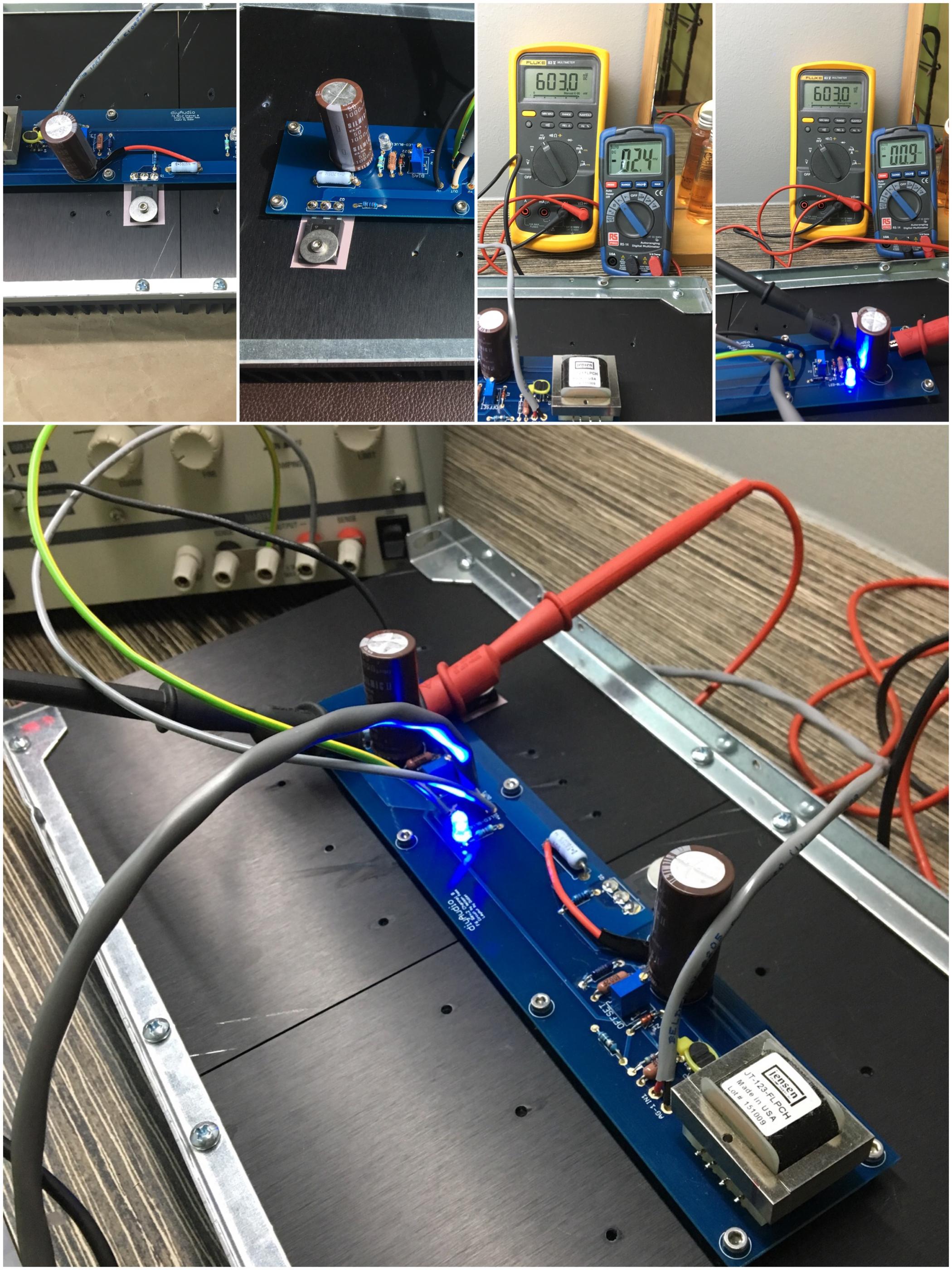

My first Pass amplifier - in progress
Building my first Pass amplifier - the F6. The last amp I build was a UCD than 10 years ago. Build is still in progress - I have just finished testing the F6 boards using a bench power supply. Manage to get it to bias around 600mV - still creeping up slowly as the temperature increases. I will need to fine tune it once i put them into a case. Power supply parts are still on the way, so, I have to wait
Photos attached - this is the 'simple' ac degeneration version. Boards from diyaudiostore, with SK170/SJ74/IRFP240.
