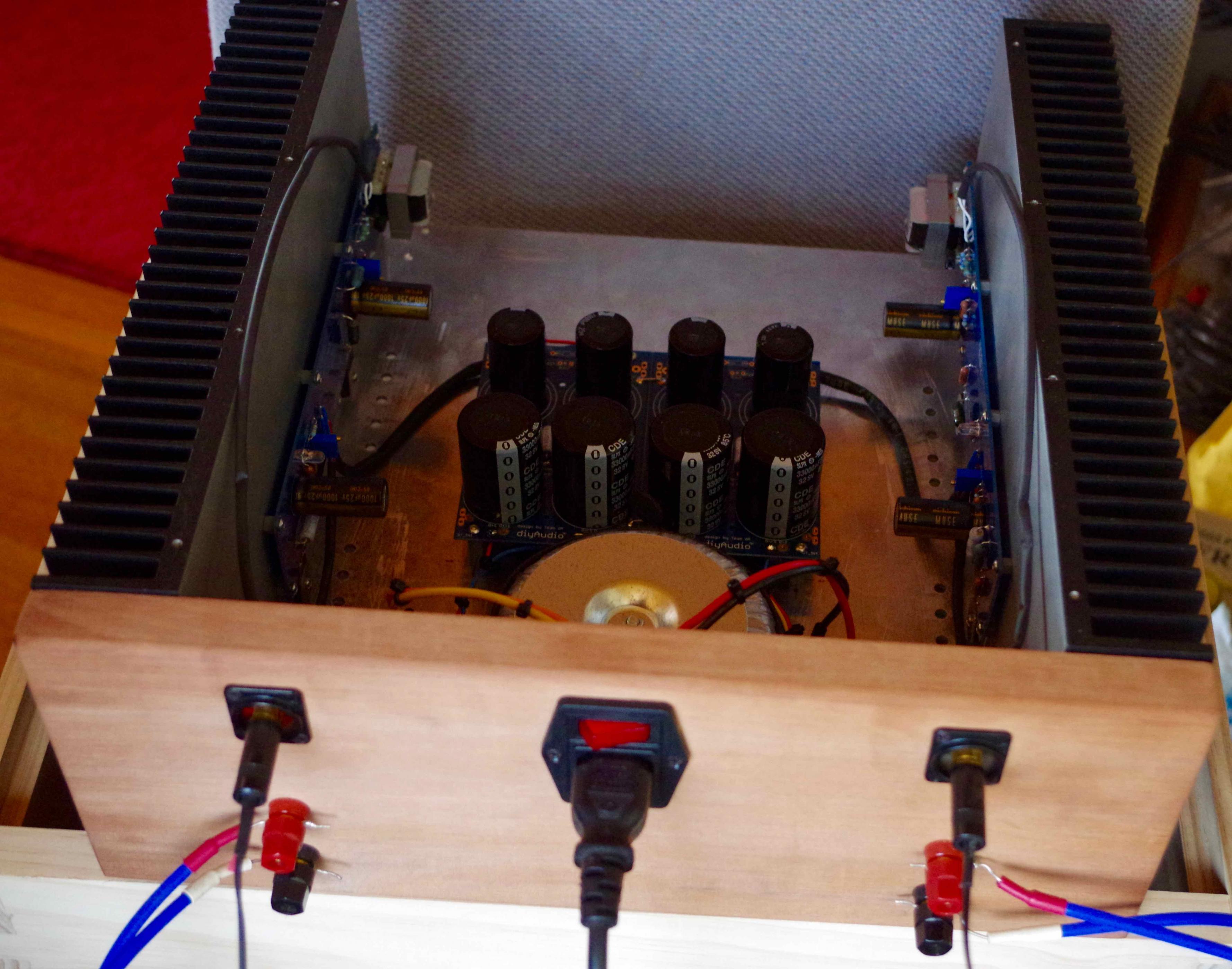

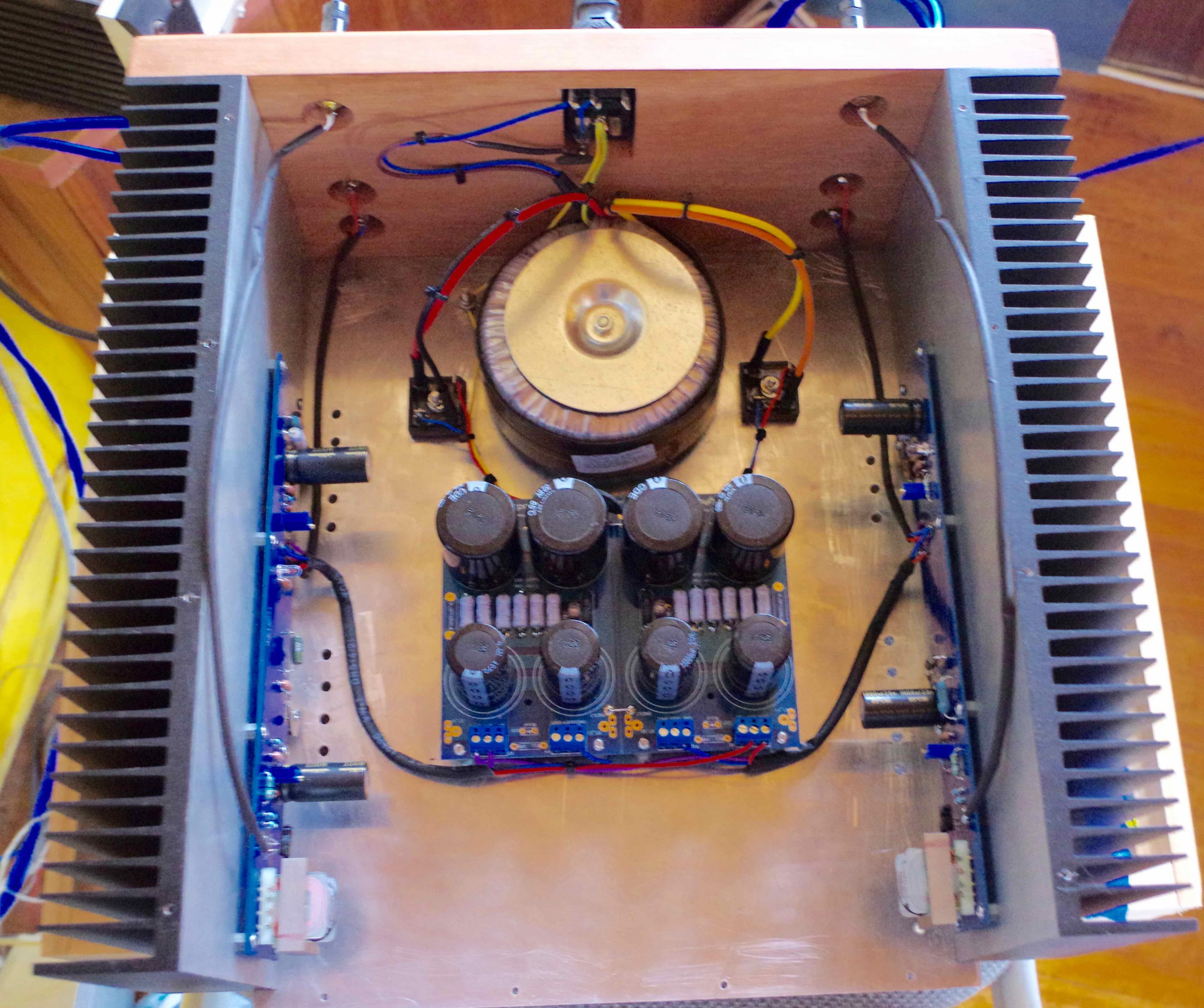

I built mine as per 6l6 build guide, same chassis, etc.
Success My first PASS amp build comes to life.
I am the proud owner of an F6 amp Many Thank's To Nelson Pass for being so generous.
6L6 for the fantastic build guide.
DiyAudio for the boards and members willing to share there knowledge.
Many Thank's.
Steve.

Very impressed with the sound.
Still need to finish the case and reverse one of the LEDs.
Steve.
Leds are a funny thing on this amp...I followed the traces, used a multimeter to find the correct orientation....but one didnt light up...well, it had a tiny dot of light. Reversing leeds fixed it.
Russellc
