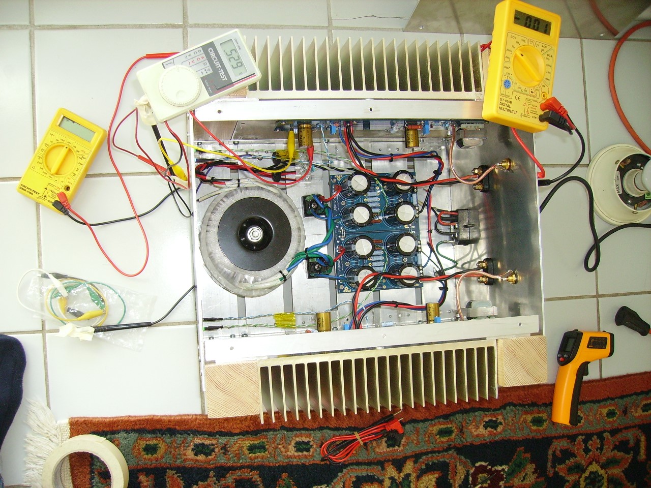

Right channel under test/running with 60 w light bulb at medium brightness
Using the 6.2 v Z and 3.3k resistors (dunno about the Ohms from Memory only) but read/followed as Zen Mods suggestion.
Bias trimmer runs out of travel (clicks) at 0.386 V with Offset at 0 at that, but offset Bournes is also within a turn of Clicking as well
Are the 6.2v Z 's and those resistors Not allowing any higher bias ??
Device Temp is at 27 C after an hour.
Ohhh Just realised that the Bulb tester gizmo shouldn't ?? be in circuit for this
Back to the meters to reset and try again

It's Alive!
Without Tester Bulb in Circuit
It biased /set up Foolishly easily.
0.55v.. 0.00v offset.. devices at 45C, Heatsink at 40C Seems (so far) as rock steady
Really it's embarrassingly simple.. Once one knows how
All that's missing Now is to button up and attach Speakers

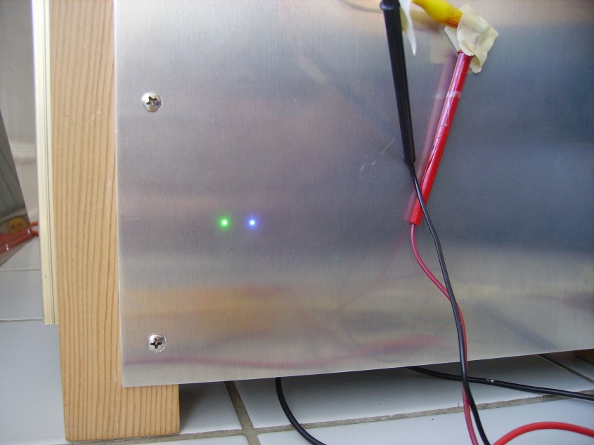

Small issue with my Leds. I fitted 3mm ones to 1/32" holes in the front panel. Still Too Bright, especially the green PS ones.
A wee trimmer pot fitted inline to dial in the brightness.. perhaps?
A passable idea? if so, any quick suggestions for a trimmer value ?
