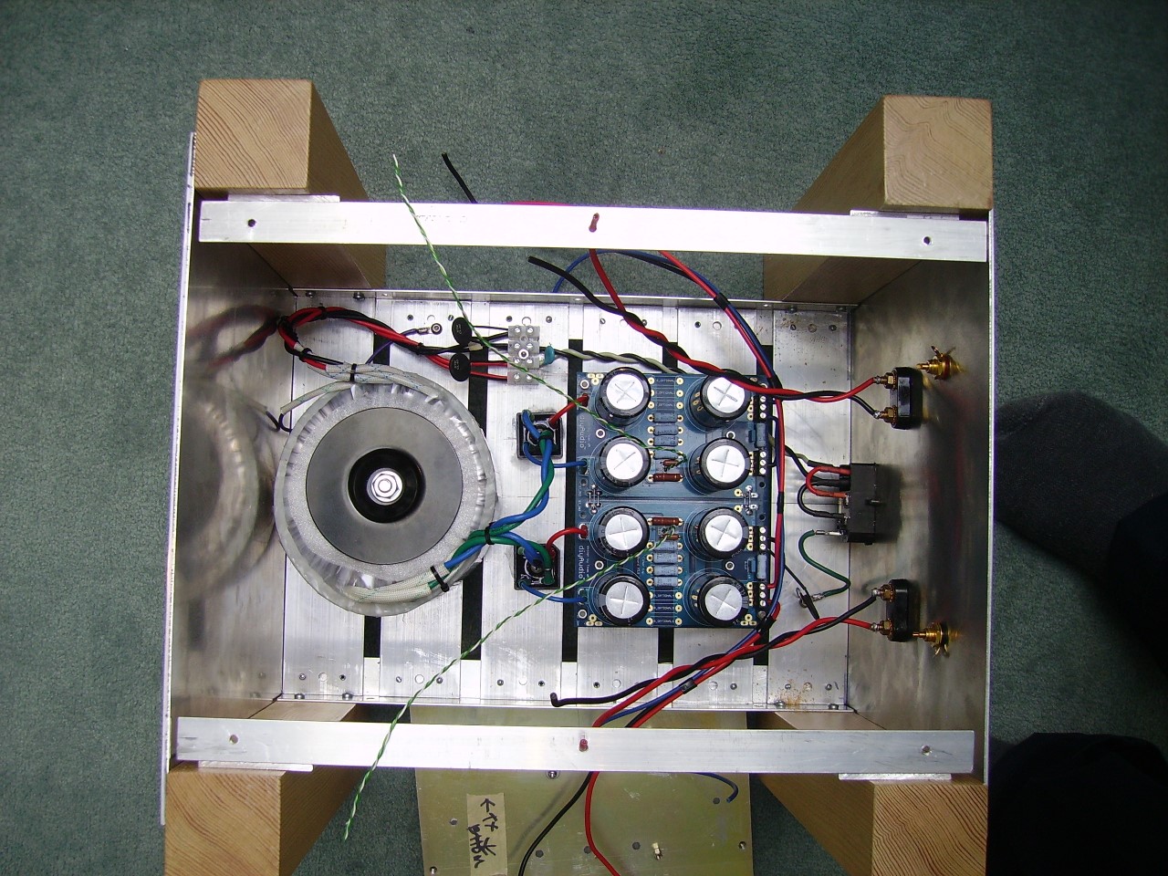

Got my Box 'o bits pretty well all assembled.

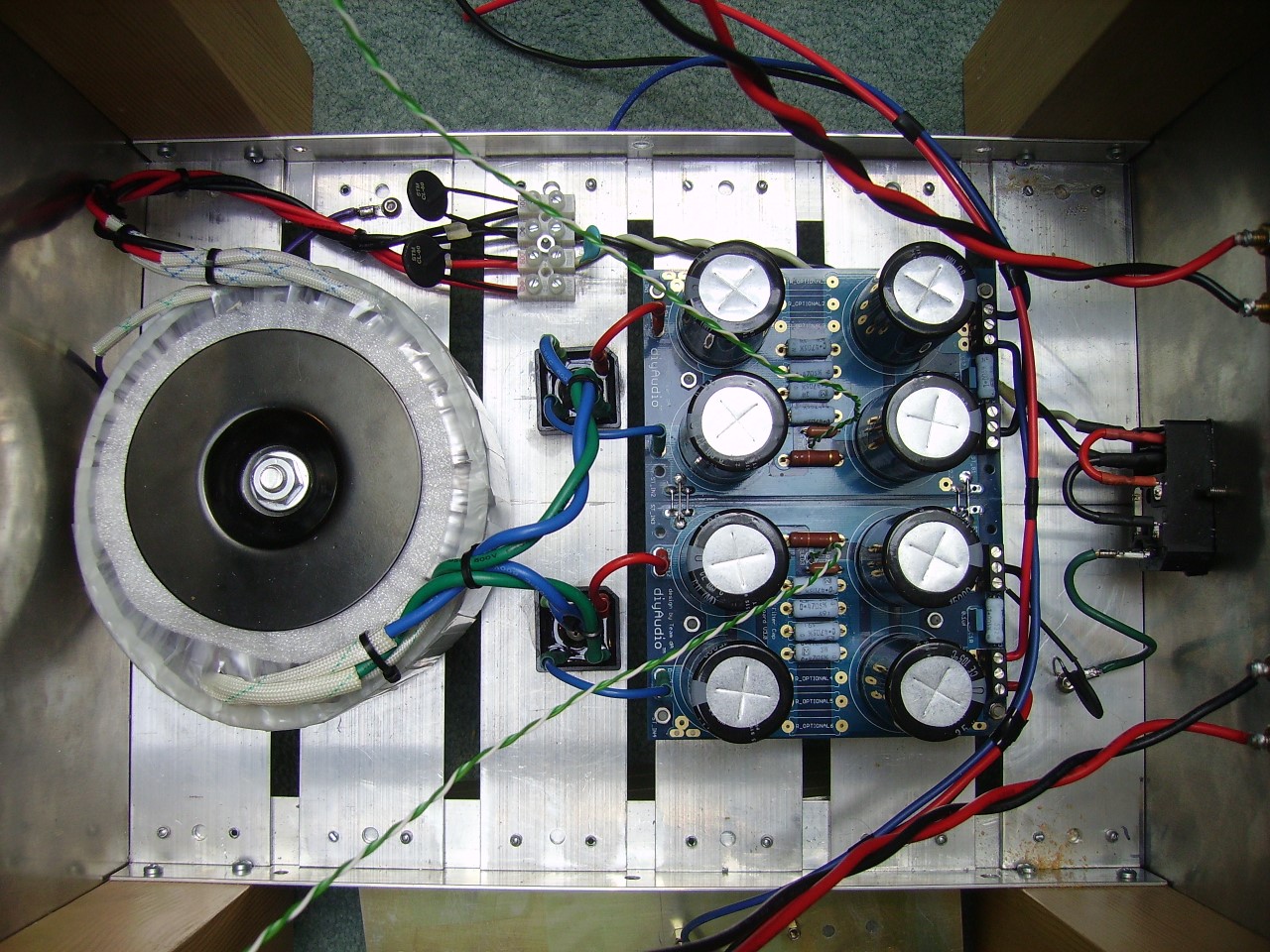

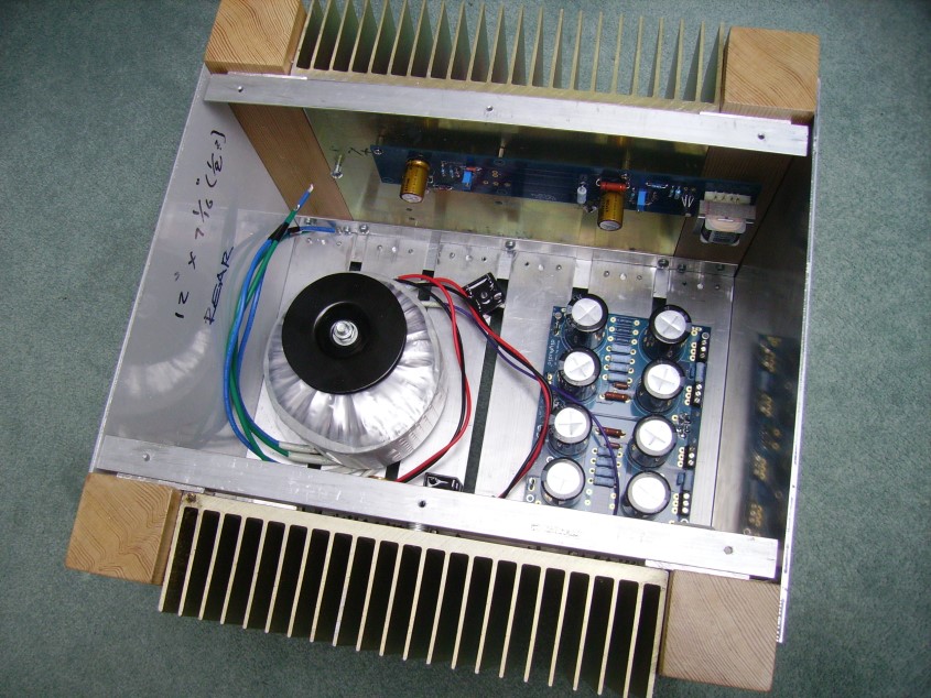

After dithering about re vertical or flat Mounted Tx I now realise that those Rectifier cubes 'could' be better located behind the transformer... Sould I wait and see? or relocate now?
Going to make a Light bulb tester next, check the PS for volts,
then mount the amp boards.. And try to learn Biasing 😱
Attached photos.. just in case there are obvious bungles.. thanks.

ZenMod will probably ask or recommend to you as he did with me
You need air circulation
Heat will cause your components to fail prematurely
So if you relocate the bridges to the corners - then you can use the middle section by adding air circulation slits or holes

at least one Alu strip can be removed and at least one can be decreased in width
in fact , there is possibility that he already have enough air circulation , looking at space between Alu strips

I must be going blind
The black sections looked like tape and now with a magnified look I see that they are strip openings

Hoping there is enough allowance for internal air circulation.
5 slots each 1/2" wide = a fairly large hole
I have step drills though 🙂
Sinks are 2+ Kilos each and fins are biggish at 65mm
I assumed as an F6 only has 4 devices, no extraordinary measures are required?
Sooo.. should I relocate those bridges ?? Just how much do those pesky things radiate?
Was following 'more or less ' 6L6's illustrated guide layout. Is it wrong, or did I get lost along the way?
Did eventually note that the Real FW F6 took care to mount those bridges into far corners.. a bit late though
Perhaps ? even re Mount the Tx vertically or does vertical mounting lead to other issues?
ie; focusing Tx fields directly into the Amp.
Newbie.. consequently finding it tricky to.. get it right.. on the 'first' build
