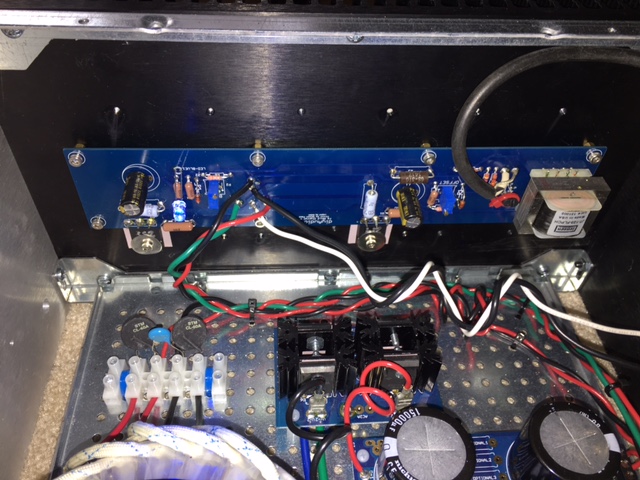

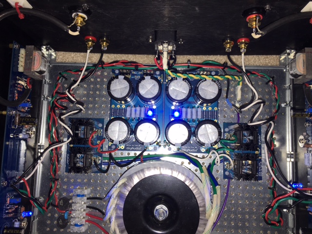

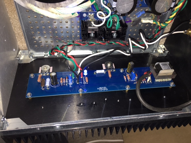

need help troubleshooting F6
PSU 25.4v
completed wiring to pcbs and am trying to set bias and offset, I'm not getting anything across the .47 resistor, clipped a lead on each side and all i get are 0.00
I get .022v on RT channel .027 across LT channel speaker outputs
went ahead an tested with a speaker to see if I have sound and I don't.
wiggled components, checked solder joints etc etc
help

You have to do a lot of turning on the bias pots. Maybe you just have not turned enough.

The problem appears to common to both boards. Check your ground scheme and be sure you are getting + and - and have the ground correct. The PS ground has to be correct or neither board will work. Unless you have incorrectly installed something or something has failed on the boards it will work. I think I remember having the same problem on one of my first builds and my common ground for the PS was not correct.
Then it has to be something wrong with both boards. You will probably have to pull the boards and check everything unless you have some knowledge of troubleshooting and the equipment to do it. Not that many parts to check on F6. Pull one board to start with. Maybe others will join in and give their opinion. Where did you get the jfets?
Everything came from the Diy store. And I will pull one and start.
Check the orientation of those jfets. I would definitely check the active devices first. Check the input transformers. Someone on the M2 thread broke some of the tiny wires but I doubt that is the case with your because it is both channels. Double check the zener's and make sure they are the right value. I took a look at the schematic to refresh my memory and there is not much to go wrong on that board other than the transistors and zeners which bias the circuit. It the jfets are in correctly I would pull one of the zeners first. Double check you have the right jfet in the right spot. Check R7 and R8 for correct value and P1 and P2 next.
thank you for the input and i will do some discover and post my findings.
