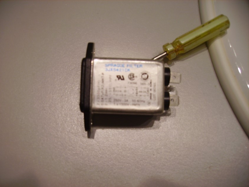

As my opinion, it not suits that the power inlets has emi filter, for class A amp. May be ok. for dacs, preamps, class d amp.Silly question really 🙂 Can / should I use this thing (rated at 3a)?
New but found in a drawer, or is a simple 2$ Chinese IEC plug with switch and fuse a better choice?
Sorry.. had a heck of a time getting even this fuzzy photo of it.
I do not think it will hurt anything, I have one in a box also, but I do not think it is necessary either.
