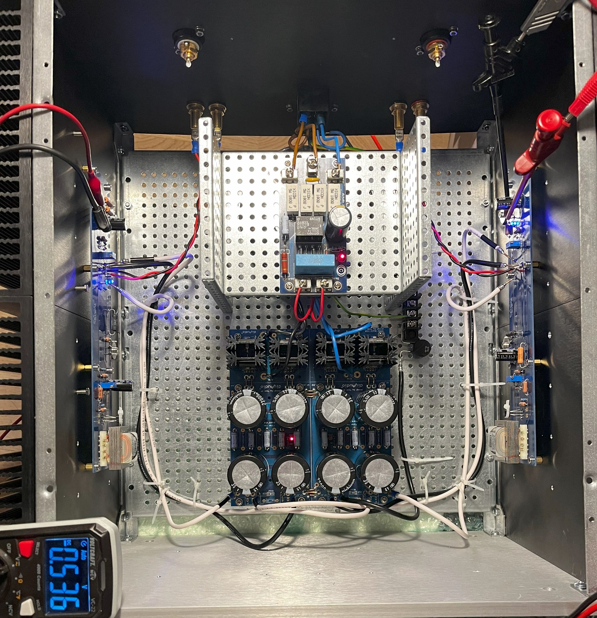

About a decade ago i ordered the F6 PCB and transformers from the shop.
About a year ago i got the idea that i should begin to assemble it.
Today i have finally reached Bias and everything looks good so far. (Except that one LED on the positive voltage power supply rail that i have put in the wrong way)
I am going to refer to this amp as vintage equipment when showing it to my friends.
Thanks to everyone in here for the enormous amount of information you have made available. It was a great help.
Special thanks to NP for releasing this excuse to have fun.

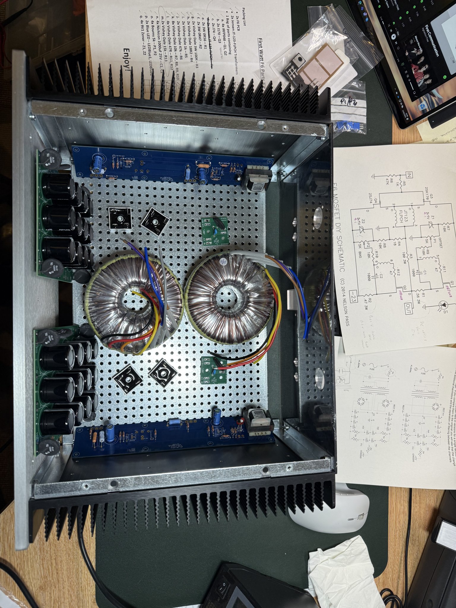

And we are off! Dual mono, using Nelson’s Bi-Polar power (I am lazy and liked that I could buy a kit).
Started today. Hadn’t bought enough green LEDs (classic read the instructions moment). So soldering on hold. Also thinking about wire connectors as I need to buy them too.
Pondering layout, it’s snug and I think I will stand the toroids up at the front. Need to play about and source a decent bracket (x2) if I do that. Any suggestions gratefully received.
Usual thanks to Mr Pass, the DIY Audio Store and the merry band of hero’s on here 🥳👏🫡

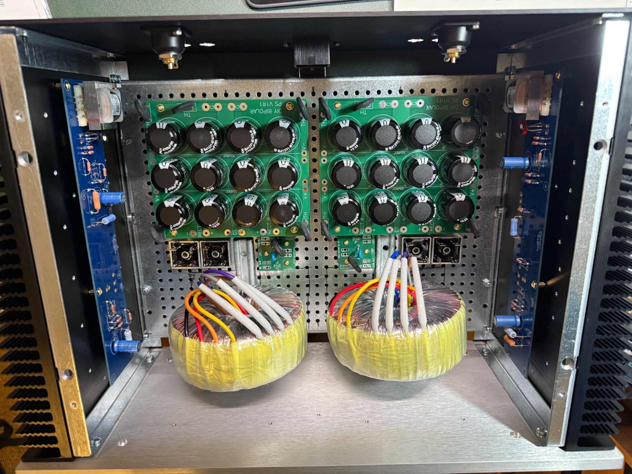

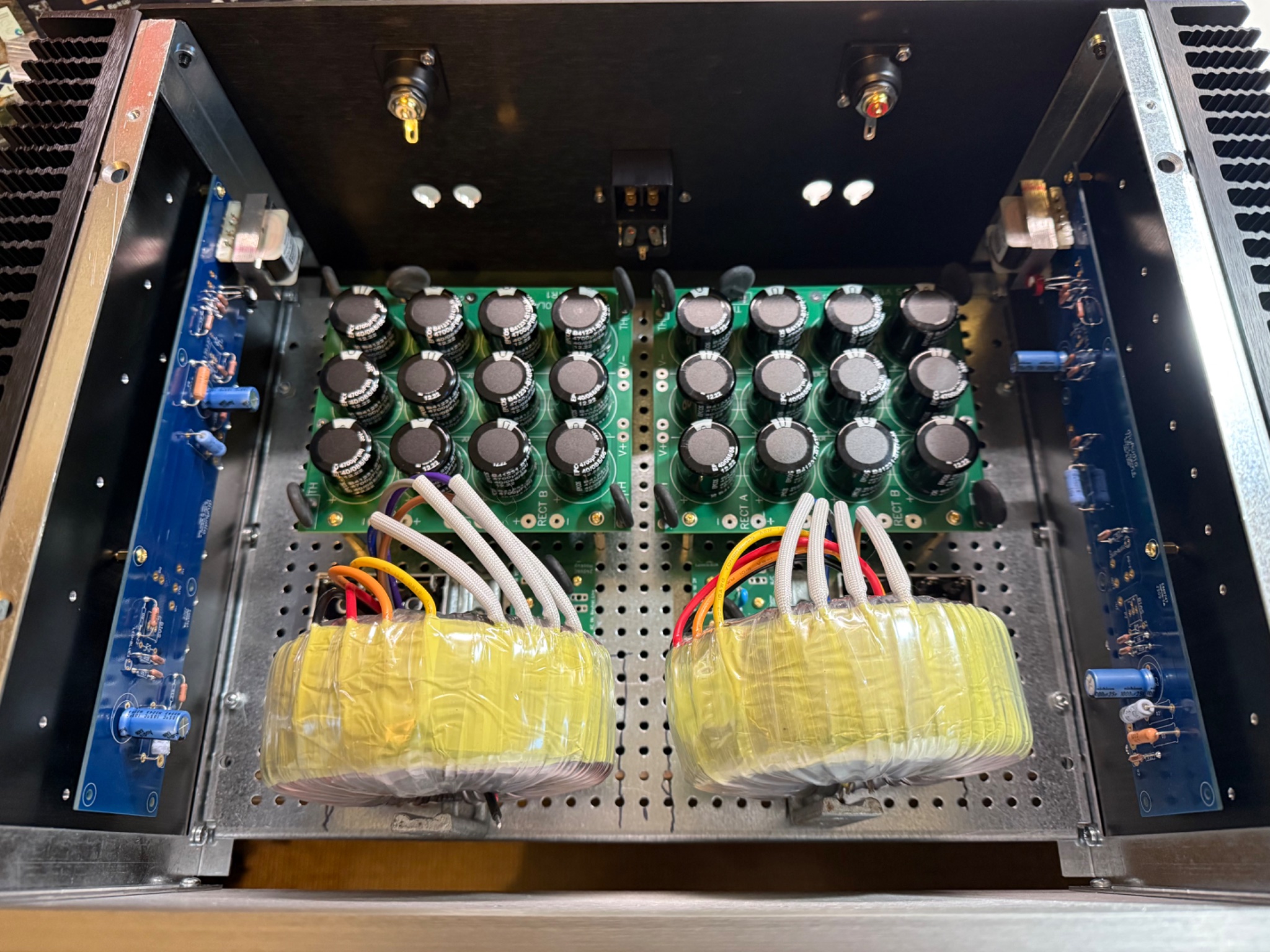

I thought you might like an update.
The amp has now been playing for a week without any issues.
It is by far the best amplifier i have ever had.
It knocks the socks of my Purifi based mono blocks that i was very impressed with.
Confusingly, this newfound audio nirvana has left me wondering what else i might be missing. Questions like "What difference would dual mono power supplies make?" keeps crossing my mind. This is clearly the completion of my transition to a greedy boy.

Found some brackets at the local hardware store, so the layout is coming on.
Does anyone know the part number for the kit blue LEDs? I put red ones in my first F6 and figured I would swap at the same time I retro the ZenMod green LEDs.
I just need to think about the various board connectors and wiring, none of which I have. I would prefer to solder them all, but I like the ease of removal should I want to tweak later.
If anyone has any observations on the layout please do holler, I’d really appreciate that before I cut metal.

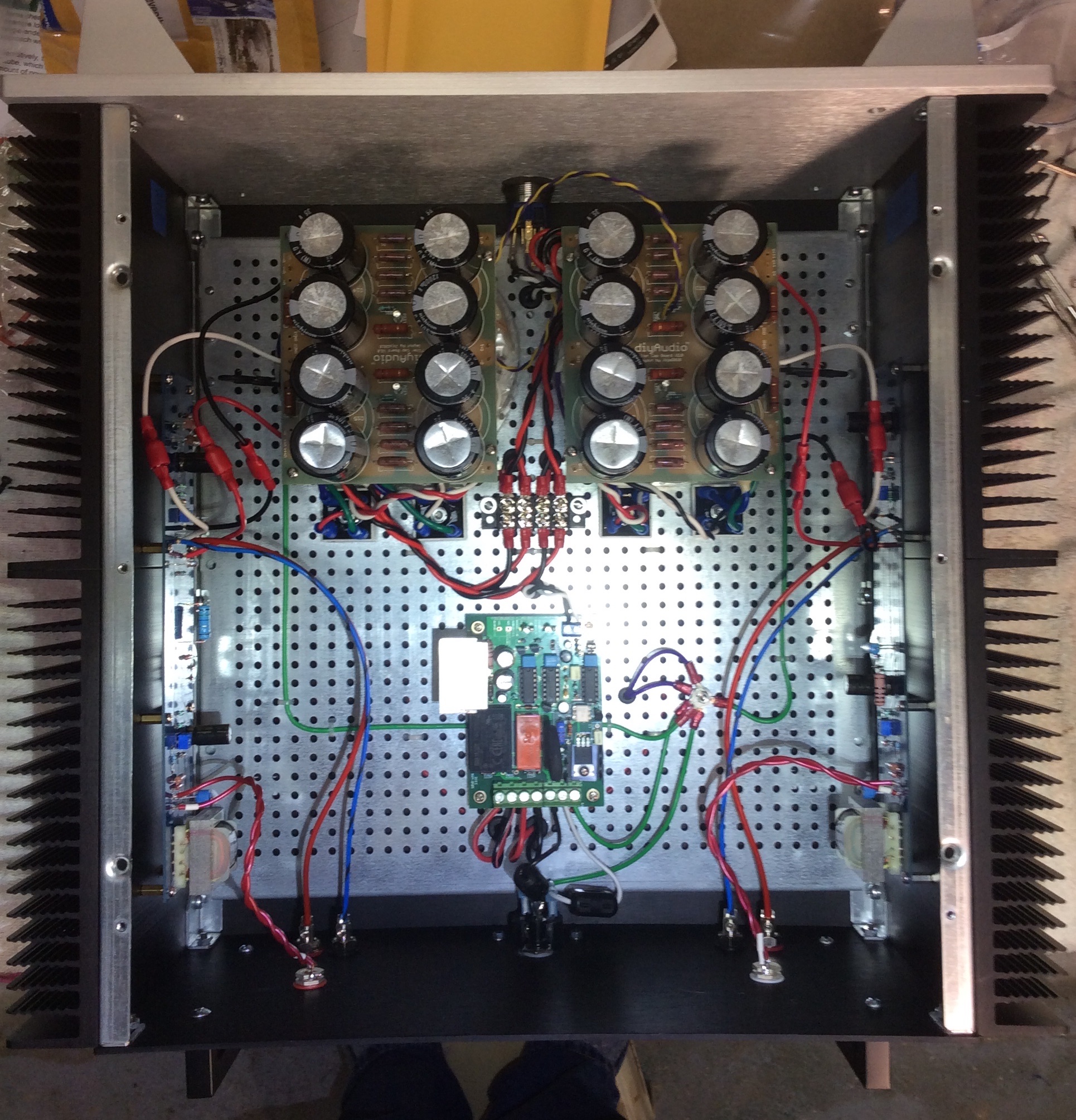

This is basically how I did mine (also dual mono). Worked out quite well.
