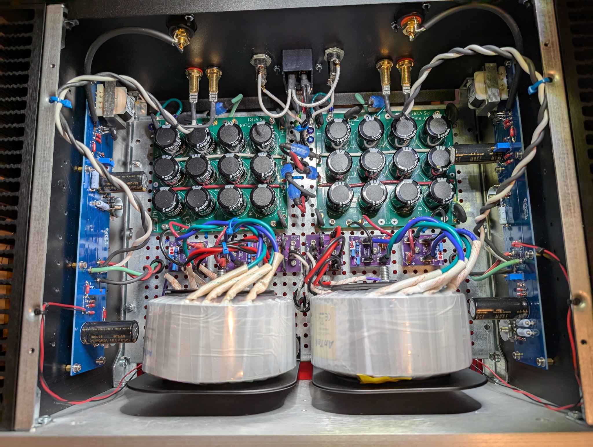

Well I got bored and converted my F6 to dual mono. My blueprint to finishing the F5m.
