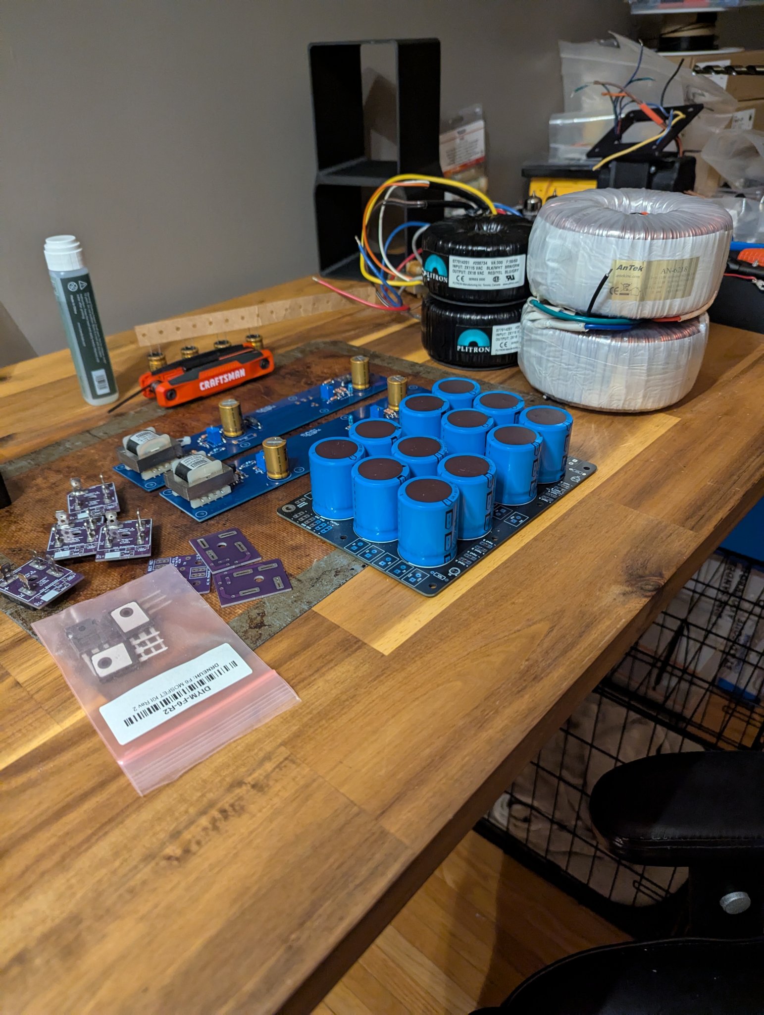

The store was out of stock for the F6 kits for a while, and we wanted to make sure that everyone that requested notification when they were back in stock had a chance to get one before they vanished. The sale site is "hidden" from anyone that does not have the link.
We have a few remaining. The link to purchase is below. We'll leave it hidden for a few days so people that frequent the site but may not have requested notification can get them before it's open for the whole internet to see. We always want members to have first access.
F6 Complete Board Kit
The only configuration offered is as a full board kit. @Nelson Pass was incredible (as always) in helping us get the parts. :worship:
The kits will have all the parts to stuff the PCBs and include:
  • F6 PCBs
  • IRFP 048 MOSFETs from Nelson Pass
  • Toshiba 2SJ74 / 2SK170 JFETs from Nelson Pass
  • Jensen JT-123-FLPCH Transformers
  • Vishay Dale and Panasonic resistors
  • Bourns Trimmers
  • Nichicon Audio Grade Caps
  • Zener diodes, and (of course) Blue LEDs
All the components in the kit were used to assemble the boards in the photo (output MOSFETs not shown).

I've pulled this project out of storage and started gathering parts for whatever's missing. I'm using a dual mono power supply and have a pair of 300VA transformers and a pair of 600VA's. I'm thinking the 600VAs would be complete overkill for this and not really gain me anything?

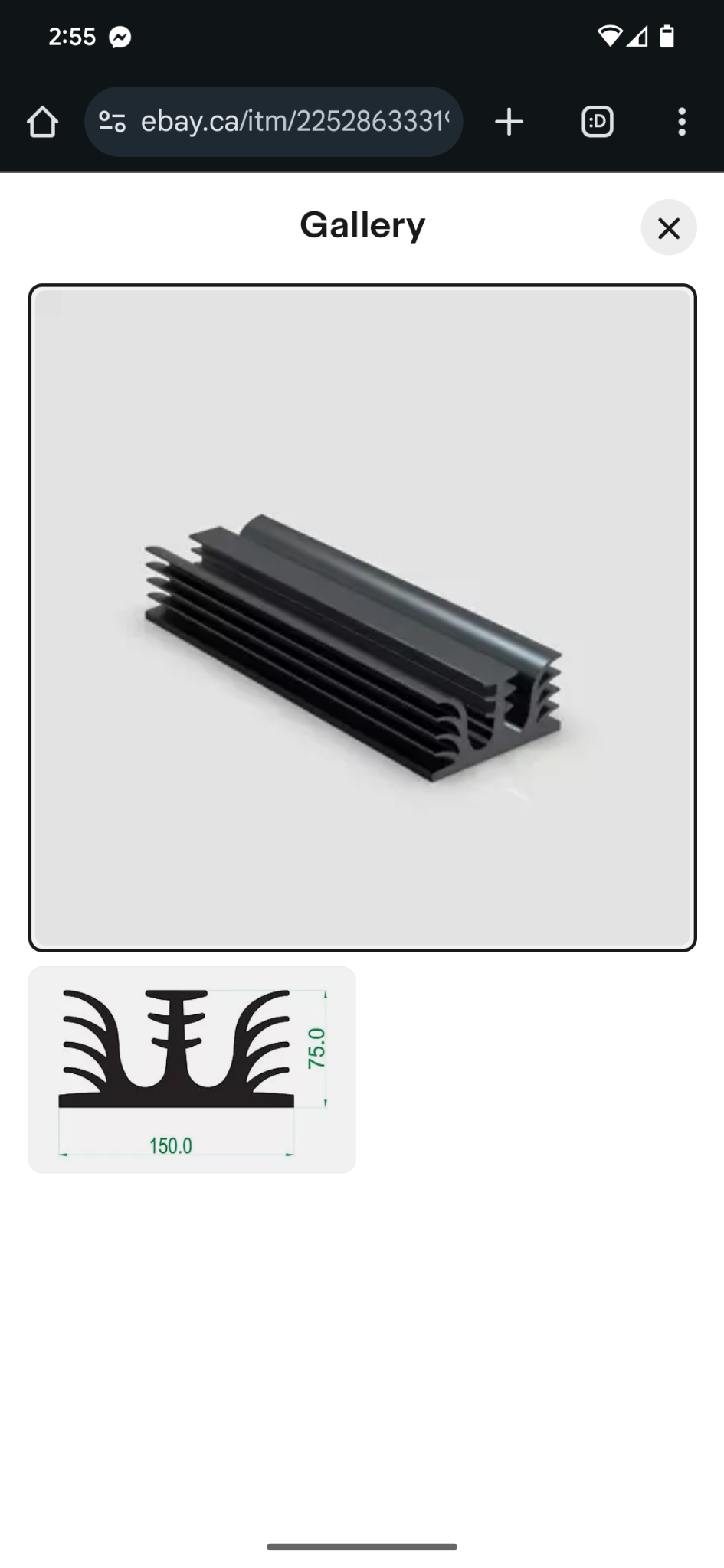

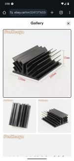

Also, where are you guys getting your large aluminum heat sinks? I'm making a custom chassis for this project.

I'll save the big toroids for another project then, the dual 300's are also a lot more friendly on space.

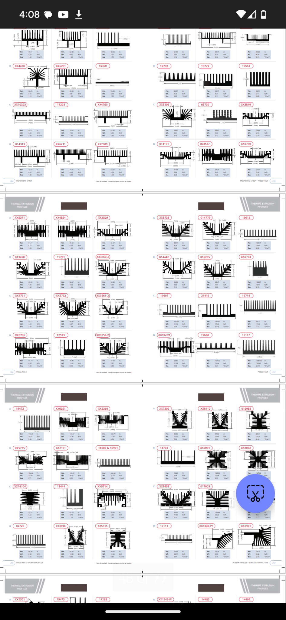

The stuff from Modushop is very nice but being in euros the parts and shipping will cost more than my entire build. I'm planning on building a kinda lookalike Krell KSA to match my existing Krell preamp.
Upon digging deeper, looks like Mouser carries a huge variety so I'll most likely go that route.

@SRMcGee thanks, I had a look at those and they have some decent but pretty expensive offerings. I actually found some pretty good looking hardware on eBay so I've reached out to the seller to see what they can do for shipping.
I really wanted some of the big chimney style heat sinks that are used on the older Krell amps but the price on those make them basically unobtainable.
