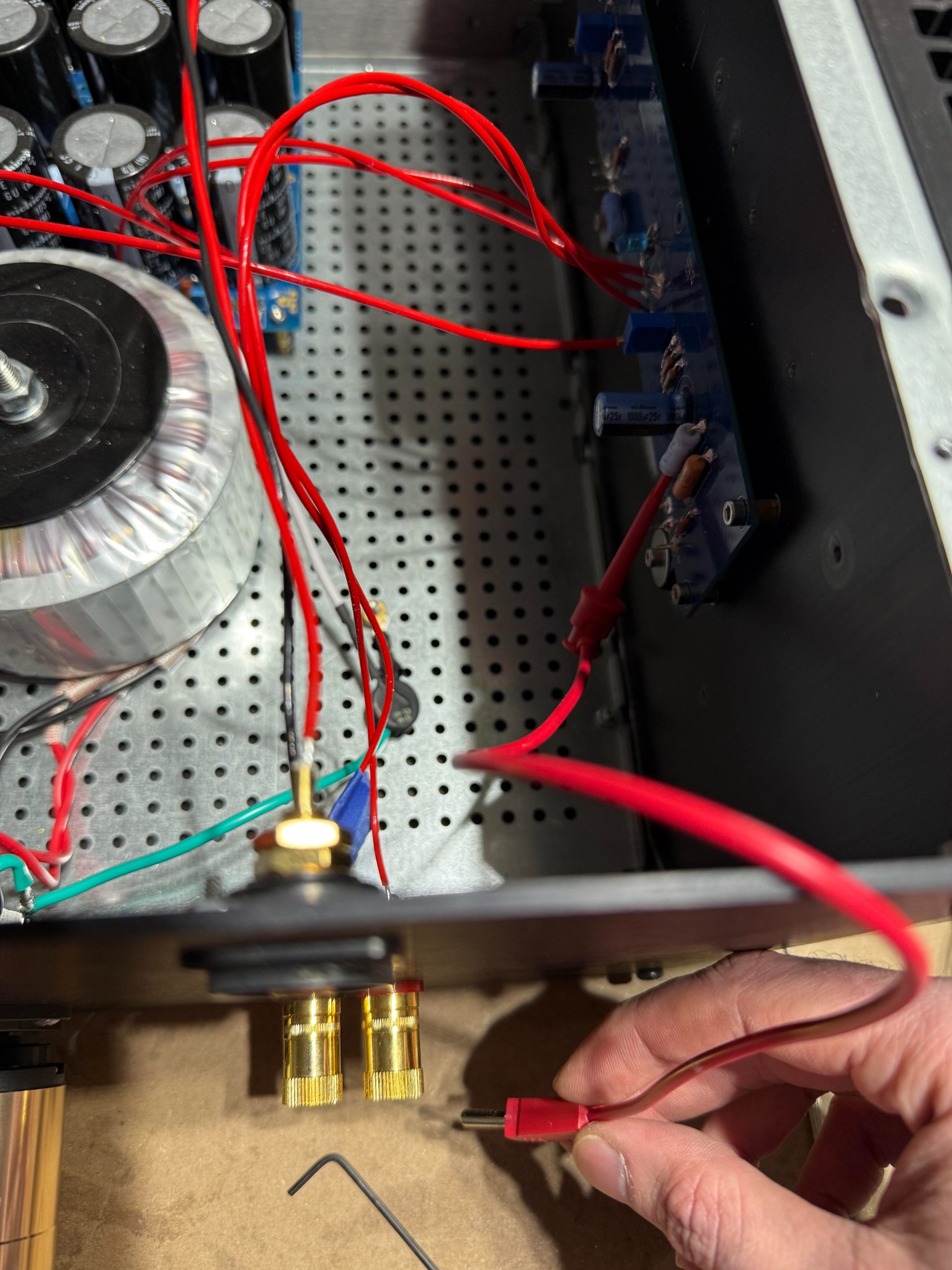

I received my F6 kit today! Unfortunately my fun didnt last long. Im afraid during biasing i dropped one of the multi-meter leads and shorted the left channel resistor to the positive binding post. (like in the picture). I had left one clip on lead on each channel to save time, HA!
Anyone have an idea what i damaged in doing this? It popped a fuse in the process and is now eating through the replacements. I tested the board components, they all seem to be ok. although i have a difficult time getting my multimeter to read the caps.
it's so easy as checking 2 JFets and 2 mosfets for shorts
if in doubt, then removing pcb from heatsink, then both JFets and both mosfets, checking for shorts outa pcb
Thank you Zen Mod. I found the JFets to be ok, im going to remove them and the mosfets for testing. I discovered my trim pots to be north of 2k. The channel in question does not show 10k when measuring across r9/r10 and p1/p2. Im going to check over the other components more carefully.

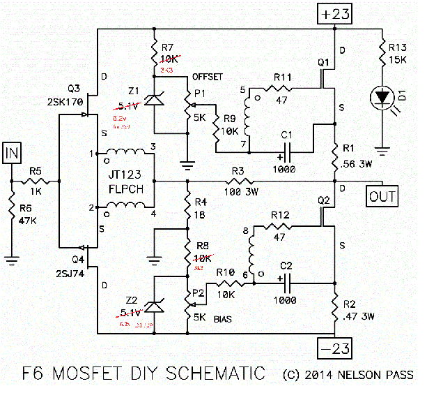

I checked the parts earlier that came with the kit. I noticed that the zener diode included is the 9.1 volts. Is it okay to use this? Can you explain the purpose of the zener diode?
The zenner mod that many people have used is detailed on post 27, page 2 of this guide by mighty Zen Mod.
This is the modified schematic.
Another well regarded modification which is much simpler to do on first build is to replace the Zenners with three green LEDs in series. with something like 3k3 resistors. This is also documented. in this thread.
"post-6849120"]https://www.diyaudio.com/community/...y-dumbest-idea-yet.348969/page-5#post-6849120[
