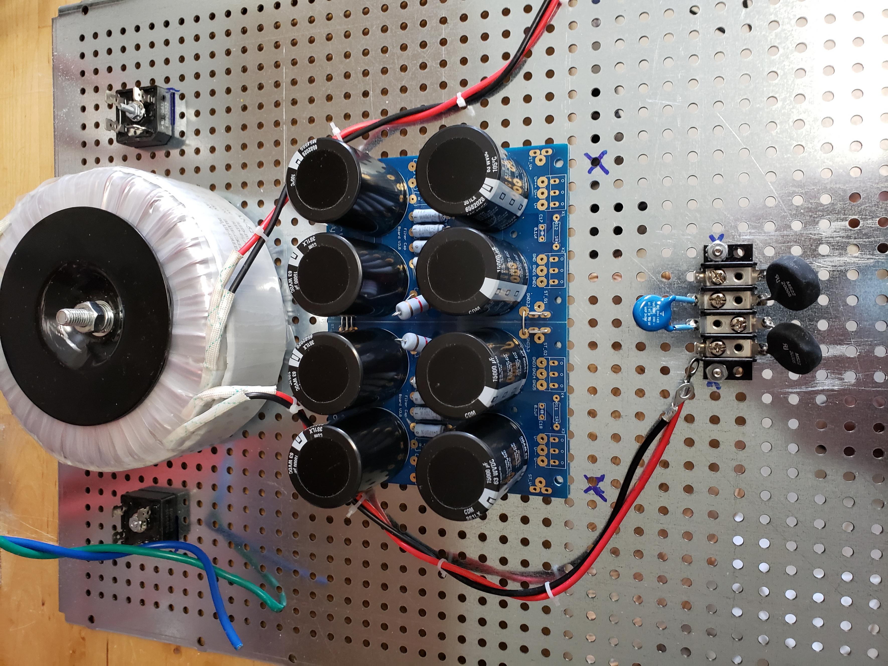

Thank you for the response to Post 3236. I received a notification and the message on gmail, but it isn't showing up here on the Forum. ItsAllinMyHead looks like the responder. Based on the advise, I plan to poke holes in the perforated panel and run the wires underneath. This project should be done soon. Regards, Bill
Hi HeyBill -
I deleted it b/c like a dodo, I realized that didn't answer the question you had asked. You were (I think) asking how to route your transformer primaries after the terminal block, and I was throwing out ideas re: how to run your AC mains wiring from the IEC to the terminal block. Oops.
Either way, I'm glad that it helped.
