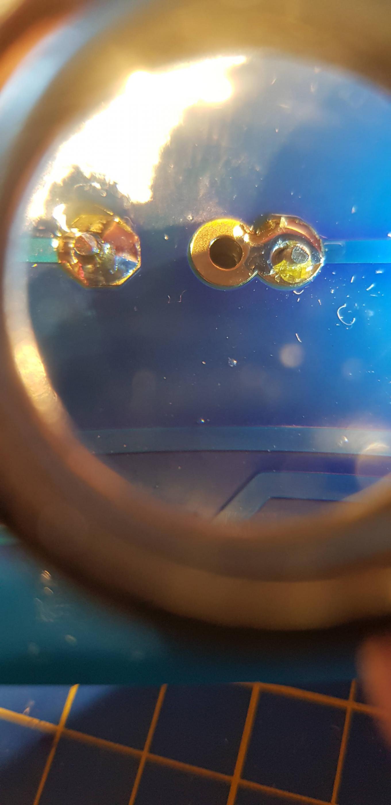

So I thought I was doing well! I’ve got the amp up and running. No smoke, pops whistles or anything. Bias and offset more or less spot on 500mv both sides. But the left channel is considerably quieter then the right! Centre voices are not all the way in the right speaker but two thirds there.
I’ve swapped interconnects and it stayed with the left speaker.. Any ideas please guys?
Thank you
Ok, so I’ve just turned the amp on this morning from cold and the imbalance has returned! Left channel output much quieter. Swapping interconnects doesn’t alter anything. Is this something to do with heat then? As it warms up, could it alter a component? I’ve ordered another 5k pot, could it be that? Looks like I’ll have to take the board out doesn’t it?
Would anyone suggest specifically what to check for please? I’m a first time builder, so direction would be much appreciated. When it worked though last night, it sounded great. I’m really impressed.
Thank you
Sorry, couldn’t resist, told you I was consumed. This is a photo of the pins of the capacitor nearest the offset pot. One of the solder joints is pretty bad.. this was the first ever pcb I’ve populated (in my poor defence!). Is this the likely source do you think, anyone?
Please, no abuse over my soldering.. 😉
thank you
