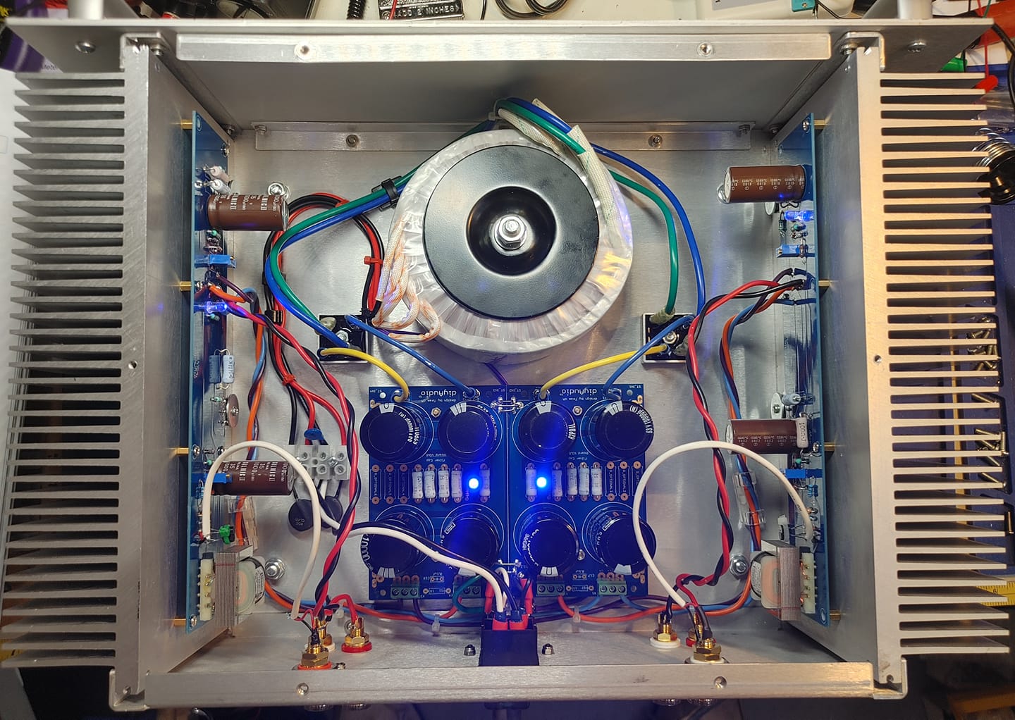

Completed my F6 build today. Got caught on the LED polarity being different on the two boards and also had to follow the change of R7 & R8 to 3.3K and use 6.8 volt zeners. One channel seems more stable on bias than the other, even after an hour so will monitor it. Chassis is one I bought over 10 years ago, EBay I think.
I have the same match up. They do sound good together. I just finished building the Pearl 2. And she sings beautifully with B1 and F6.Using B1 Korg NuTube preamp which does mate very well with it.
