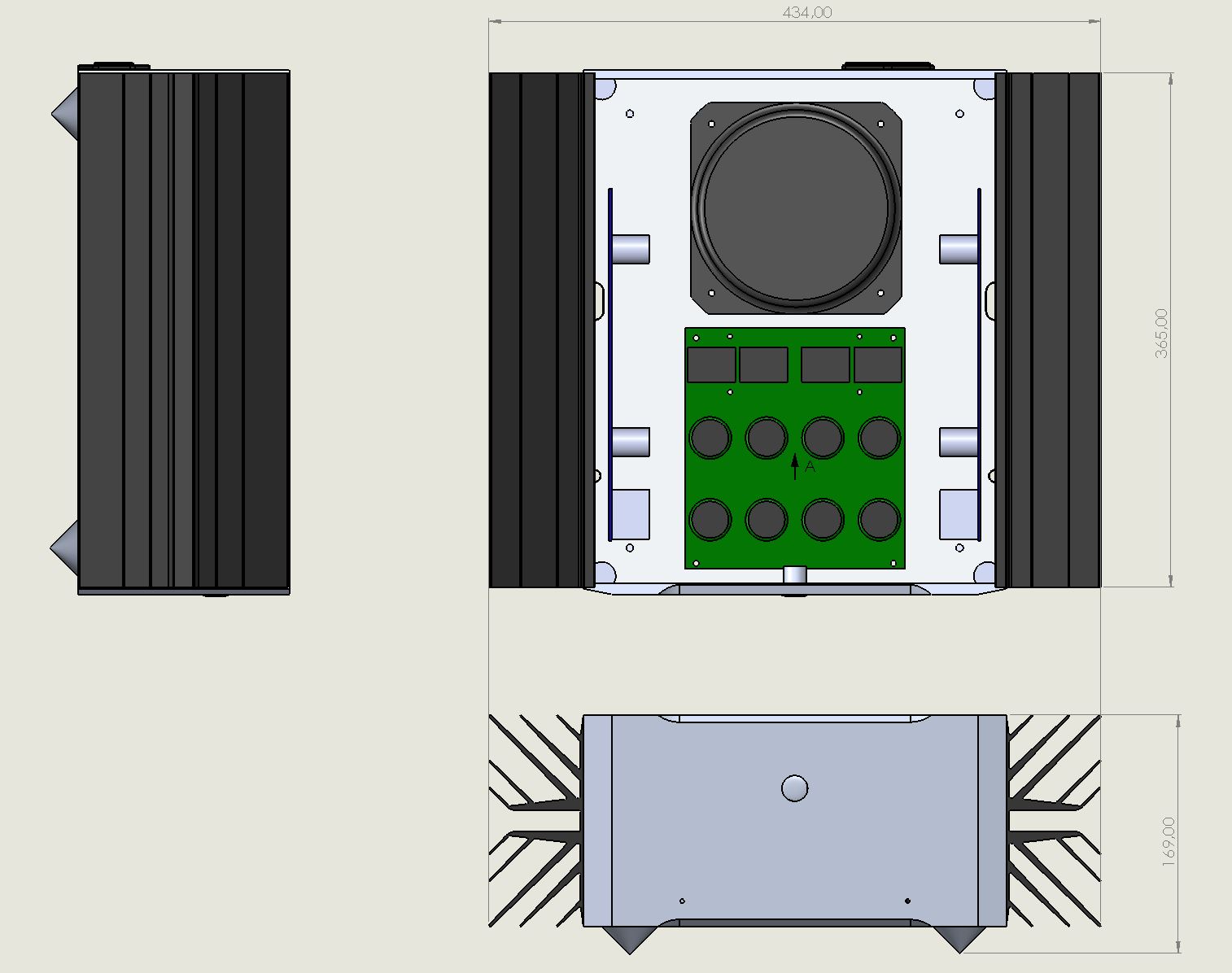

Back to share my achievement with you, I had 2 projects at the same time (Headphone amp Noir) and the F6.
The chassis was entirely made of 5 and 6mm aluminum, the heatsinks come from China (not found better in Europe).
The amp works wonderfully, it is as silent as a grave, no "plop" when starting or switching off, no volume noise at full blast without a source, impressive.
Sound side, it is balanced, beautiful deep bass, in the meantime I received a pair of Focal Chora 826, the marriage is magnificent.
A big thank you to Mr Pass for his sharing and his know-how, and to the forum for your help particularly to "2 Picodumbs"

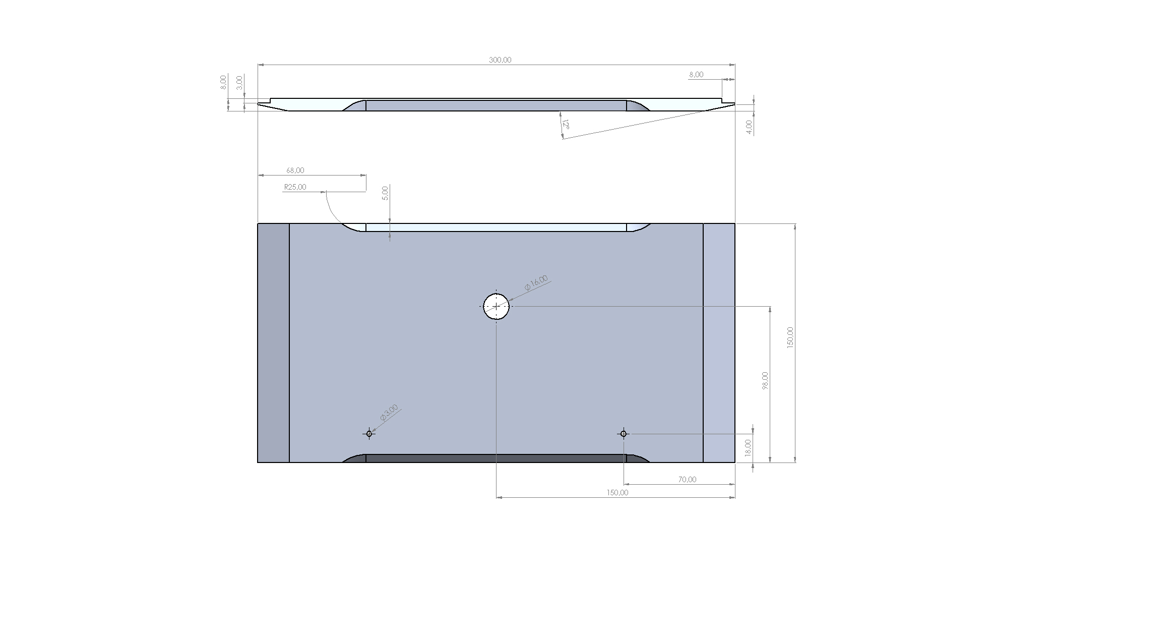

Hello,
Thank you for your feedback, concerning the case it is 100% made in home, so I am attaching the machining plans to you.
For heatsink, search for "BRZHIFI PASS dedicated heatsink" you will find them quickly.

Yes, some nicely finished cases but the freight … It's starting to be cheaper, quicker and better to get the parts made locally again or from somewhere else.
And I don't like how they're offering factory built copies of the Pass designs either, with the usual question about parts quality. Buying from China has certainly lost it's attraction these days
For my part, I paid them $ 172, as much postage as the price of the material, the delivery was fast (10 days).
In Europe I couldn't find a model with this design, but the equivalent cost me $ 300, so the choice was quick.
On the efficiency side, no worries on my side, they are not used optimally (horizontally), and I have not placed the MOSFETS at the bottom (my bad).
