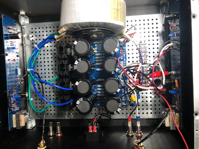

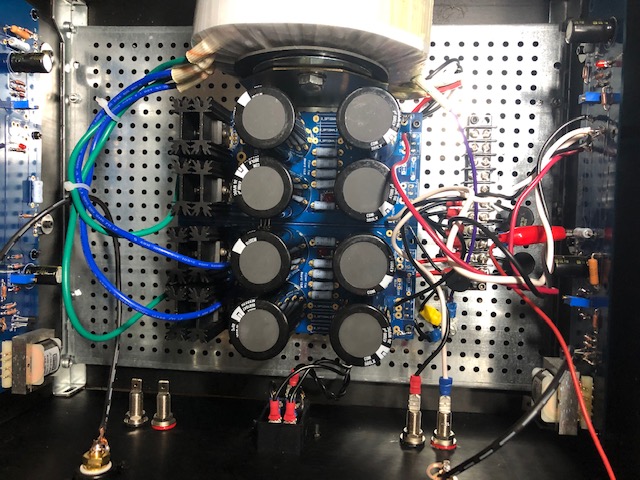

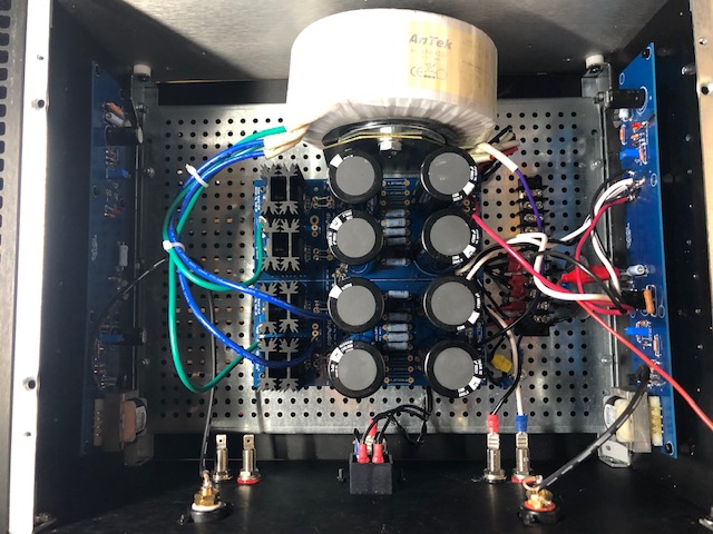

I posted earlier that when I fired up my F6 - One channel Only smoke came out and I thought it was toast - - I poked around and things seemed OK - so I tried again without replacing anything - my light bulb dimmed and came up but no smoke and the LED didn't light up - I thought I needed to switch the led around so I did- fired it up again and it lit up - I checked the bias and it slowly rose to about 0.420 before any adjustment -- I think I might be up --
What next? -- Do I connect a speaker? - an old one I suppose - Are there other tests or measurements I should do to make sure I'm ok
nope; stop whatever you're doing and post pictures
well lit, detailed, so we can deduce how you made it

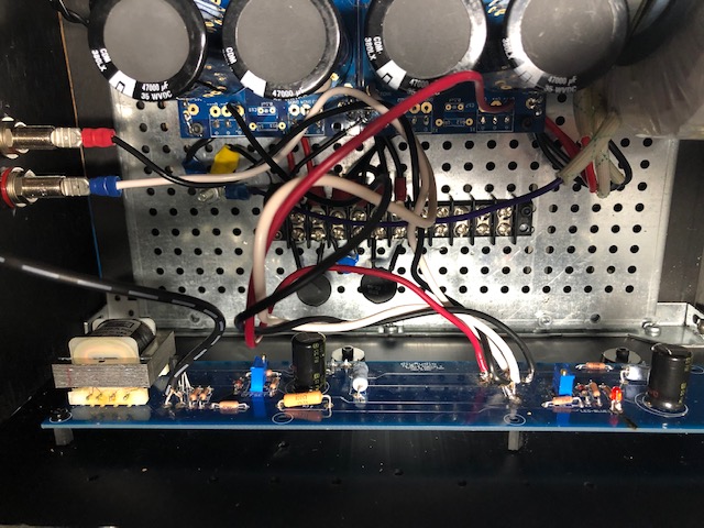

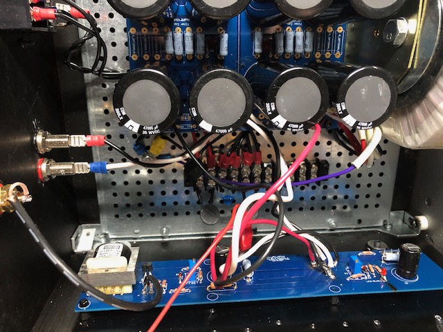

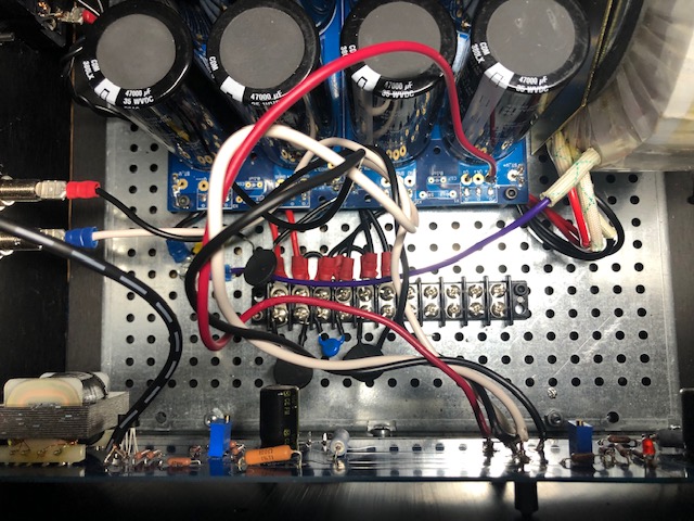

tbrooke,
If you can, flip the amp on it’s side and take some nice closeup shots of the actual F6 amp boards. It’s a little difficult to elucidate anything with the bundle of wires on one side of the amp.
Make sure the center bolt of the toroid is not touching the front panel. You don’t want a shorted turn situation.
Have you tested the power supply separately ? Even with 20V secondaries you should be getting +/- 28V or so without a heavy load.
