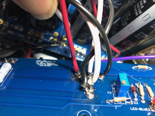

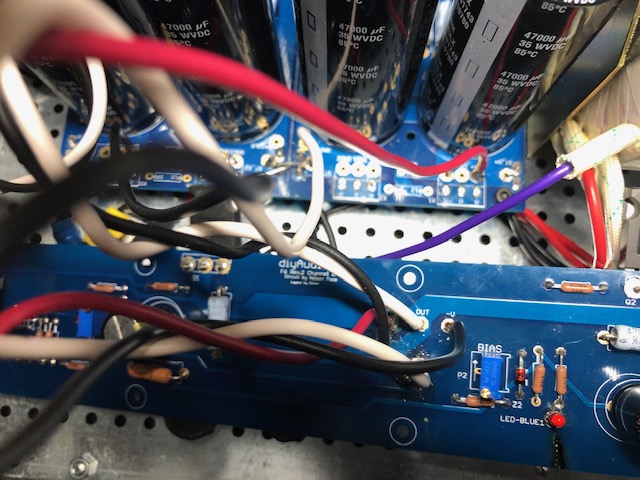

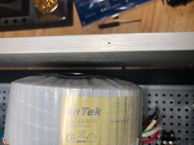

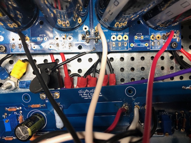

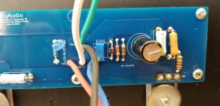

I took the board out and tried to lay it on its side beside the power supply to show better - the other channel isn't wired yet.
With the black and white wires the white wire connected to out goes to the speaker output and the black wire that is a double connected with a white wire a little higher up is also connected to the other speaker out - which I am thinking doesn't seem right - that is putting 14 volts straight into the terminal.

OK I started with DC Offset that I determined was to connect the multimeter to the outputs - from what I read it should be zero - I got 14 volts -- I don't think that is good.
My power supply is about 14volts - So I am thinking a short

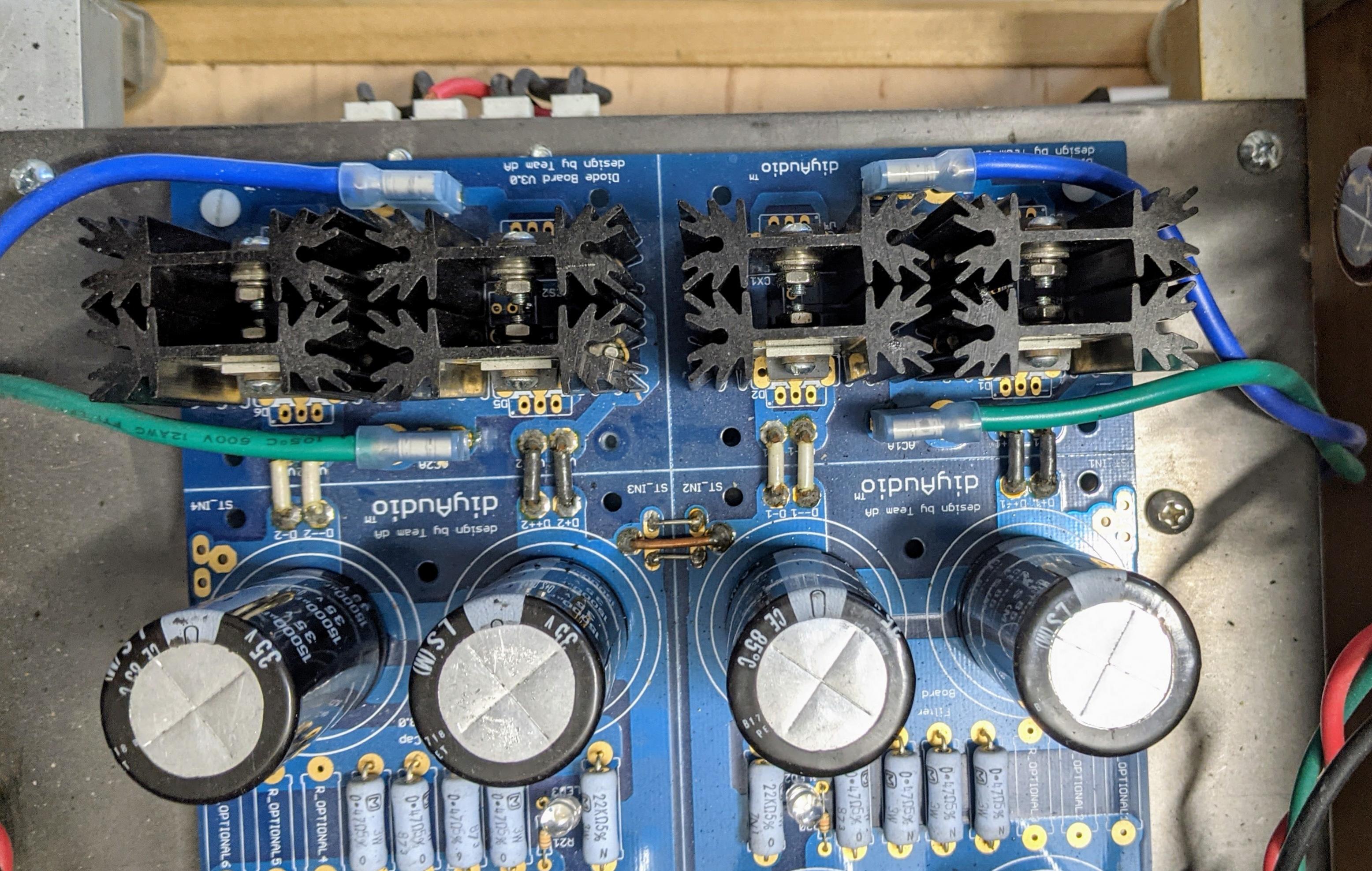

I agree with twitchie.
See this link and scroll down to 6L6's picture where he has the transformer secondaries connected to the monolithic bridge rectifiers:
diyAudio Power Supply Circuit Board v3 illustrated build guide
Also, look at the Antek AS-3220 diagram on this link (it's similar to your AS-4220 from a wire connection standpoint):
AS-3220 - 300VA 20V Transformer - AnTek Products Corp
https://www.antekinc.com/content/AS-3220.pdf
Notice that with Antek dual secondaries, that a green wire is contiguous/continuous with a blue wire. You need to pull out your DMM and make sure you know which green has continuity with which blue wire. The resistance between one green and one blue wire will be close to zero ohm. Make sure you keep those two together (and twist them well to minimize stray magnetic fields). The resistance between another green and another blue wire will be close to zero ohm. Make sure you keep that pair together. Each pair then connects to their respective AC inputs on the rectifier board.
Other transformer manufacturers, for example Plitron as 6L6 used in his build (link above) have different colors for all 4 secondaries so it is difficult to connect them in a short circuit.
I am a little concerned that you may have done so.
You also seem to have (2) blue and (1) green wire connected to one board while you have only (1) green wire connected on the other board. That is wrong.
Best,
Anand.
Thanks, that picture totally clarifies it - I was totally screwed up but somehow I measeured it and 14 volts was coming out of the power supply - I think I'll go back hook it up right dosconnect the board I had connected measure the power supply then reconnect and see what happens.

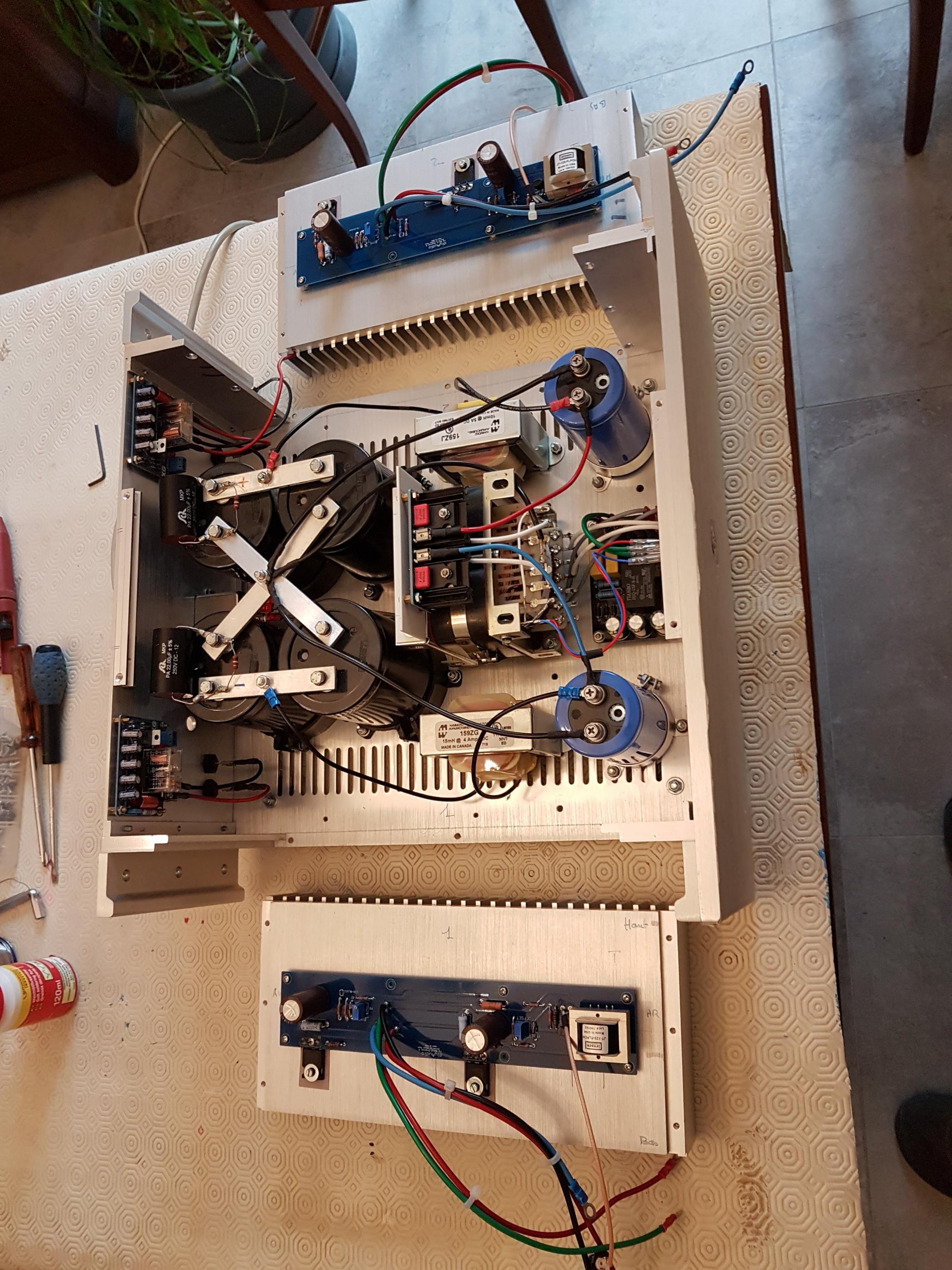

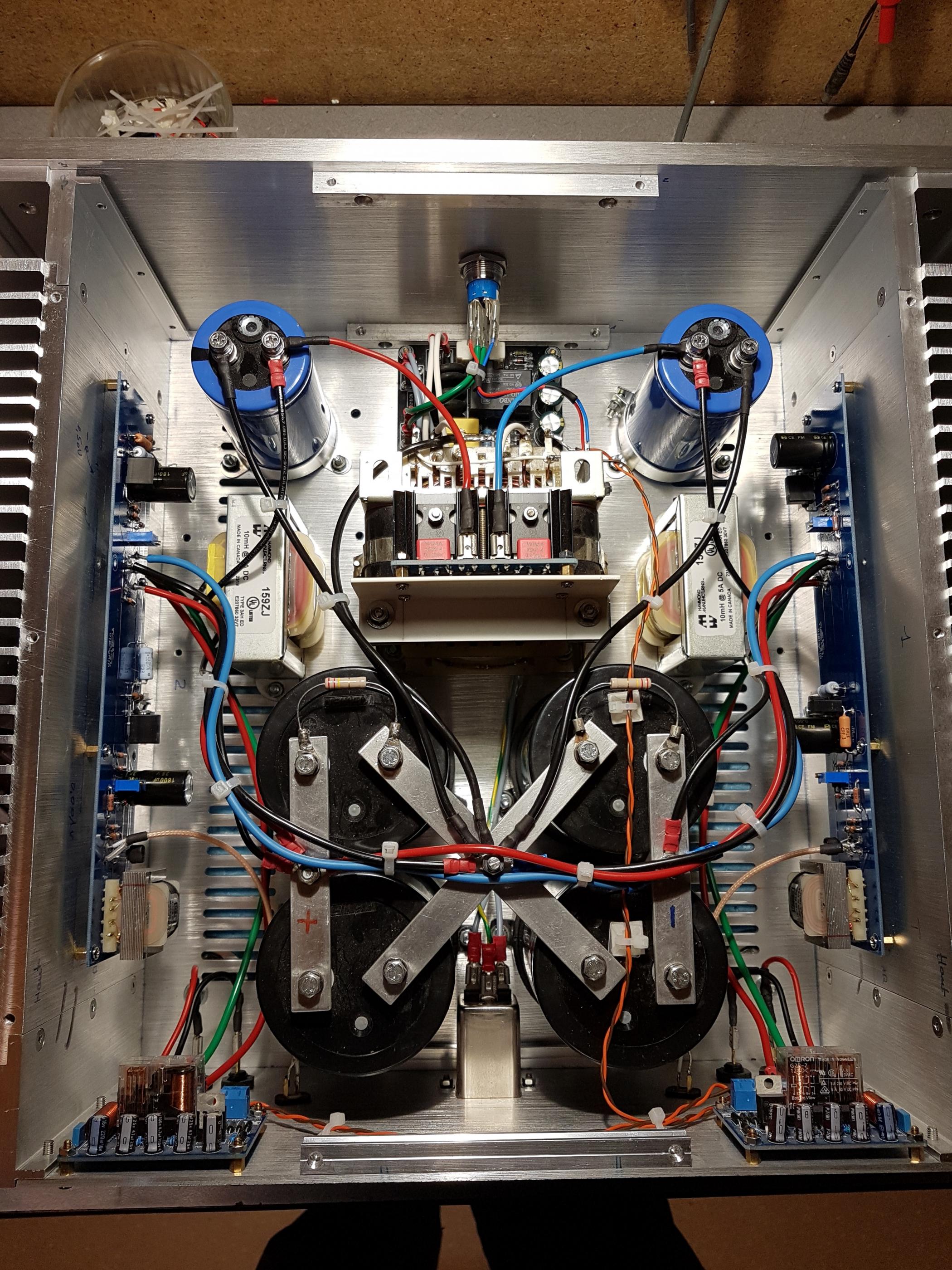

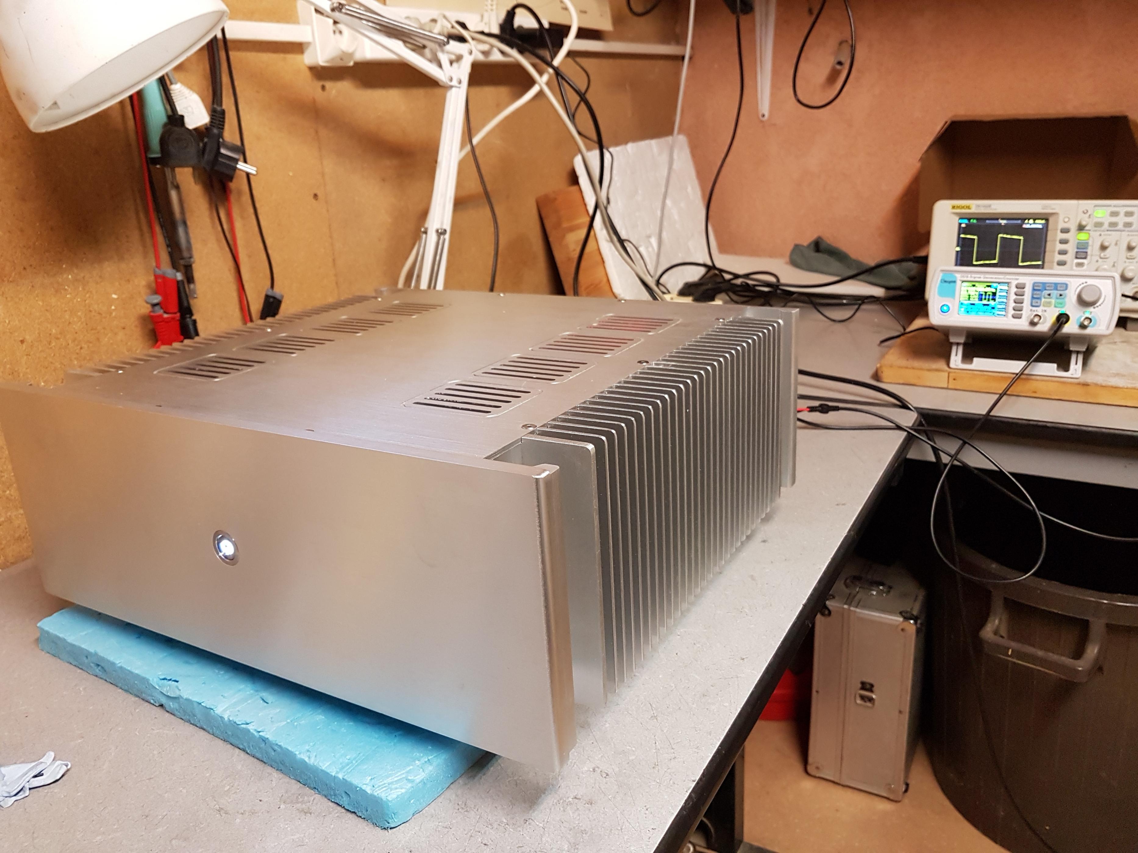

Some news about an other Nelson Pass F6 whitch raised to life few month ago, but started beginning 2020.
It's the first solid state amplifier I made, more trained to build valve amplifier like ARC D79, PP Ampex 60W, PP GEC KT88, 2A3 and 2A3JJ40 mono triode etc...
Power supply and filtering was planed for an Hiraga 30w classe A. On the way I changed my mind and I switch from Hiraga amplifier to the Nelson Pass but I kept the PS.
The transformer is a double C comming from Dissident Audio, the DB226 2x18V 6A.
The filtering is CLC type with hammond choke and a total of 1.2 Farad (2x600.000uf).
I add several modules bought on the net, a soft start module and 2 HP protection module.
I set the bias after one hour running at 0.604v and the ofset at 0.002v.
Amplifier cold, the bias after 2 minutes is 0.540v it goes very slowly to the set value.
The gain factor is between 5 and 6, depending input value:input (BF gene) -->Output (vpp on scope)-->x ampl factor
0.28v--> 1.60vpp-->x5.59
2.84v--> 15.9vpp-->x5.59
5.65v--> 30.2vpp-->x5.54
Clipping on sinus wave at input 7.65v-->42.4vpp on the scope and 14.51vac on 8 ohms load.
Of course I prefer my valves amplifiers, but honestly I must recognize its a fine and energised amplifier plus easy to build.
Many thanks to 6L6 for it's advices and also many others...

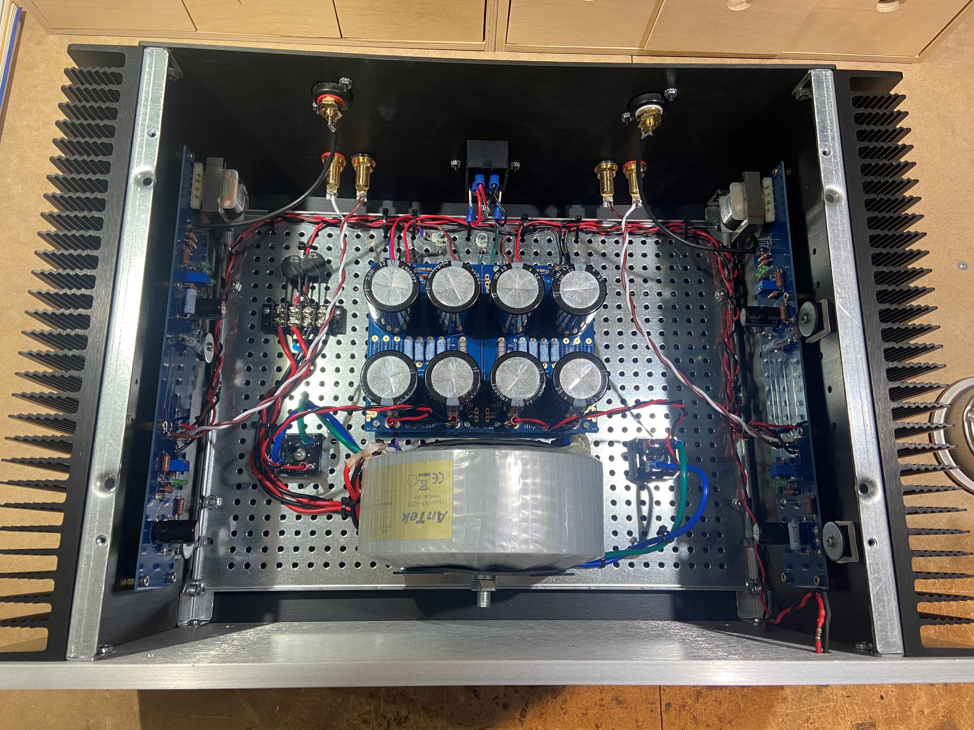

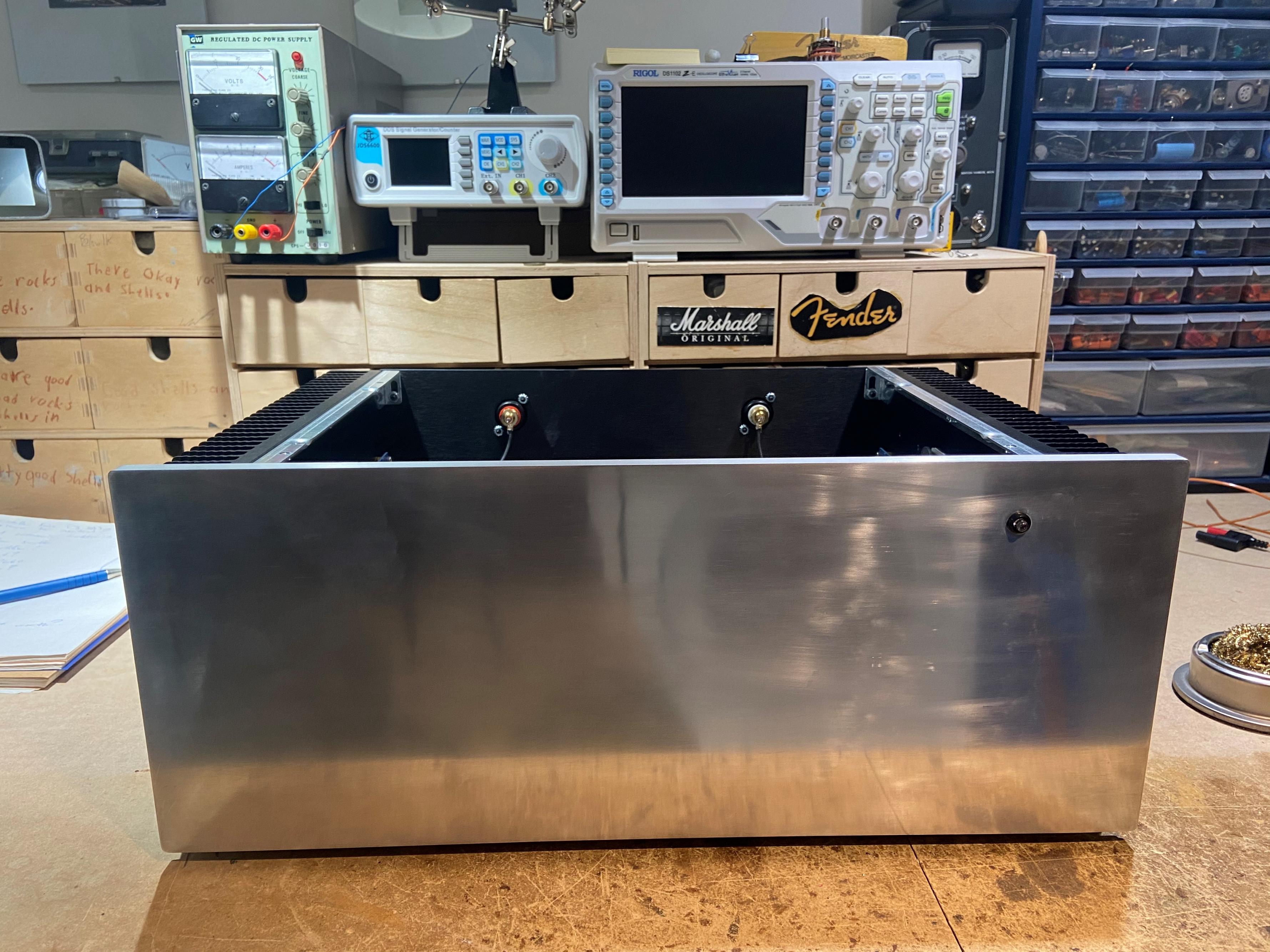

Hey I also finished my F6 build!
Bit more of a standard F6 build using many of the parts from the site's store.
17 LEDs in this amp! Replaced each Zener with three green LEDs (LTL 4231N) fed by a 3K3 resistor.
22KuF caps in the PSU. Added a 0.1uF ceramic on the output of each rail. Antek 400VA transformer.
Bias is holding steady at 0.5V +/- 5% with the offset <20mV. This is with about 10 hours of burn in time. Going to enjoy the amp the next week then pull open the hood and check measurements again.
Very impressed with the floor noise on this design, hardly any noise at all!

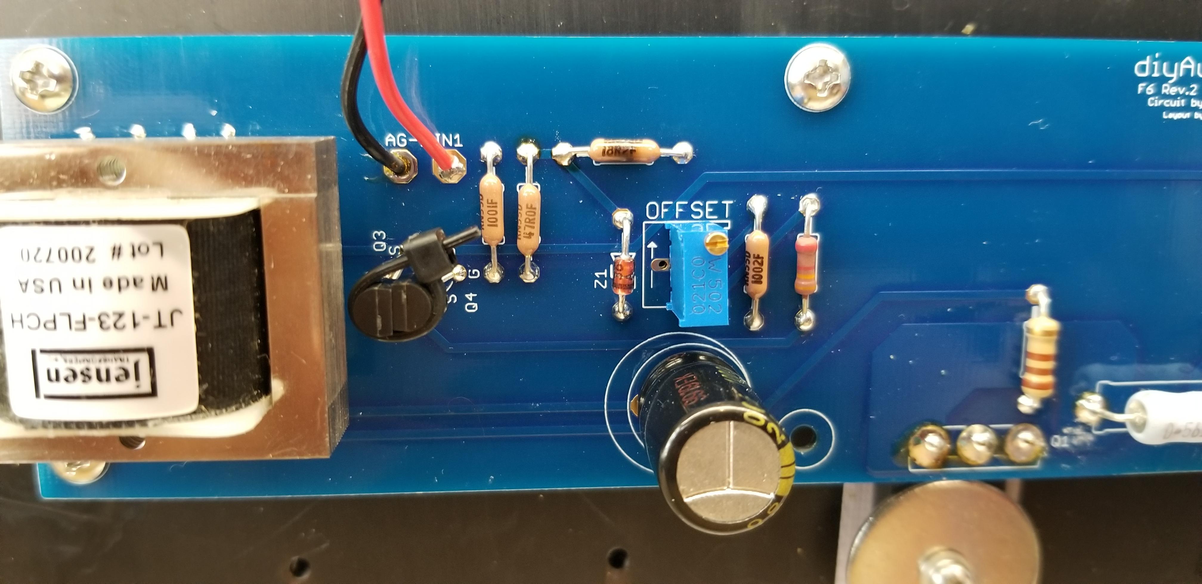

Problem on R4
Hello,
Need a little help. I tested my PSU with the dim bulb.
PSU shows +25.15/-25.1 with a Antek 32-18
I then tested channel B with dim bulb. Passed.
I was starting to adjust the bias with the dim bulb still in place.
And I fried R4. I used a Dale 18 ohm resistor [RN55D 202IJ 18R2F] from the F6 parts kit.
I had checked and have now rechecked continuity at the Mosfets. All good.
I used the 6.8V Zeners and 3.3K resistors.
I had positioned the pots in the middle of their range.
Nothing else looks fried.
I triple checked Q3 and Q4.
Wires: red to V+, blue to V-, black to ground. White is out and green is out ground.
Led works [yeah].
Any help is appreciated.
