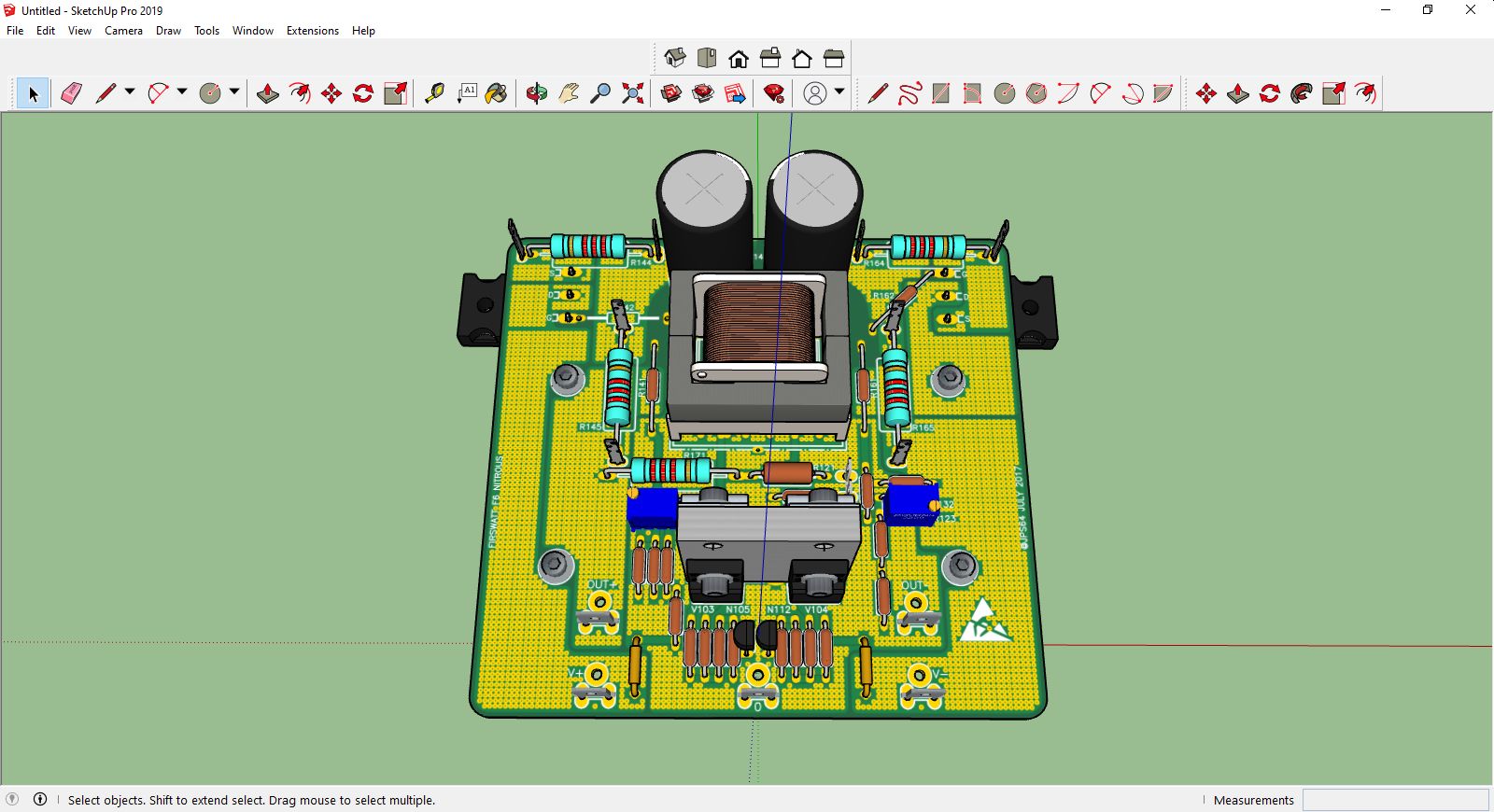

F6 Illustrated Build Guide
F6 NITROUS
JP
  • F6-NITROUS_SCH.pdf
    F6-NITROUS_SCH.pdf
  • F6-NITROUS_PBA-TOP.pdf

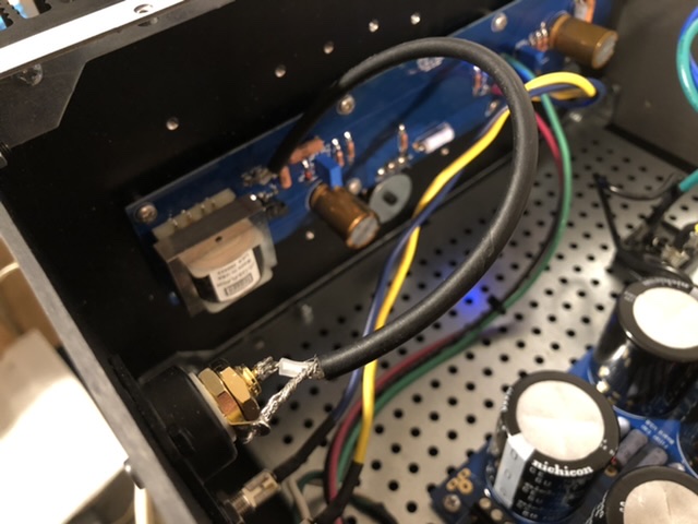

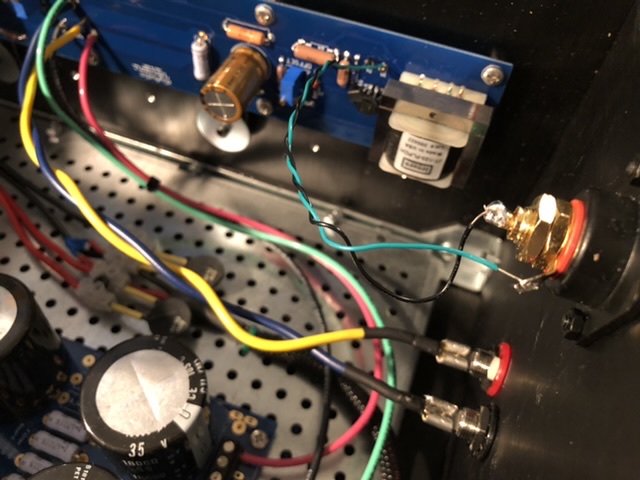

Okay, here the update on my hunt for what’s caus8ng transformer hum through both speakers...
-Turning the transformer didn’t work.
-I unbolted the transformer and moved it away from the chassis and that didn’t work.
-I replaced the fine wire I twisted up for the inputs with shielded wire and that didn’t work.
-Waving my hand around various components doesn’t change the hum.
-Tapping components with a screw driver doesn’t change the hum.
-Holding a piece of steel between the input transformers and the toroidal power transformer didn’t get rid of the hum or do anything to change it.
-Grounding the purple wire on the transformer didn’t change anything.
If I put my ear to the toroidal I hear if humming and it vibrates a little. Is that normal.
What’s left to try?

Your AC in is very close to your left channel. Try routing the AC right down the middle of the chassis, and locate your connection block between the PS board and transformer.
Also it is difficult to see whether you have a ground lift CL60 between PS ground and chassis ground.
Another thing that I just noticed - the power transformer purple shield wire is not connected to chassis ground.

I would double-check your connections on the terminal strip. I’ve had a loose wire / bad connector post cause problems like you’re describing.
That may be it. Looking at the post 2498, the picture you've uploaded yesterday, it looks like you've connected the ground wire straight to the chassis. If so, you need to connect the ground wire to the chassis through a CL60.

- Well, the hum is even in both channels. Although the AC in does run down the left side, it’s really not close to the board. I did try moving the wires and that didn’t make a difference.
-The CL60 ground lift is there.
-I wasn’t sure if the purple shield needed to be grounded or not. However, I get the hum in both channels whether purple goes to ground or not.
