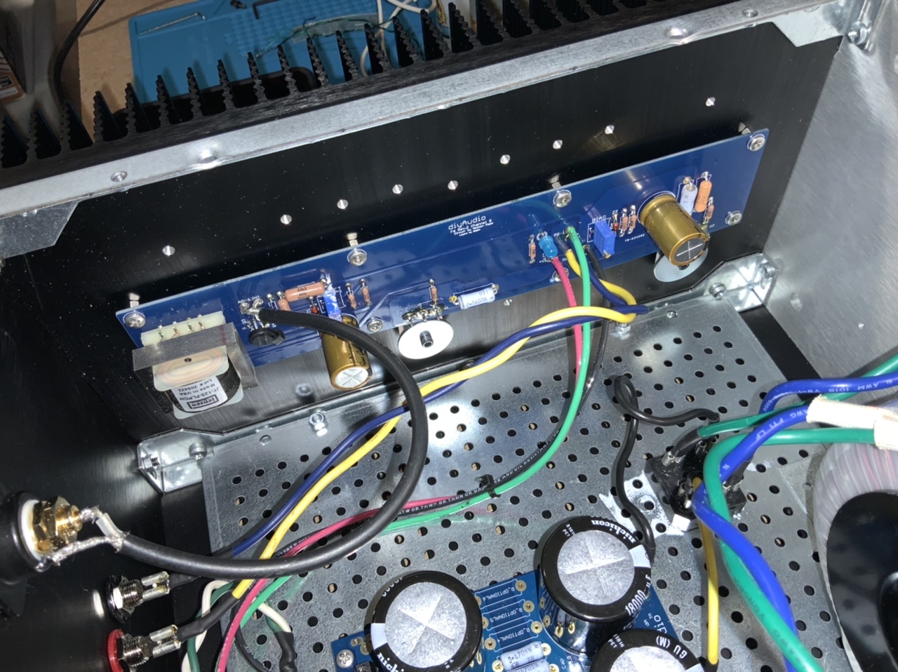

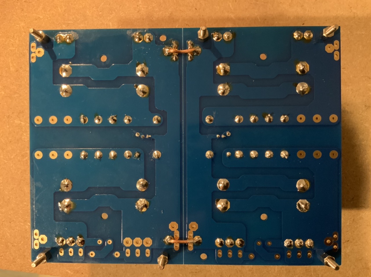

You mentioned the ground link on the PCB is solid wire, (just that one is sufficient, assuming it's soldered properly...) but is it touching the chassis floor by chance?
You might want to add a couple links on the top to be totally sure, the ground plane is difficult to solder as it takes forever to heat up.
What insulators are you using on your Mosfets?
Can you take some more photos? Well-lit and in-focus, as always. 😀

As '6L6' mentioned above, it seems you have a ground problem and/or as "the hum turns into a loud buzz at the speakers when I short the inputs..." - maybe there's a problem with the input jfets, resistors or the signal transformer even though the bias and offsets are saying the amp is functioning quite well - I doubt that the extra volts on the transformer secondaries will be problematic
I hope it’s not the jets! Yeah, I’m not thinking voltage is the issue, but if the transformer is faulty (it does vibrate when it’s on) than ordering an 18v version to replace it made sense to me.
It's quite probably something simple that's just been overlooked and it needs perseverance (and patience) to find it - I once had an isolated diode pin through loss of the via on the pcb after changing them - much agro, that one!

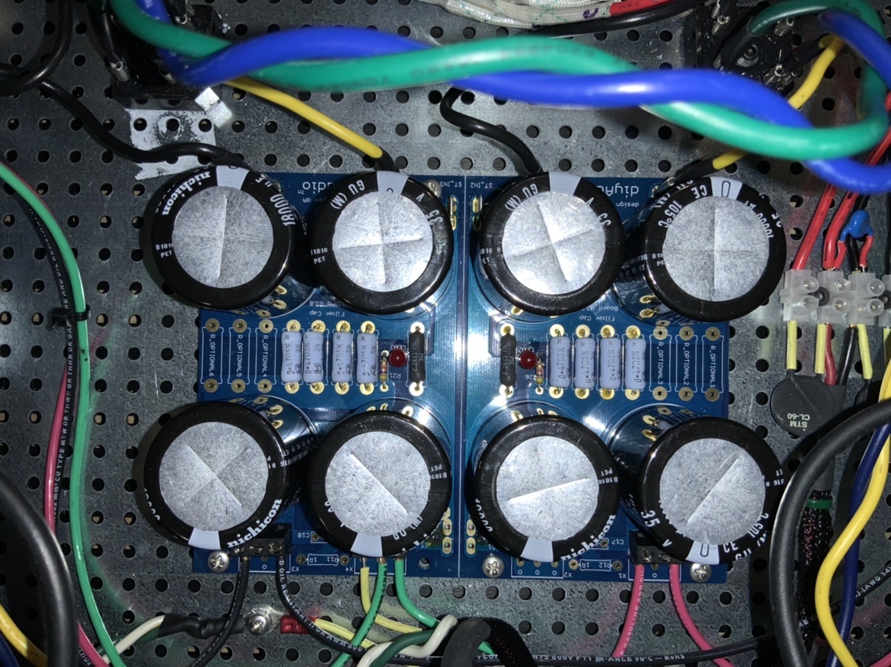

Oh, something you might look at later - maybe try replacing the standard 'block GB bridges' for the Shindengen Schottky bridges, if you can find them - they seem to go well with the Nichicon power supply caps and makes quite a difference to the sound of the amp
Do you have a part number for those or a thread link for implementing them?

You mentioned the ground link on the PCB is solid wire, (just that one is sufficient, assuming it's soldered properly...) but is it touching the chassis floor by chance? You might want to add a couple links on the top to be totally sure, the ground plane is difficult to solder as it takes forever to heat up.
The wire is clear of the chassis floor. I was thinking I should add more links. I soldered connector terminals on the ST_IN2 and ST_IN3 side when I bridged that side. I wonder if those are acting like antennas. I’m removing them now.
I’m using these thermal interfaces from Mouser. One layer under each mosfet and they are a little larger than the mosfet on all sides, so the mosftes fit completely on top of them.

It's a long shot, but it couldn't hurt to see if any of your input wires may be touching the heatsink. I didn't clip the lead properly on the backside of the amp board in one of my builds, and it was making contact. Gave me fits until I found it.
Edited to add - are your inputs wired in reverse on at least one channel? Right side, but white input jack. Looks like the jacketed wire is running to pos input on the back panel, but to gnd on the board? Can't tell perfectly from the pic, and I'm doing it off memory from the boards. Just give it a look see. (Ingore that... I zoomed in on the pic)...

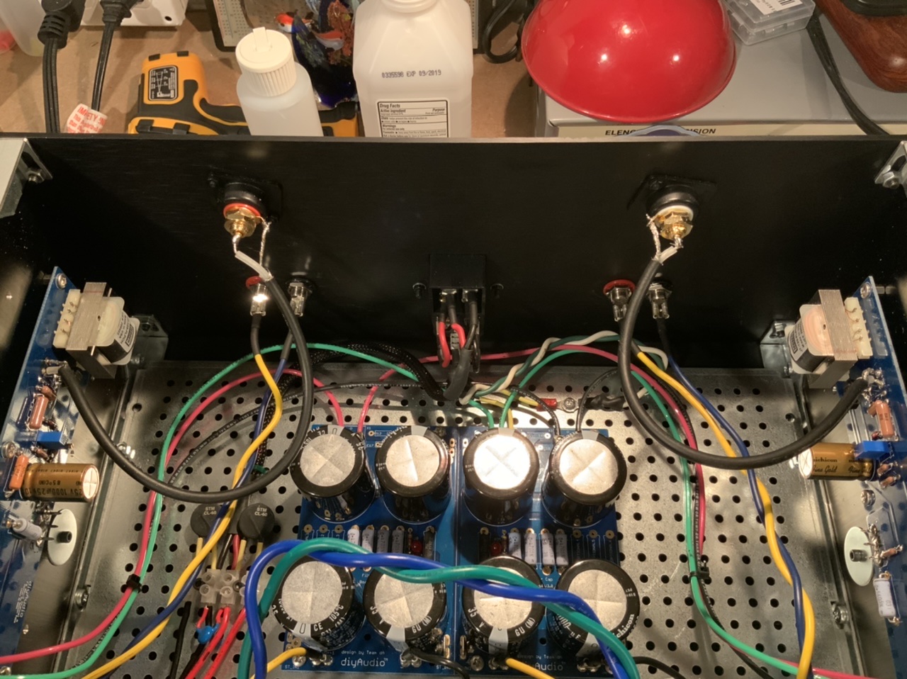

Haven't read everything.
Have you tried putting all your ground wires into the same screw down terminal?
How about trying a single monoblock configuration and see if you can get one channel operating without hum on the output.
It's always a good idea to solder ground wires to the boards, do that also.

I checked the input wires again and they’re on the right way. I have also checked clearances under the boards and nothing is close to touching the heatsinks. In fact I did that check before I turned the amp on for the first time.

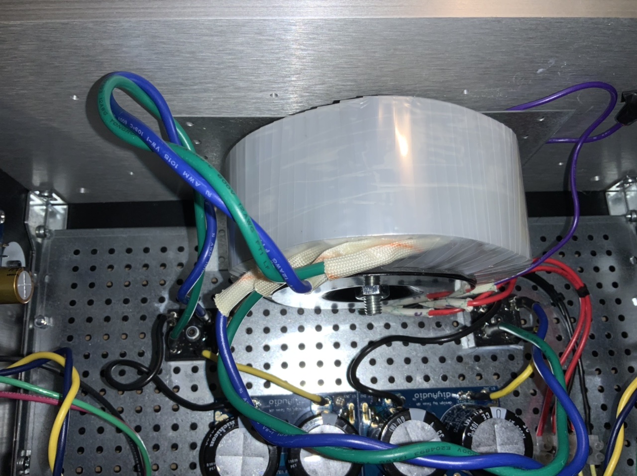

I have another transformer with a steel cover coming tomorrow. If replacing the transformer and shielding it from the rest of the amp behind steel doesn’t eliminate the hum, I’m going to pull all the boards out to go through every component, solder joint and connection.
Shielding can help a lot. Consider mu metal shielding of the input transformers on the board.

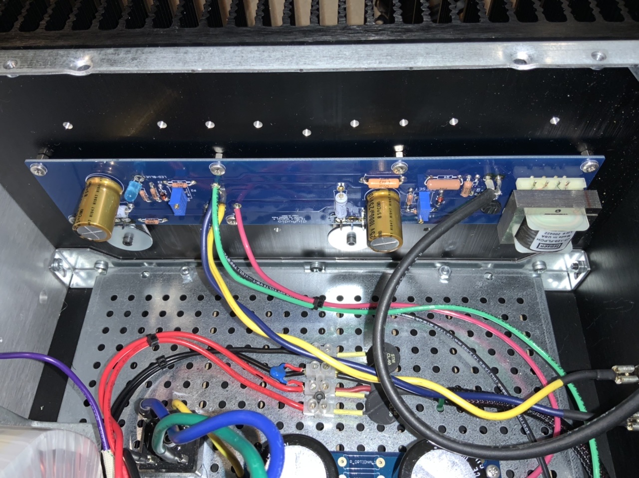

I would also look to further separate the input, and output wires from all the AC lines. One of your output wires looks to be draped on the terminal block. That could be a perspective issue with the photo though.
Consider twisting all your AC wires, in +/- pairs. The wires from terminal blocks to power transformer are all untwisted, asking for hum.
Also, be aware that the CL-60s get HOT, best not let them be touching any other wires.

If the new transformer doesn't fix the problem, then please solder all ground conections.
You want the impedance to be as low as possible even if it weren't a problem now, as oxides form the contact resistance will continue to rise to the point of having a very noisy ground connection.
Soldering will eliminate this problem as the joint interface is completely encapsulated.

If the new transformer doesn't fix it and you can't find a dc blocker build this.
Changing the transformer didn't solve the problem - I still have the buzzing/humming noise in my speakers.
I found another issue and fixed it too, but this didn't solve the buzzing/humming noise either. I found that R9 and R10 in the PSU were 2.2K wirewound 3W resistors so I swapped them out for 22K metal film 3W resistors, but as I said the buzzing/humming is still there I was so hopeful with this change! Oh well...
Thanks for the DC filter schematic. I am reading about it on the ESP website. All they really say about this circuit is that it may prevent a large, 500va or bigger transformer itself from "growling". Unless I missed this (and that is possible) the article doesn't really indicate that the DC offset issue they describe causes a problem in the transformer output, or that the circuit shown will mitigate issues with buzzing or humming in an audio circuit being driving by the PSU a transformer is attached to.
Note that I have adjusted DC Offset at the speaker connectors to effectively zero. Please help me understand then why DC offset in the mains would show up in my speakers.

If the magnetic flux becomes saturated because of DC, it will cause a whole host of problems.
If the new transformer is also buzzing you will want to fix this, you will never get a good result with a transformer performing like this.

How about the LEDs in the amp boards? Could they be making the noise audible in my speakers?
Thanks!
What will cause noise, is if your references used to bias your circuit are current starved.
What resistance value are you using to feed the zener/led references?
