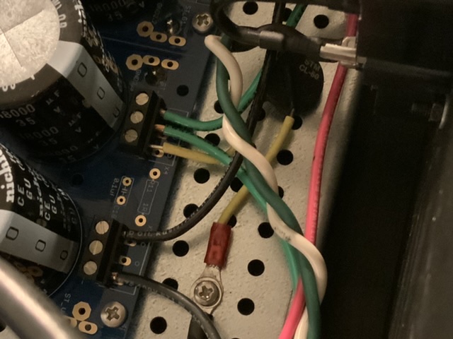

Your AC in is very close to your left channel. Try routing the AC right down the middle of the chassis, and locate your connection block between the PS board and transformer.
Also it is difficult to see whether you have a ground lift CL60 between PS ground and chassis ground.
Another thing that I just noticed - the power transformer purple shield wire is not connected to chassis ground.
That may be it. Looking at the post 2498, the picture you've uploaded yesterday, it looks like you've connected the ground wire straight to the chassis. If so, you need to connect the ground wire to the chassis through a CL60.

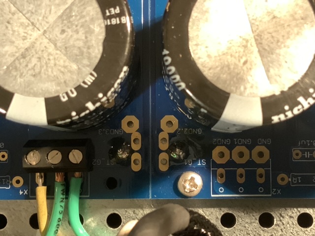

One last thought, looking at the power supply board - are the two sides of the ground connected at the output end of the board? It is hard to tell looking at your picture.
It is. I connected the ground planes using a piece of solid #14 underneath the board. You can see the soldered ends in the picture...

Just to rule it out, check that the amplifier ground is approximately 10 ohms above chassis ground (CL60 resistance) to rule out inadvertent short of amplifier ground to chassis.
Another thing to rule out is a bad connection or solder joint of ground. Check the resistance of ground on the power supply board to ground on the amplifier boards and inputs and outputs.

Question: On the PSU, do all of the pads at ST_IN2 and ST_IN3 need to be tied together? I only tied the two big pads in that area together (with solid core #14 wire).
