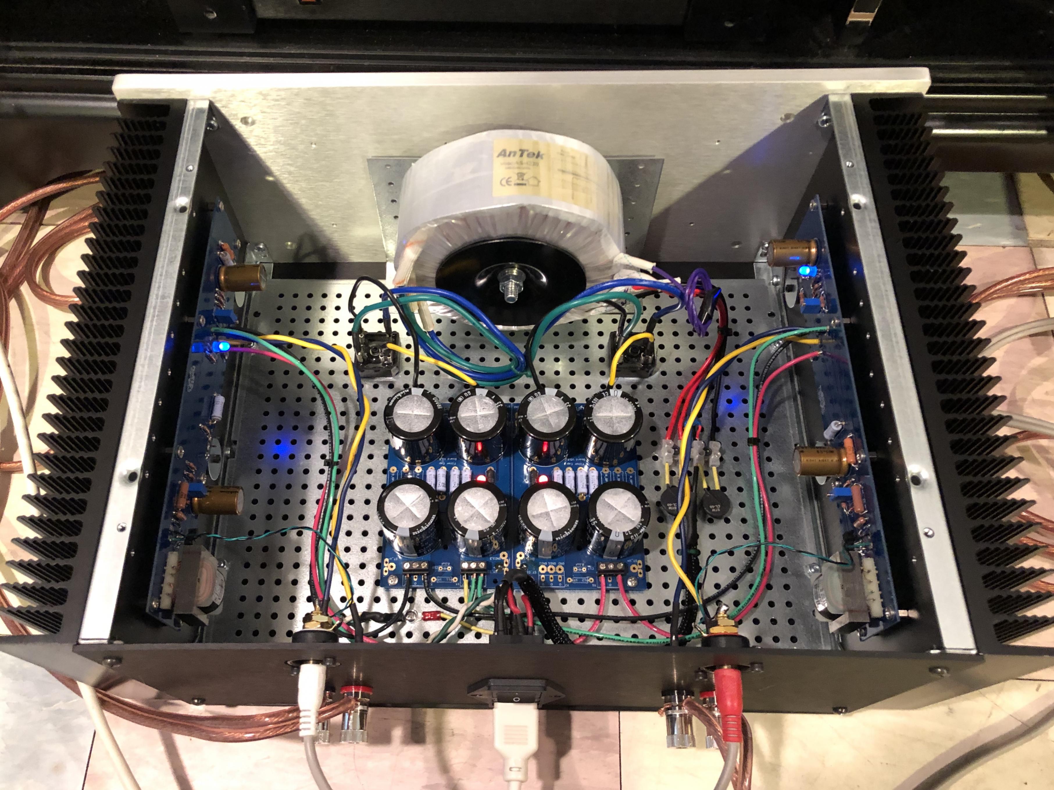

Tranny Hum!
Hey There,
I recently finished an F6 but I can’t get rid of a very low level 60hz transformer hum heard through the speakers.
I have tried rerouting wires, twisting wires, plugging it into the mains without a ground, removing the preamp, and so far nothing has worked.
As you can see in the picture, I have the transformer mounted vertically and it is suspended over the chassis. The bracket is bolted to the faceplate and the chassis floor. My grounds are wired just like many others I have seen here.
Any ideas? Thanks! -Glen

If you turned the transformer 180 degrees so the mounting bracket faces toward the psu that could help.
Assuming the bracket is steel, if it's not steel then it won't help.
You could also try shielding the jensen transformers.
What is the sensitivity of your speakers.

Hi picoDumbs - The bracket is steel, but due to the way I rigged this up, rather than turning it around I would have to add a new piece of steel to the other side to see if that helps. I’ll try.
You mean physically shielding the Jensen transformers with like a shroud around them?
I built the Troels SBA-761, so they’re around 90 DB.
The amp sounds great with these speakers. With music playing you don’t hear the hum but I know it’s there and I need to get rid of it! 🙂
