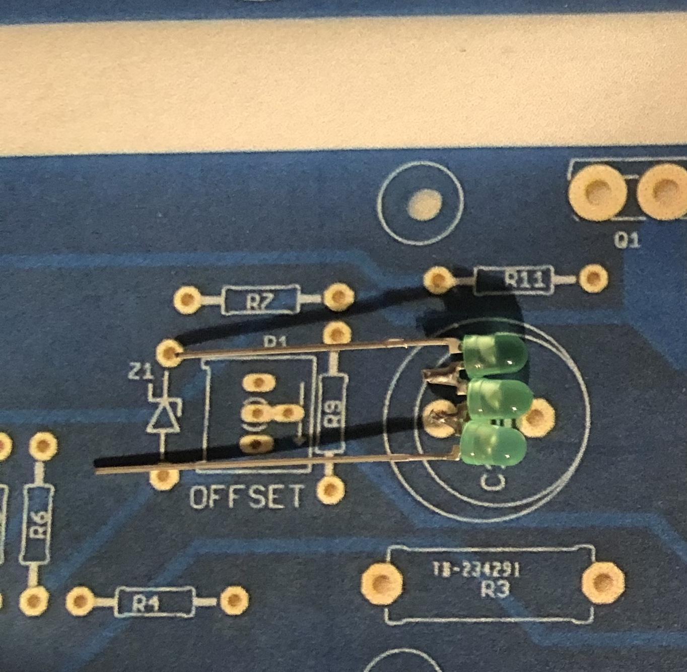

I replaced 6V8 Zener with 3LEDs, just to please 2 picodumbs :D Less bias drift during varm up. :)
R7, R8: 3K3
R1/R2:0R56/0R47
bias: 0,6V
When I first built it I went with R1/R2:0R47/0R47 but needed more 2H. Not noticeable change with 0R56. 3'rd dominate at 1V in and with 2V in 2'nd gets dominate. With Iron Pumpkin with no harmonics to speak of, fantastic pre by the way, I like to se if there is other mods I can try for other coloring sounds.
What about the mod 0R1 source resistors? Even less harmonics? How about bias volt over 0R1?
Other comments or ideas are welcome.

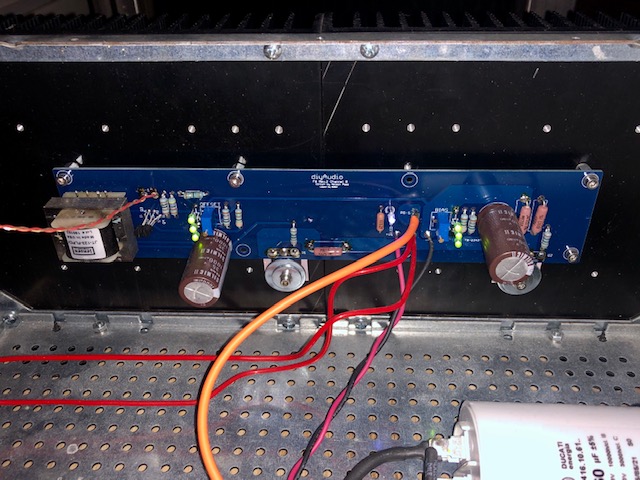

F6 Channel A issue
About one month ago I finished the build and dialed in BIAS (0.5V) and OFFSET (few mV) to constant levels. Lately, channel A started to show quite a drop in volume after some 20 minutes from powering up. If I crank up the volume the channel starts to work again; however, with reducing the volume the issue reappears. Both channels are dead quiet at the speakers. Any ideas what or more specifically which (heat sensitive) component might cause this issue? I hope it is not the Jensen transformer, as they are currently out of stock at the DIY audio store. Any feedback would be appreciated.
