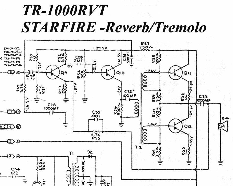

I spot the same concept, just like JBL "Energizer" with some Western Electric Germanium amps
just with cascoded output devices.

I make a note to JBL energizer sch posted earlier
didnt note about F6... Where is the sch of the F6, btw?

Antoinel - that's just matter of biasing
everything else as in any generic output stage .......
output transistor doesn't know what's nature of preceding stage , so - as I said - old story, generally speaking

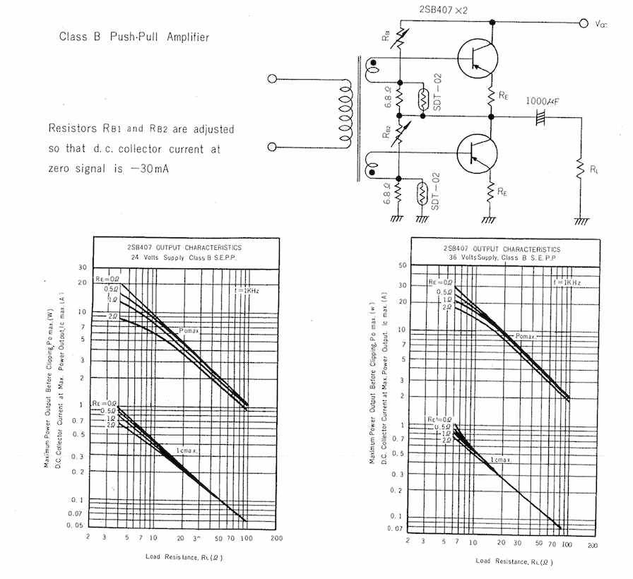

Zen Mod. I fully agree with you that I am not suggesting new hair-brain ideas. All I am saying is for lhquam and others to expand the scope of understanding and characterize the full potential of their Conceptual F6. We are still talking about the identical build; but with different operating conditions. Knowledge can only be bliss. All bets are that Mr. Pass operates his F6 in Class A. But; we know very little or nuttin' [as you put it] about it.

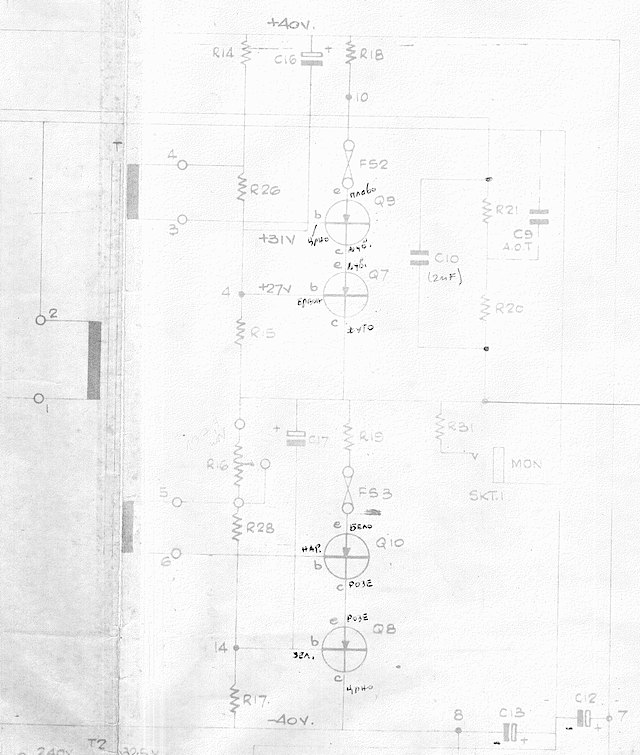

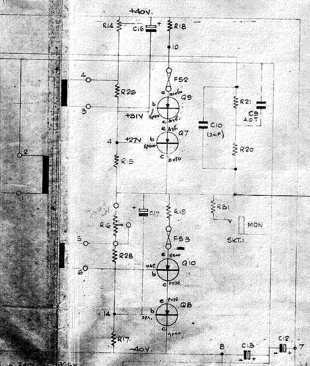

Thank you Zoran for the schematics.maybe it will be interested
Ola ZenMod,
at the moment I dig just this scan

just for the ilustration of the way Westrex did it.
didnt mean to prepare for the printinting or doing DTP job
he he
cheers
ZM. Thank you for the schematic. On classic papyrus? The Thread "F6 Amplifier" is truly a wealth of information for DIYers to tap in for the ultimate in flexibility of their hobby. Like patents and other gizmos, new and improved amps are built on the shoulders of older ones.should I post blank paper , too .......![]()
