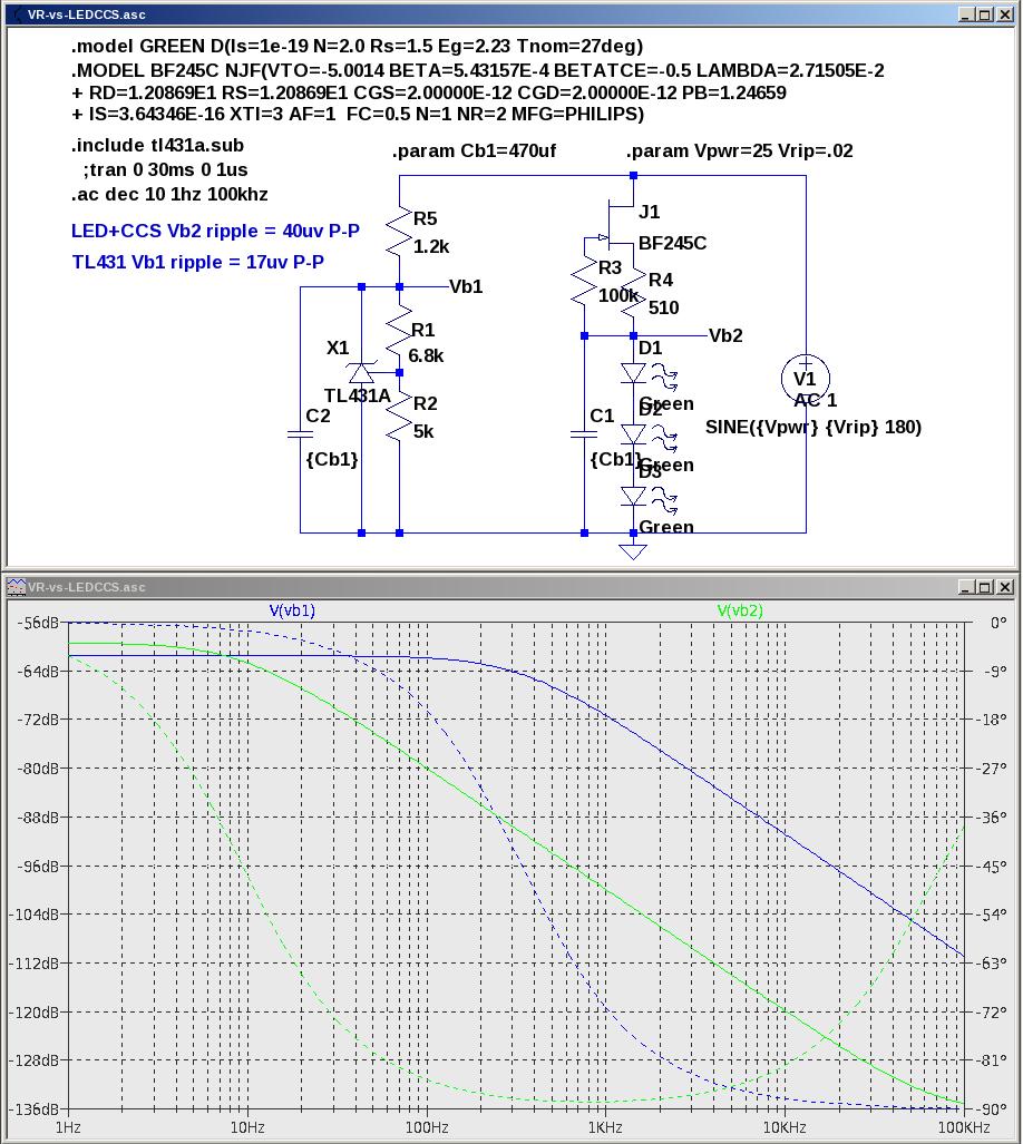

TL will not outperform LED,diode or zenner based bias net
You appear to be correct about that. Here is a Spice simulation of the two. The plot shows the ripple rejection of the two approaches. As you can see, the LED+CCS has a much lower corner frequency than the TL and is about 16dB better at frequencies about 100Hz.
dual vs. single because you need two bias nets :clown:
in fact , appropriate tempco will win stability wise but soundwise there will not be difference
