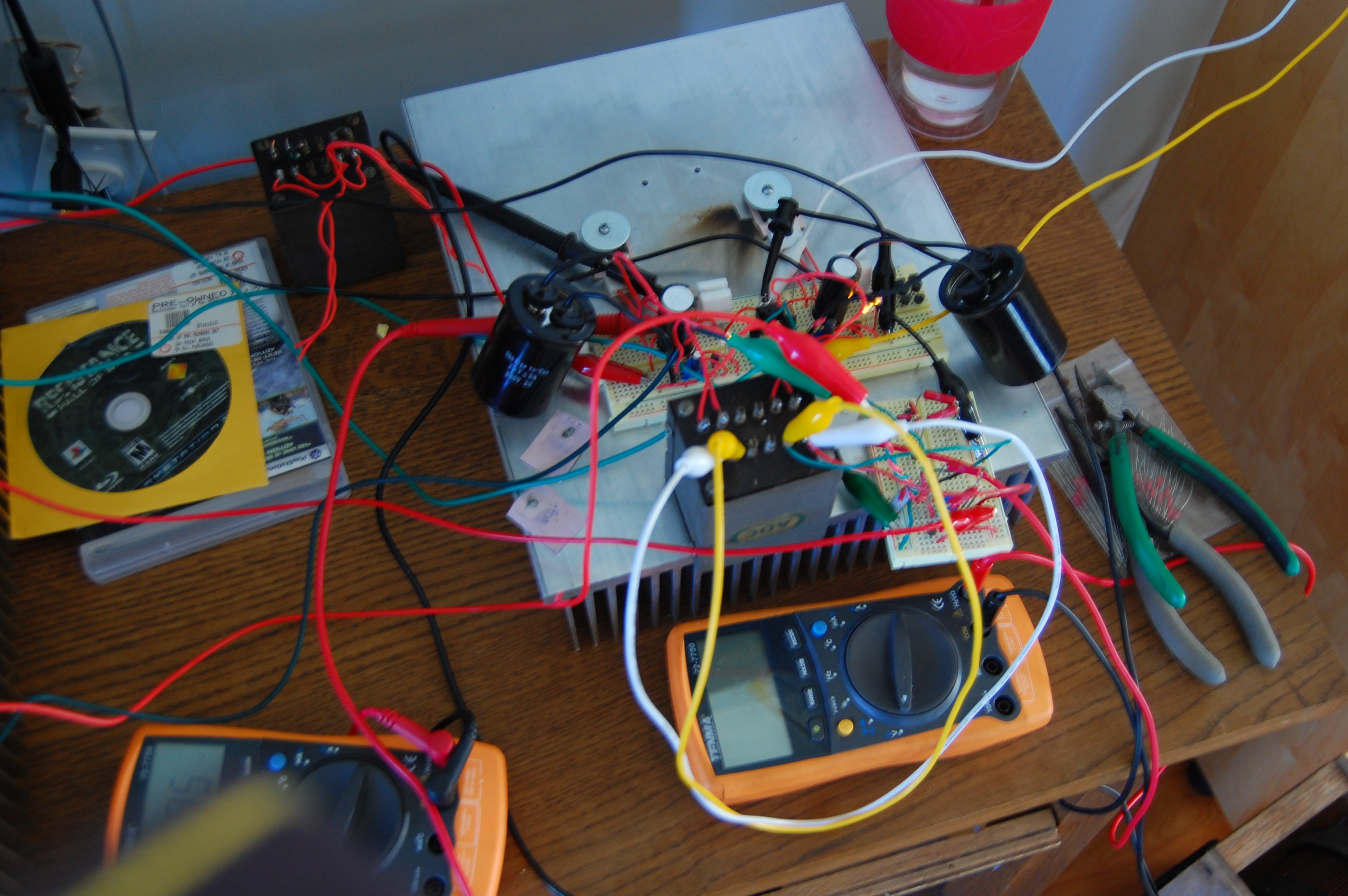

buzzforb. Are the results from auditioning?Preliminary results make me think less feedback, not more. I currently have .47Rs, bias of 1.3A per fet, 8dB of gain. I have some 330R mills, so Iam gong to try that. BTW, Bypass cap is necessary. I have 1K Nichicon Muse and they add their electro sound to the amp. Don't stone me please. I have some 470uF Silmic II's to try. I will be byassing with fancy Film more than likely. Although i cant grasp why you would want to do so considering the balanced nature of the circuit, I have considered putting two resistors in series to form the Rs Total. Put pot across top one and pull modulation point from their. Wouldnt lose all you DF and would allow for Zen adj.
Yes, but just single channel. Maybe get the other up tonight. Voives come across as very natural, clear and airy, but there seems to be a veil with more complex music. I don't think much of it for now. I need to hear two channels. I added 4uF Film caps. Helped some. I will try other things tonight. It has enormous potential. I am sure we will be very surprised at Nelon's version. All others are just play things. I will try the trafos from BudP tonight. THey should have a little greater extension, but I am in no way saying that it is the transformer. Just havent listened enough.
18dB. My bad.

Alex: This is an interesting circuit. How low a Zo at a voltage gain = 1 [Transfollower] did it achieve?
Ideally the output impedance is similar to what you would expect from a traditional PP complementary follower - 1/S.

1/S or 0.5/S due to transconductance doubling?
Cheers
Alex
1/S or 2/S due to transconductance doubling?
If the FETs are biased into Class A ~1/2S. In Class B/AB ~1/S.
Alex
Thank you Alex and lhquam. What is the value of S and thus Zo for Teaser-6 operating in Class A?If the FETs are biased into Class A ~1/2S. In Class B/AB ~1/S.
