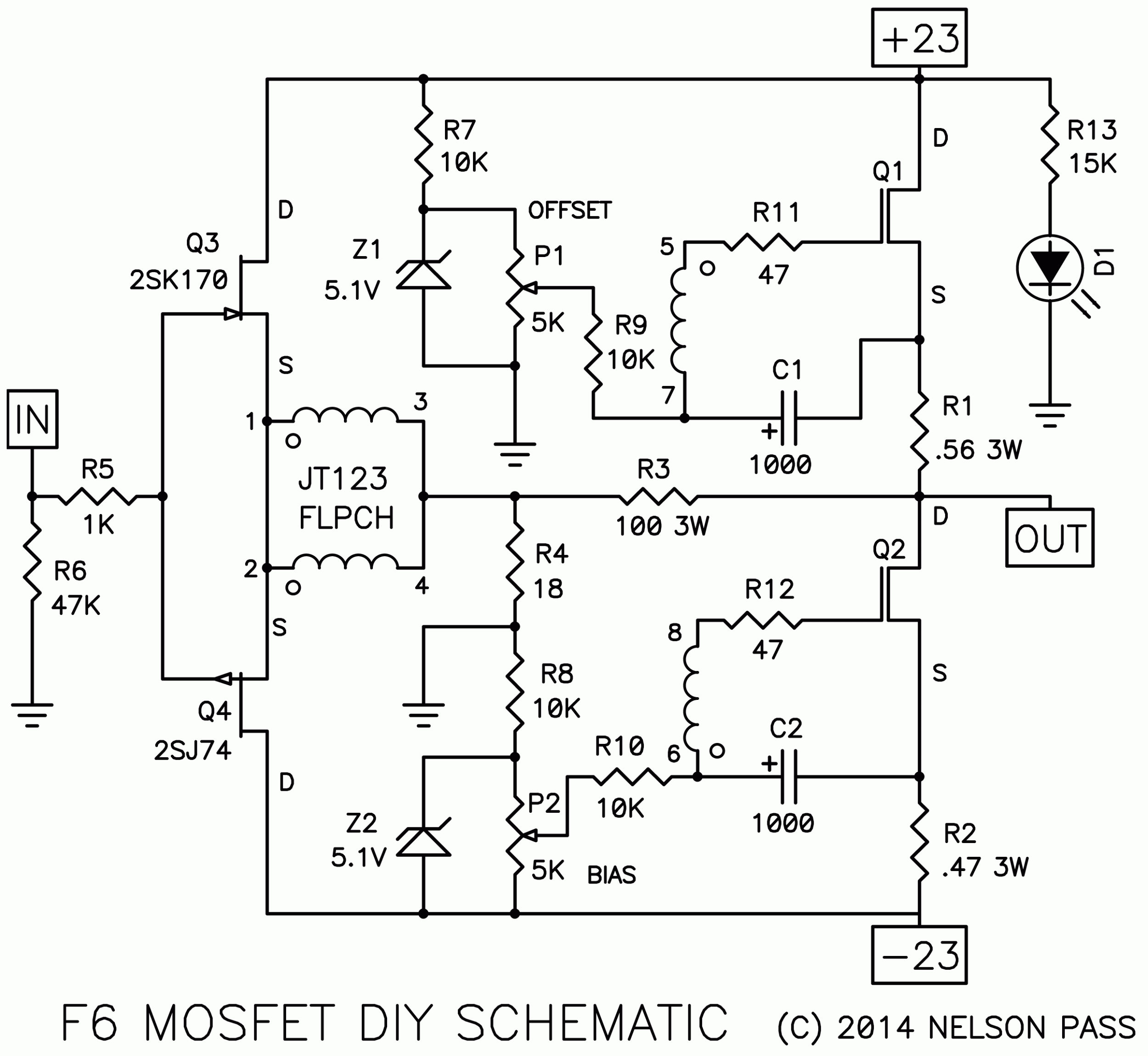

F6 Amplifier
A grade are low Idss for the F6.
Measure and label each Jfet, and use pairs wit the highest Idss you have. 6.0+ should work well. The circuit is designed for Idss around 8.0, but a few mA either way will still work.
So i can use grade A transistors without any problem or not? ... But better to match them to lowest difference as possible, finally two parameters lowest idss and lowest difference of each other. Correct?

You can use the A jfet, just use the highest Idss pairs you can make.
Use whatever capacitors that make you happy. I like both the FG and the Silmic II. Expectation bias will make more of a sound difference than the actual materials.
6L6, something in this circut critically depends on that idss must be around 6.0 mA (that give mostly by grade B) or i can use transistors with 2.5 mA idss (grade A) without any problem? I mean circut designed espicially for grade B or that all depends on money at mine pocket? Thanks!

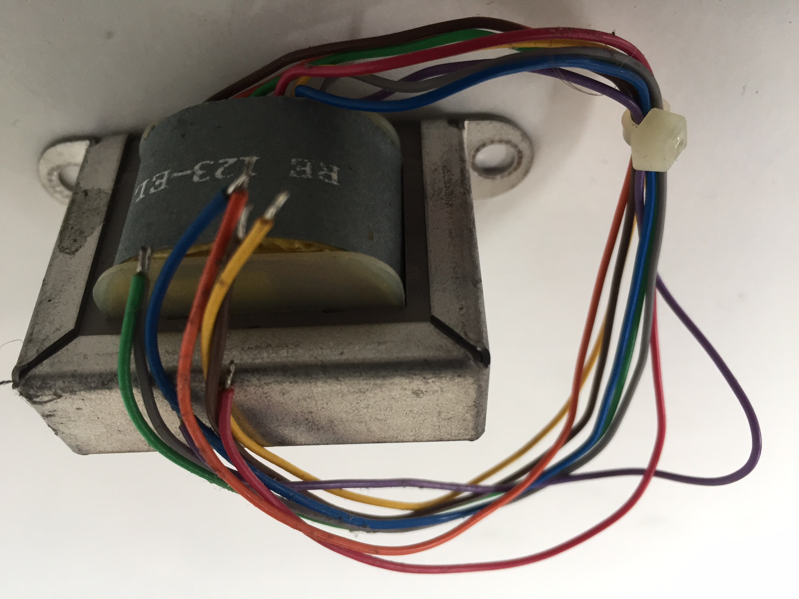

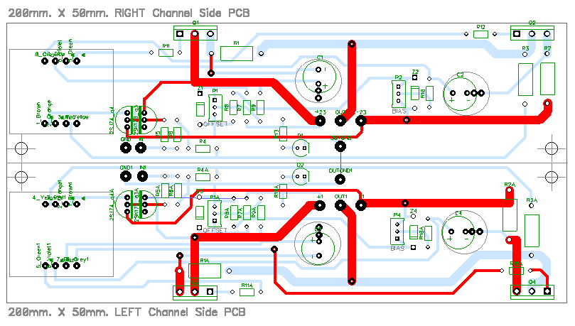

Hello here Pass_people 🙂

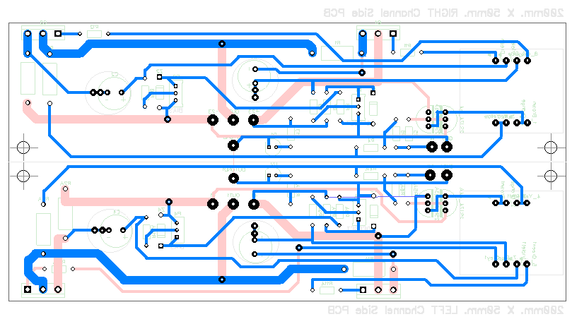

Anyone care to comment on my layout, specialized for my old all-aluminium/cobber chassis.
Board(s) are like the Diyaudio store boards "matched" left/right.
Transformers are Reichenbach's
Jesper.

Hi... Thank's for answer! But i honestly can't see that?
Jesper.
I think you should be able to see how the R3 is connected to the output, just like the neg.ch output FET is connected to it and just like the source resistor of the pos.ch. is connected to it.
Other things you could consider:
You could try to closely couple all the flows and returns on the PCB (look at the transformer here),
try to minimise all the loop areas (input and feedback for example),
you could make the output stage pos.ch and neg.ch track impedances as low as possible and symmetrical
and you could make an ideal low impedance audio reference ground point where all audio returns connect.
That should make your PCB as invisible as possible to the circuit itself.
But your PCB is not a disaster, it is probably as good as the store board.
Which is "good enough".
= try to minimise all the loop areas (input and feedback for example),
==> That should make your PCB as invisible as possible to the circuit itself.
So if I infer from that: the routing of the signal through the capacitors should go on the other layer and run over the earth line, just having a bump where there is any solder point of that earth.
Ever heard of Oliver Heaviside? "Most of the energy runs not on and through the lines [PCB traces] but through the isolation and earth underneath". Well I reformulated it myself but gives us the thinking of a pioneer.
Every engineer talkf about inductance loops . oops​
Then - - by looking through the print, you cannot see the trace anymore.

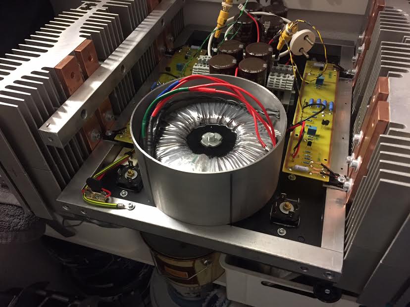

palstanturhin, thanks for commenting on my pcb... I will see how it will work. But as when you wrote, i alleready have drilled holes and everything on my raw pcb boards 🙂
Anyway, i see that shielded torrid is prefered. But buying an new one, that is not going to happen! :$::$::$:
I will try this stainless steel ring around my torrid for a start, and see if i will succes with that. Maybee put/welder a lit on it ?
That torrid, have been used in this chassis for both F4, AlephJ and the F5 which is sitting there now without noise/hiss ?
Jesper.
EDIT :: I just found this description of some fine torrid's 😛

Shorted Output
Hey, putting this out there just for reference to anyone that experiences a short.
I lent out a mosfets F6 to a friend. He said he shorted the output with large "audiophile cable spades". Luckily, only a few parts were fried.
The input transformer and jfets were not affected. Pleasantly surprised.
Obviously burnt were the source and drain resistors. The 100 ohm 3w resistor was OK, but changed it anyway. One of the gate resistors was reading weird in circuit, but ok outside- replaced it anyway. Only change 7 parts.
1k uF caps were ok.
Most parts tested ok in circuit, like resistors, zeners and caps. Saved time removing and testing them. I think the power resistors acted like fuses. Maybe their demise prevented other parts from burning. The 2.5 slo-blo fuse did not blow.
Brought everything up with a variac and it biased up nicely.
Maybe situation could have been worse, but that was my experience.
