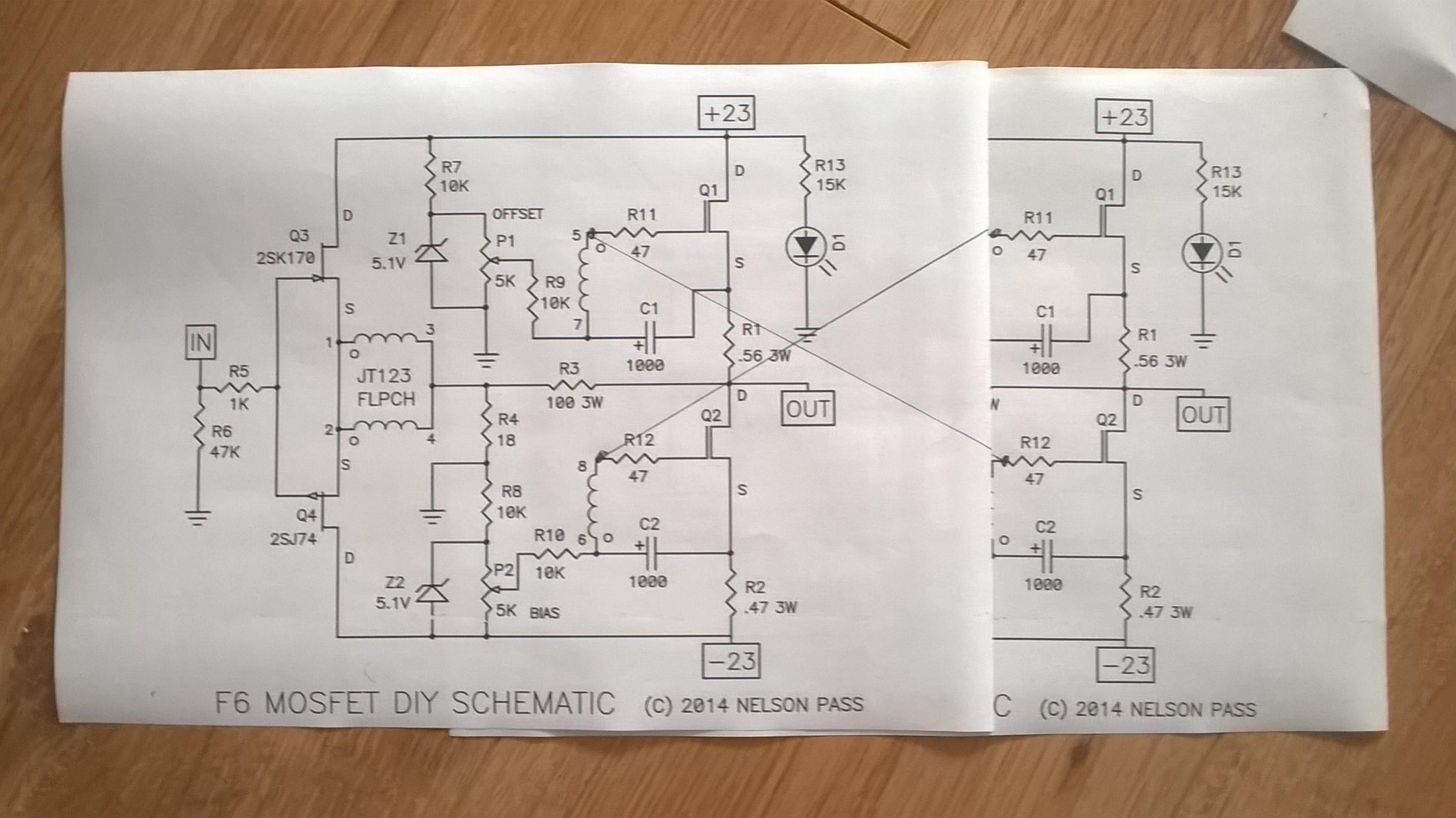

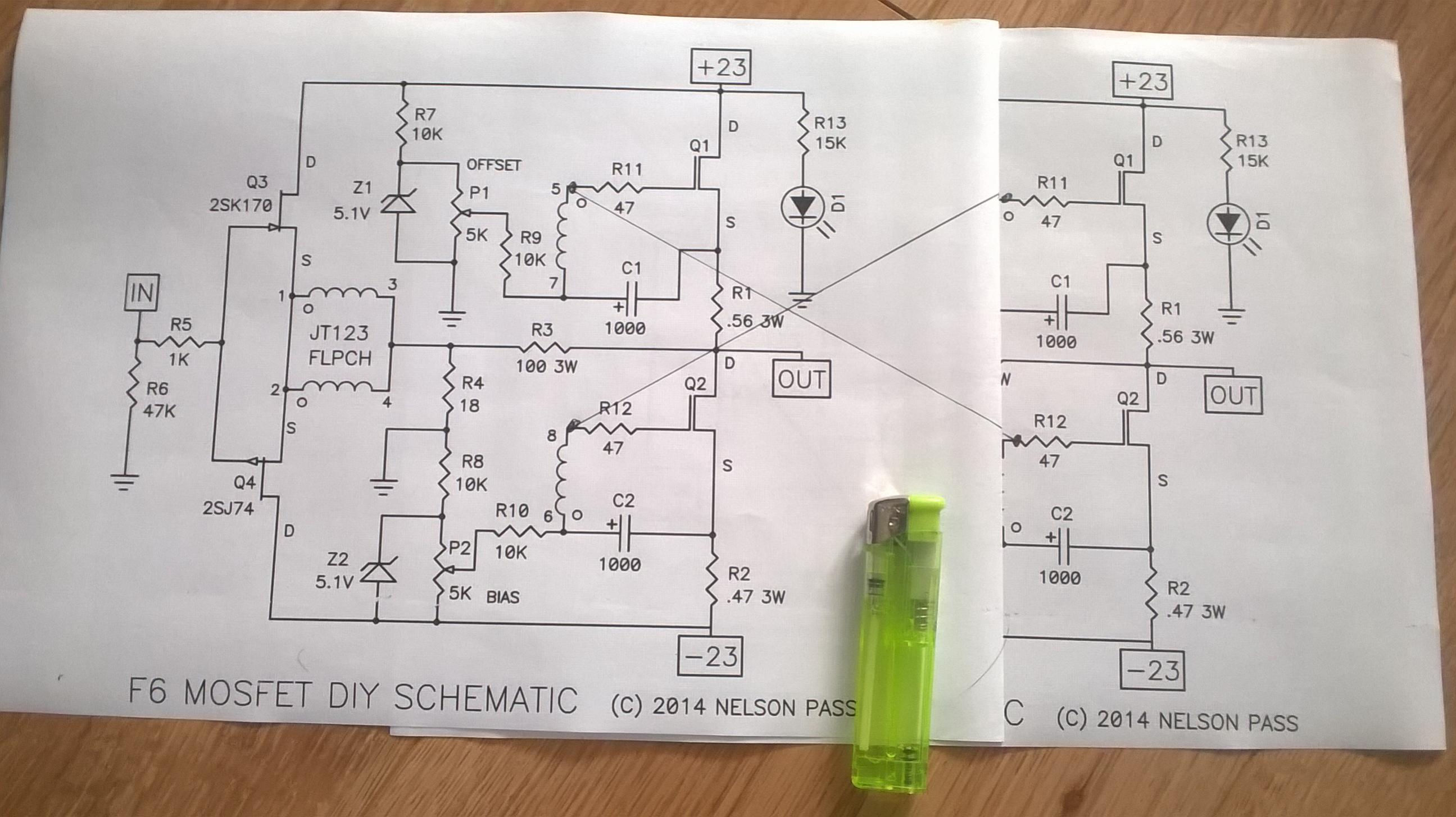

it is bonkers idea and pretty poor sketch bias circuit covered by other piece of paper most probably is still needed
just the coil pin 5 connected on other half pin 8
and pin 8 connected to other half pin 5
but then I could not use my pumpkin balanced out to drive it

looks to me like you have to pay attention to galvanical isolation 😱. i.e. the coil in the left bottom has a different potential than the one at the right top, so to say.

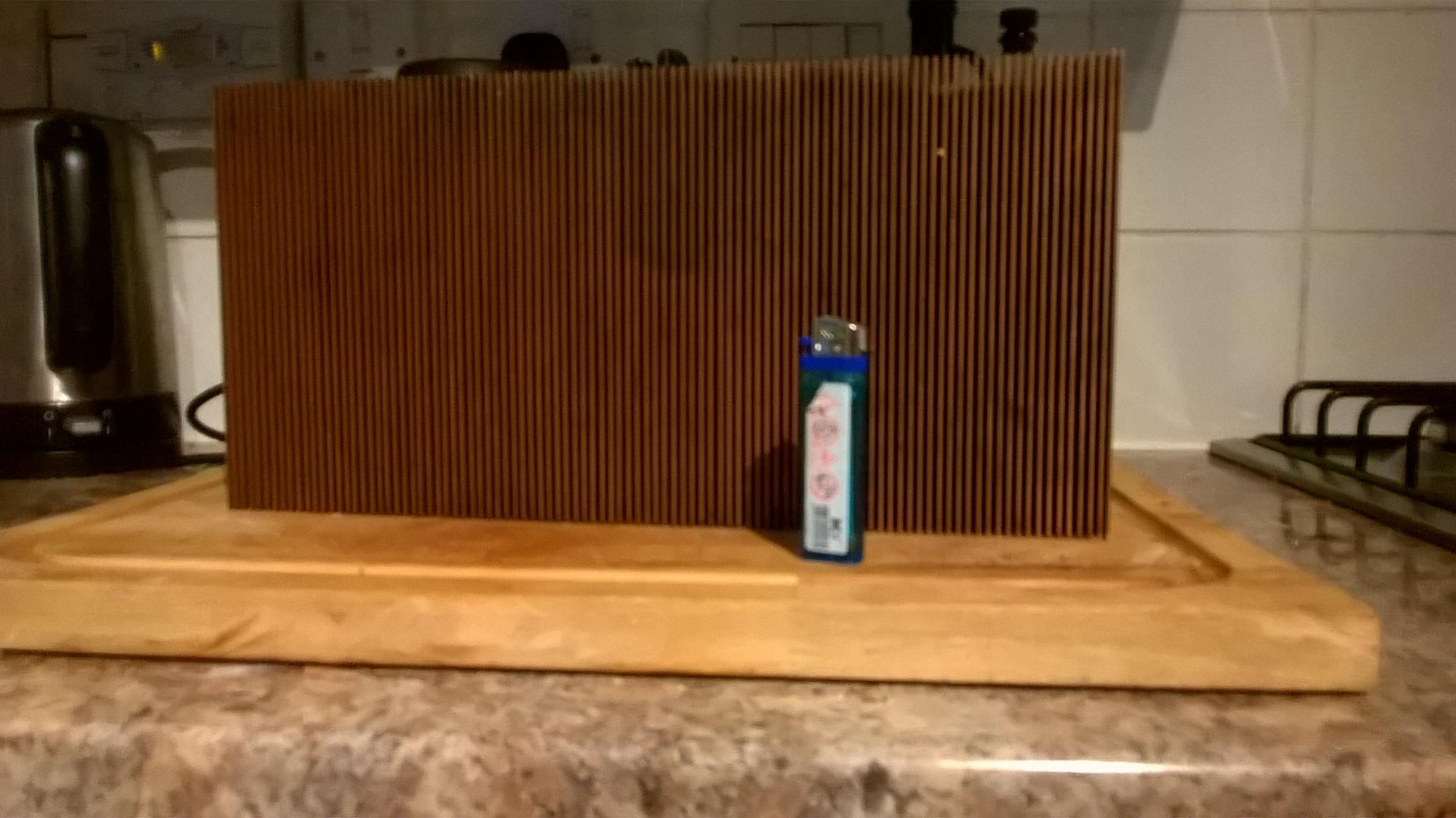

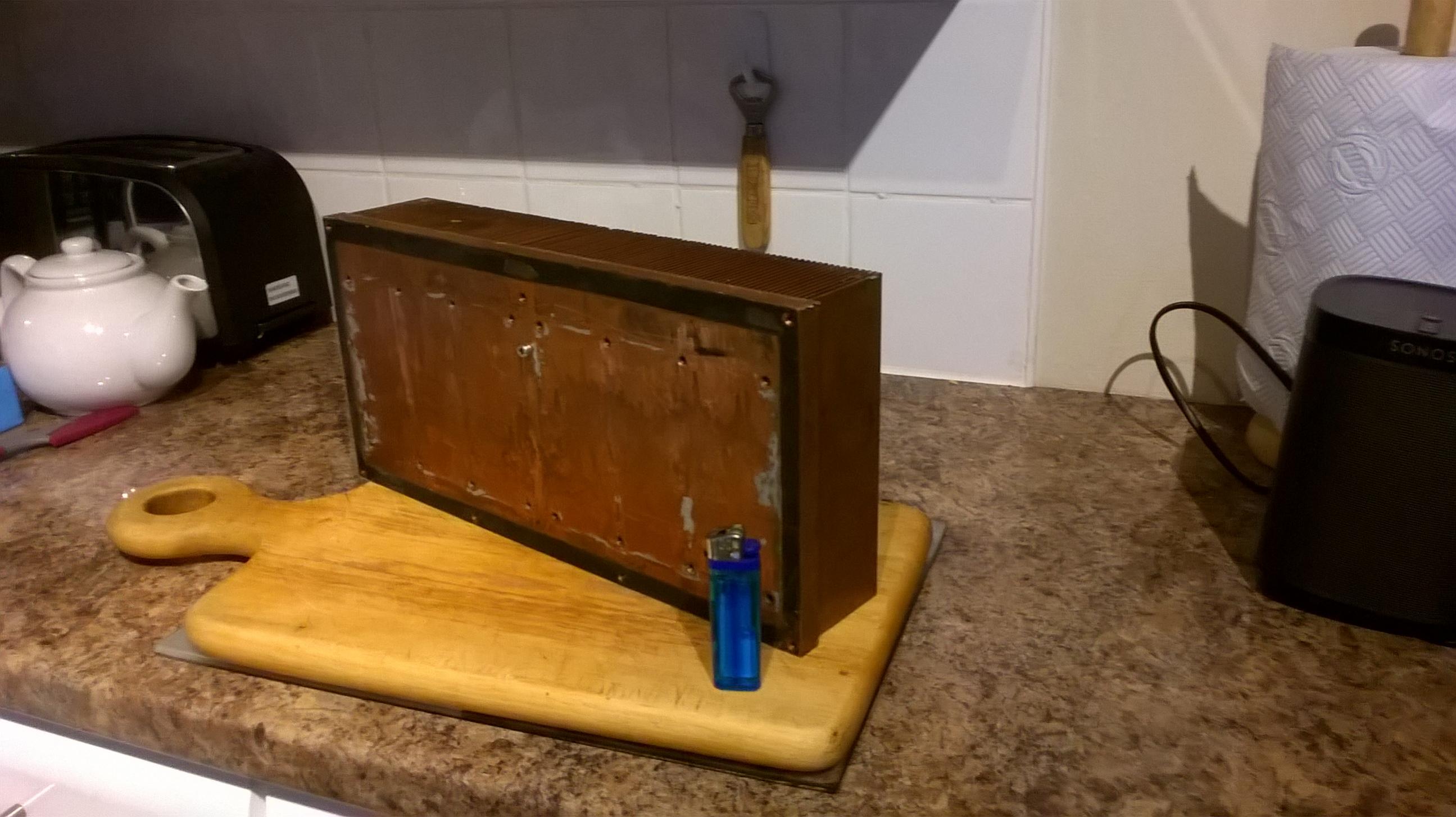

for now believe that it came out of a Danfoss VTL 250 Kw inverter
The picture was taken 3 months before the drive blow up and show the aluminium one used for the rectifiers
The copper one is just behind it
and now sitting in my locker at work but not for long

a couple of days in a coca cola bath and it will be all sparkling like the day it was born
Then chop in half and hand lapping whit baking powder

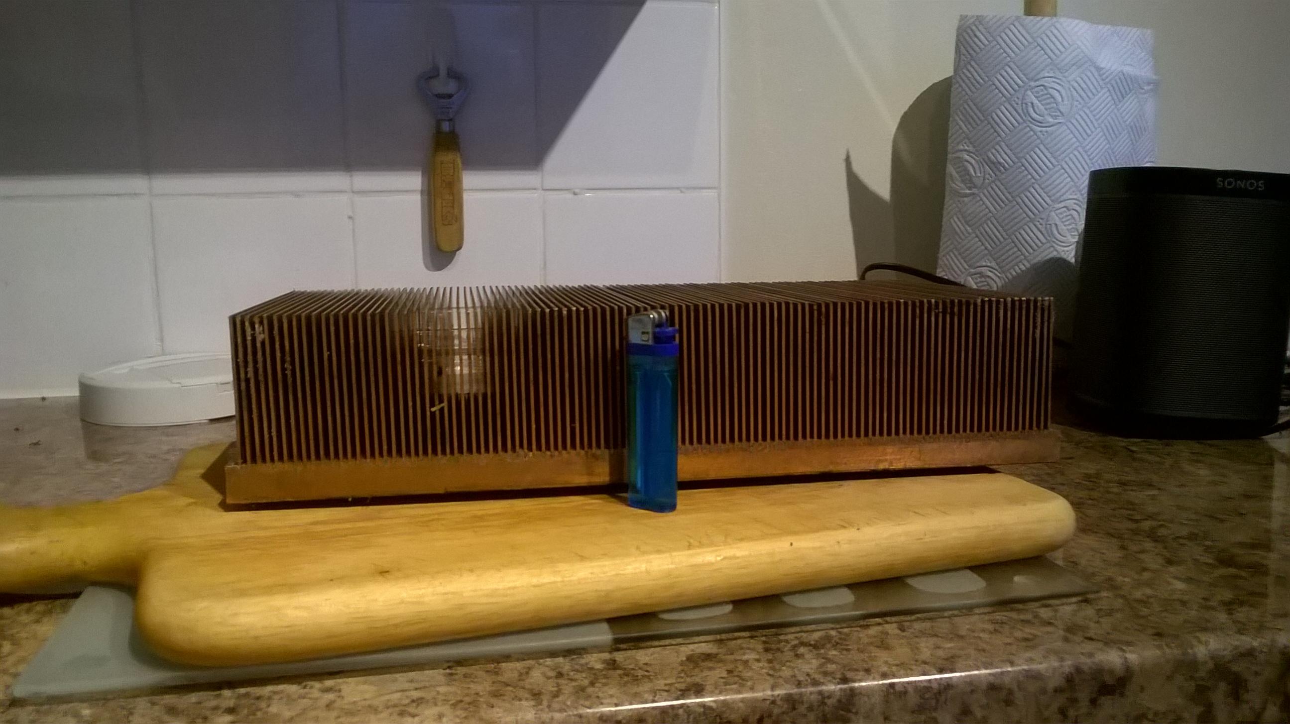

It was designed whit fan cooling in mind for a 250 Kw drive
Can't remember who's sedz "amazing what a litle forced air cooling can do"😉
Moss Fet's and thermistor for fan controller 2 120 mm fans at quarter speed should be pretty silent.
The F5's have been running for years now at 34 V and 2.6 A bias on TO 220 FQP19N20 pairs (see my F5 )
So one wonder given the size of this sink how far up can I push the trafo specks for vanilla F6 (Just one duda for rail)
24 V ac secondary seems to add up
