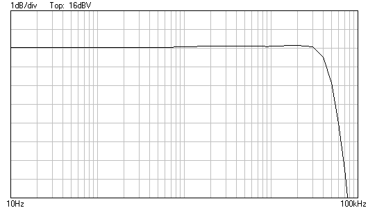

Frequency response...
I do NOT hate that.
Flat to 30kHz and then cuts really sharply!
I do NOT hate that.
I do NOT hate that.
Very nice build ;-) , what about the sound , have you tried it with good source and speakers
I do NOT hate that.
Not so sharp if you change the scale.

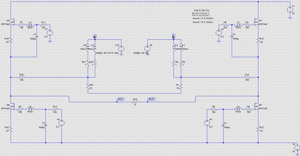

Is there a way to X the F6 ?
You can build a similar output stage / transformer combination balanced
with X connections at the input.
Ask ZM, he is currently playing with an xfrmr front end like that.
covered ages ago , by your Modest Mighty ZM in original F6 thread , and also in Funny^6 thread by Buzz
for quick cover , look at this blog post by Mighty Mo(dest)i : ook, it seems Baby DiyA is down , most probably our Webhamster is upgrading the board ...... so find enclosed just Funny^6 schm , I can't remember where thread is
also - having 6-fillar repeater could be best way of doing it , I can post that too
edit - ignore those 1R resistors in series with coils

6 fillar repeater is that a trafo whit 6 winding's ?
Please do post that
