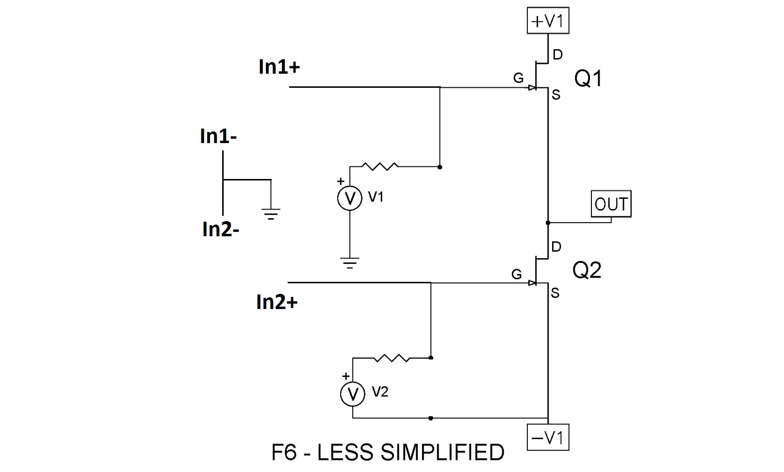

I just brain stormed how it would be possible to realize the P2-pot from the PLH to tweak the symmetry in this circuit:
So the in practice it would probably look like a F2 on top of another F2, and to incorporate feedback I think the easiest way would be to use one F6-transformer for each input so we can combine the output to the inputs, unless you can do it without the transformer that is.
The idea would be to have two separate input channels for the amp and use DSP to act as the P2 pot. The simple way would be to just reduce one side, or you could reduce and lowpass one side and all-pass the other for a more complex pattern. I think I have the wrong polarity on one of the inputs but with DSP that would be easy to change 😉
So my question is: is this completely crazy or is it something that actually could work?
