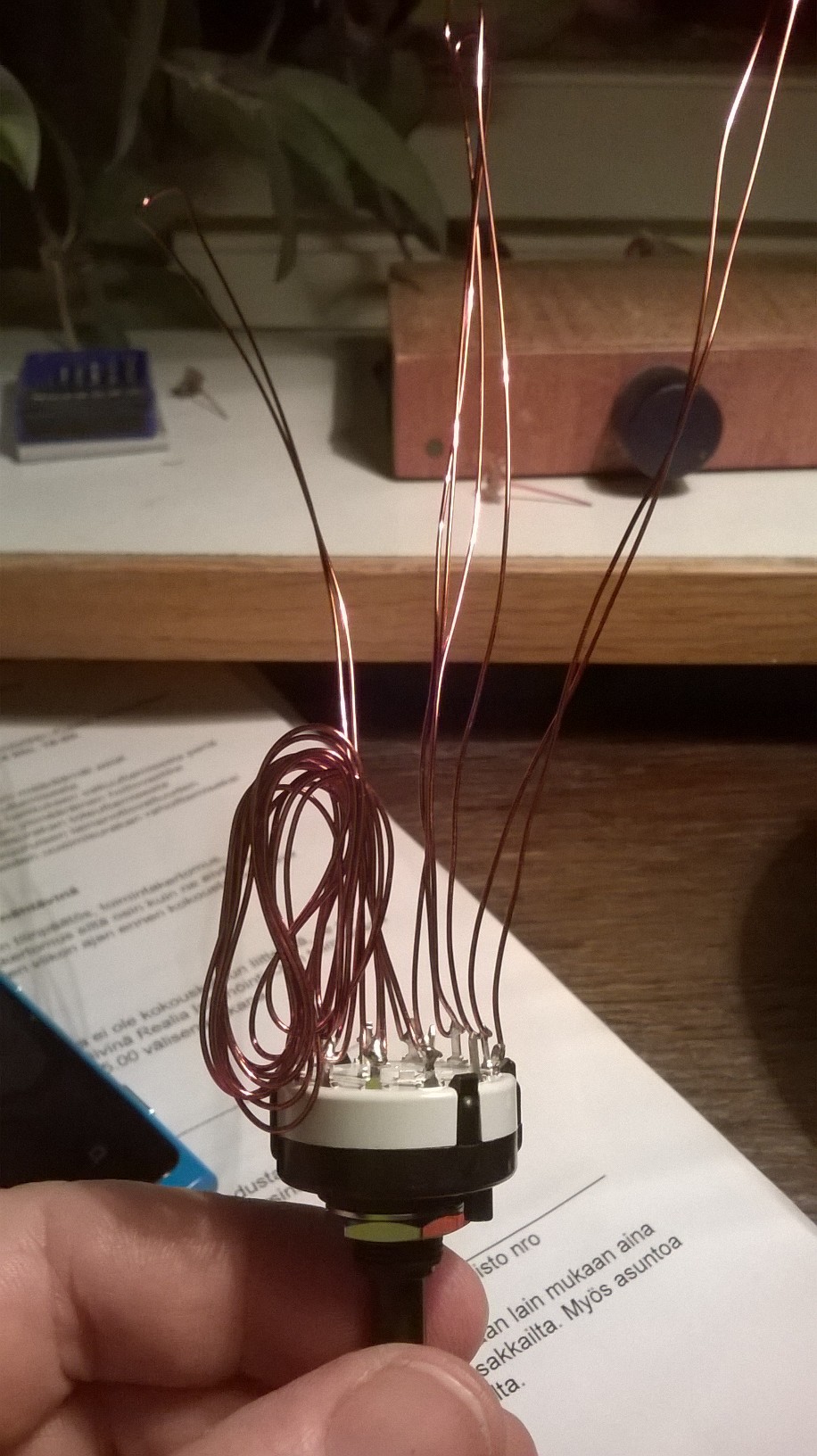

What's this?! its a variable resistor. 🙂
Explanation: I needed a metod to easily test different degeneration resistor values (soundwise)and sadly the local store didn't have any smaller power resistors (2-3W) than 0.1 ohms. So I made a kind of a lader pot using 0.5mm copper wire. Copper wire resistance is 84.22 ohm/km (for 0.5mm dia) so each 30cm wire length between the switch pins gives about 0.025 ohms additional resistance to the value of R13 and R14. So now I can test the sound of the amp(s) with exact values of: 0.0 - .025 - .05 - .075 - .1 ohms. Will be interesting. 😀
Soundwise thinking: I had the 10 ohm trimpots (P3 & P4) in place and listend for some time. But the problem was that the trimpots would not go totaly open (= zero resistance) so I was not sure how that affected the sound. I've now tried the amp bypassing the trimpots and output degeneration resistors (R13 &R14) but am not totaly satisfied with the sound. With the trimpots in, I got a setting with more flesh and voluminous timber - but also a little too undifiened bass. Without the pots and degenaration resistors the sound is more balanced and tunefull, but... also a little too dry. So now to try the ladder pots. 😛

I take it is insulated wire? If not then I guess you will have to be very careful none of the wires touch =)
...So I made a kind of a lader pot using 0.5mm copper wire. Copper wire resistance is 84.22 ohm/km (for 0.5mm dia) so each 30cm wire length between the switch pins gives about 0.025 ohms additional resistance to the value of R13 and R14. So now I can test the sound of the amp(s) with exact values of: 0.0 - .025 - .05 - .075 - .1 ohms. Will be interesting....

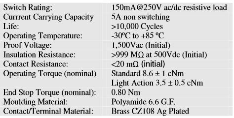

Especially regarding the contact resistance of the switch ;-)
Contact resistance of switch with the silver contacts is about 0.015 ohms (wish I had a better DMM). Also the input leads bring a bit of resistance, but in any case it's better than the 0.15 ohms resistance of the trimpot.
I don't really know if this all matters that much, but as the degeneration resistor values are so small it would be logical to think that minimizing the inherent resistance would make a difference. But it's fun to experiment and try to get the best sound possible in my system. We will see. 🙂

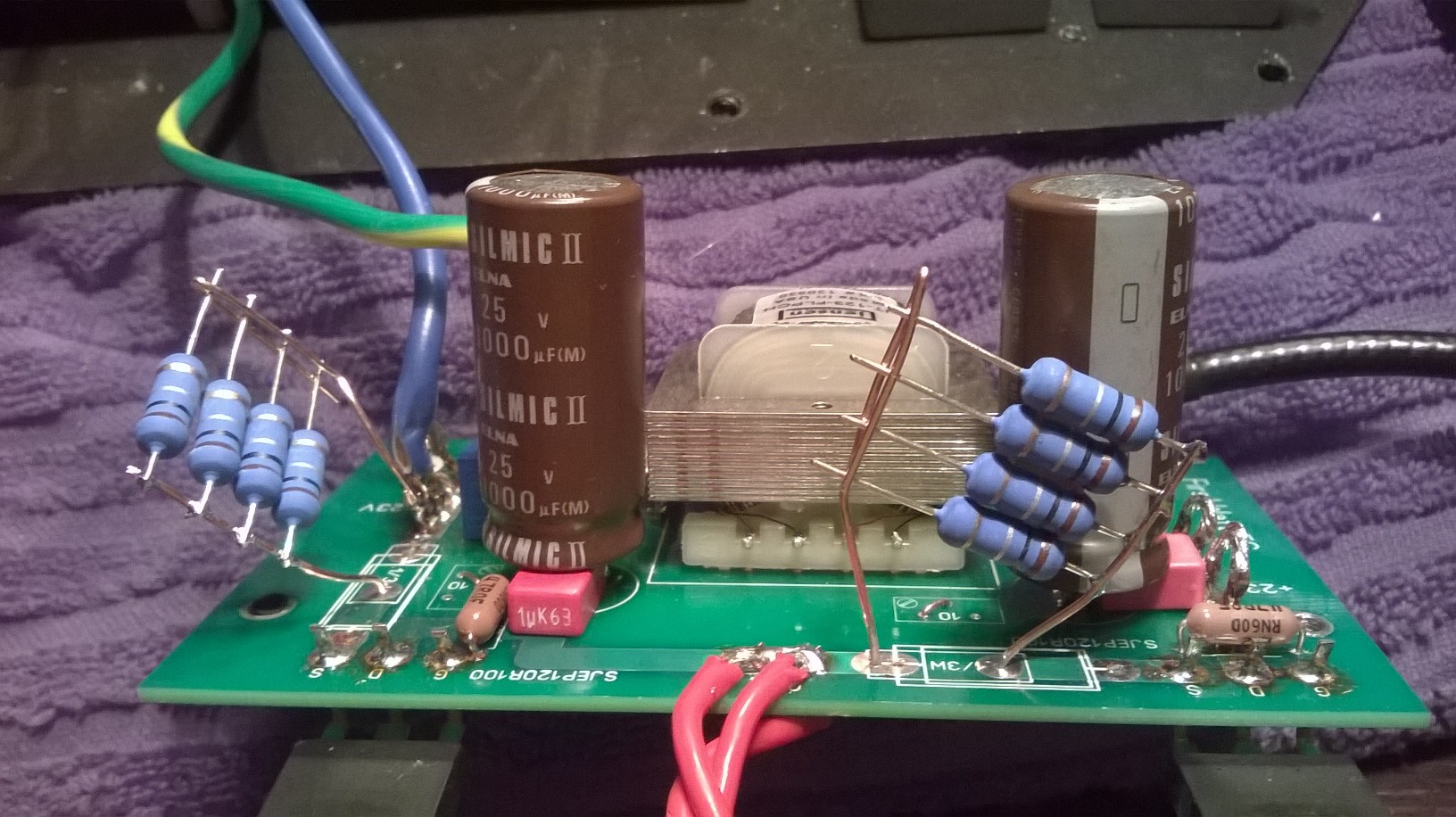

I removed the 10 ohm trimpots (P3 & P4) and changed the caps (as seen in post 5675) . Now one of the channels won't bias up to 1,55 amps - only a little under 1,4 amps. The other goes up, no problem.
Why would that be? Any explanation? Could the new caps be responsible for that?
And you made a bridge from the former center position of the pot to the right place?
As shown in attached picture (red line).
source resistors
You do mean R13 and R14?
I've been testing the sound changing between R13/R14 (0.1 ohm) while the other resistor is bypassed. Also tried both attached with 0.1 ohms to test if the bias would go up - but no.
But still, both channels were treated the same - the other is fine... Also the power supplys (dual mono) give the amp boards 22,67 volts and 22,80 volts. The problem PCB gets the 22.8 volts.
During start up the bias does go over 2 amps but comes down then to the said 1.4 amps.
