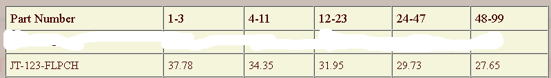

so guys - Pa just gave you another tip - at Jensen , that piece is well under 50 greenies a piece
who's gonna be the first to complete on-line order ?

it's 4 x 150 ohms , or 600CT:600CT
http://www.jensen-transformers.com/datashts/123flpch.pdf
as said previously - impedance is (same as ground ) very often just state of mind
it isn't 600 or 150 in this amp - think of reflected impedance from secondary to primary - that's the load for input buffer
by my experience , with lowish impedance category xformers , inductance ( more precise - enough of it ) is always most critical
