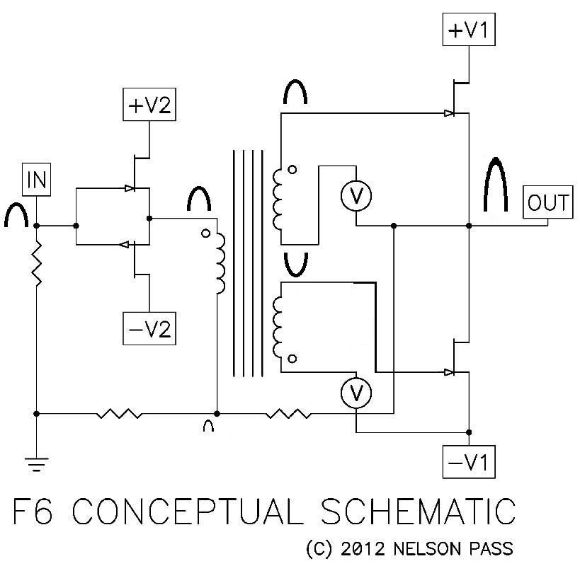

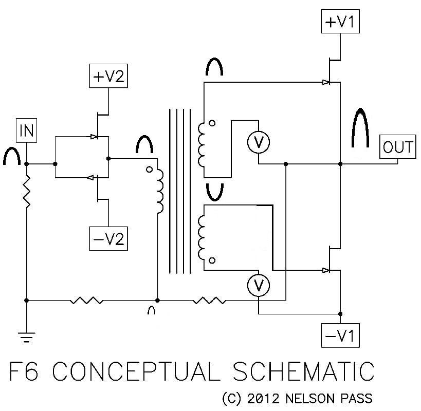

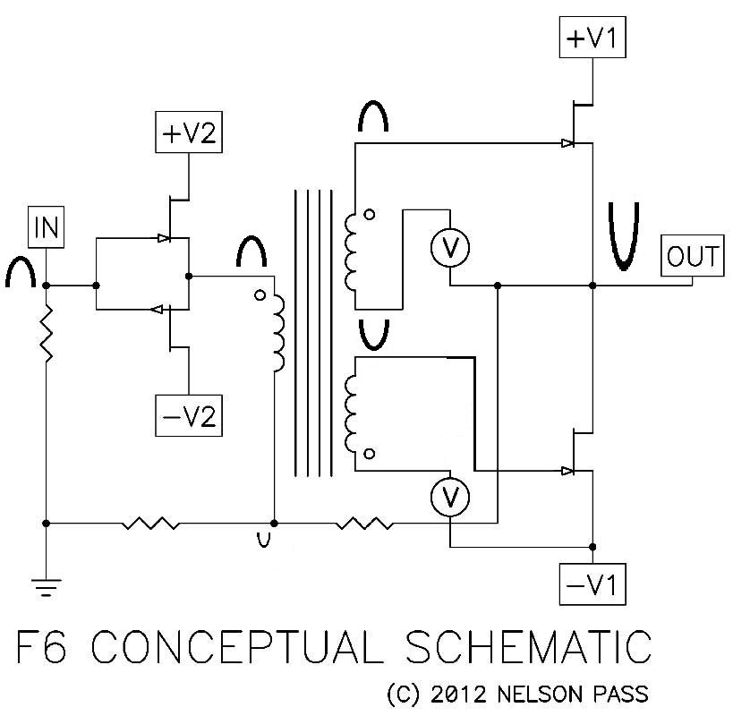

again - as drawn by Papa in post #1 , those two secondaries are in phase
and , at least by my limited knowledge of English , he confirmed that
like always - Devil is in details
look at this - just little re-drawn , for clarity sake
blahblahblah
so now , after Papa merciful waiting to bring us proper schm ( Oh , I didn't saw that mistake ) , let's make short - this time proper - analysis :
besides biasing , simple Greedy Boy can freely expect few more tricks ......
maybe yes ........ maybe not

Are you mistake in this drawing intentional? 😎
I was right....misdirection! I am going back to ugly cousin, bastard R085. Gonna try CCS, ALeph CCS, and SRPP. Now that i think about it, the Srpp could be plugged int this circuit...no no no. Get back on track.
naah
not same thing again
this time I'm double double sure

The overall phase in non-inverting.
The only mystery is how the circuit
worked so well that way...
I have a theory on that.
moi again ....... I flipped unflippable so many times , so my flipping brain was flipped again 😛
to repeat proper one - just for the record
Will this blow up?
most probably not
but biasing must be adjustable , to achieve proper 0 on output
most probably not
Forgot about bias pot for upper fet.
It follows that:
- The output FETs are/must be highly matched [within the grasp of the DIYer].
- Circuit operation appears to be highly symmetric. When the upper FET is relatively on, the lower one is relatively off. When the upper FET is relatively off, the lower one is relatively on. The 2 ON states are made equal, and the 2 OFF states are made equal too. This is symmetry. Correct asymmetry with loop feedback.
- F6 Amplifier
