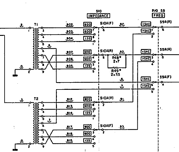

In general, I am not in favor of gutting test equipment for the innards -- except that I do it all the time with HP465's amplifiers, one 403 a.c. voltmeter which sports new rechargeable cells and one 3400 etc. Hewlett Packard made a telecom test kit with oscillator, voltmeter and patch panel -- you find beat up ones at ham fests -- and the 353 has the following transformer:
you can beat that only with something like this (there are also 600ct:600ct types , looking exactly the same -all of them having toroid nickel core ) :
see more here : http://www.diyaudio.com/forums/pass-labs/174674-papas-koan-papas-surprise-2.html#post2356057
same jobbies made by Tamura and WE are having price equaling their weight in gold :rofl:
and they are plain and simple repeater coils , as called in Telephone Service duty
so - here is another tip - look for old repeater coils , and stash them in quantity .....

my experience with iron is - if you already have some , try it for anything you need ;
if you don't have them already - buy confirmed/prescribed ........ especially if they're cheap , as in this case .
can you imagine effort invested in testing 15 different types , for after DAC I/V duty ?
just to realize later that good old Beyerdynamic mic 1:7 (or 1:10) are best and pretty much easy available
catch was that I had those 15 different types in box ..... :clown:
