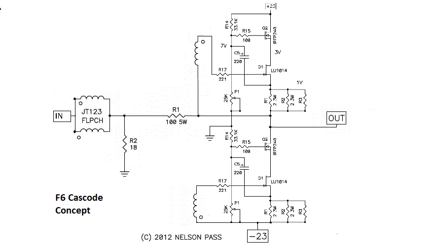

Can you explain why does the Vcc need to be +60?
In the F3, the extra voltage was there to bias the active load.
Doug
DougL: Please refer to the upper cascode circuit. The idle voltage between the drain and gate of IRFP240 is Vdg ~16 Vdc. Suppose that a positive output signal peaks at 11 V. This transient state leaves a dynamic Vdg ~ 5V; which I am tentatively assuming to be needed for the proper operation of this MOSFET. The expected output power under this proposed condition is ~8 W(rms) into 8 Ohms. I reiterated in other words the response of flg above.
Best regards.
Antoinel,
Thanks for the explanation.
I am going to have to think about this some more. :)
Sounds like other topologies are more cascode suitable.
DougL, you are welcome. Your schematic is a functional design; noting that nobody complained about its topology. Suppose that the power rails you wish to use are +/-30 Vdc [flg] instead of +/-23 Vdc. The output voltage may then swing 36 Vp-p into an 8 Ohm load for an output power of ~20 W(rms). Please recall what Mr. Pass wrote in his F6 article [and his demo on the scope] that 1 Watt can be fully adequate with a sensistive loudspeaker; maybe of 93 dB SPL.
Best regards.
N.B. Will a darlington instead of a MOSFET be suitable? One may be able to getaway with a Vcb ~1.2 Vdc for more output power with lower power rails.
