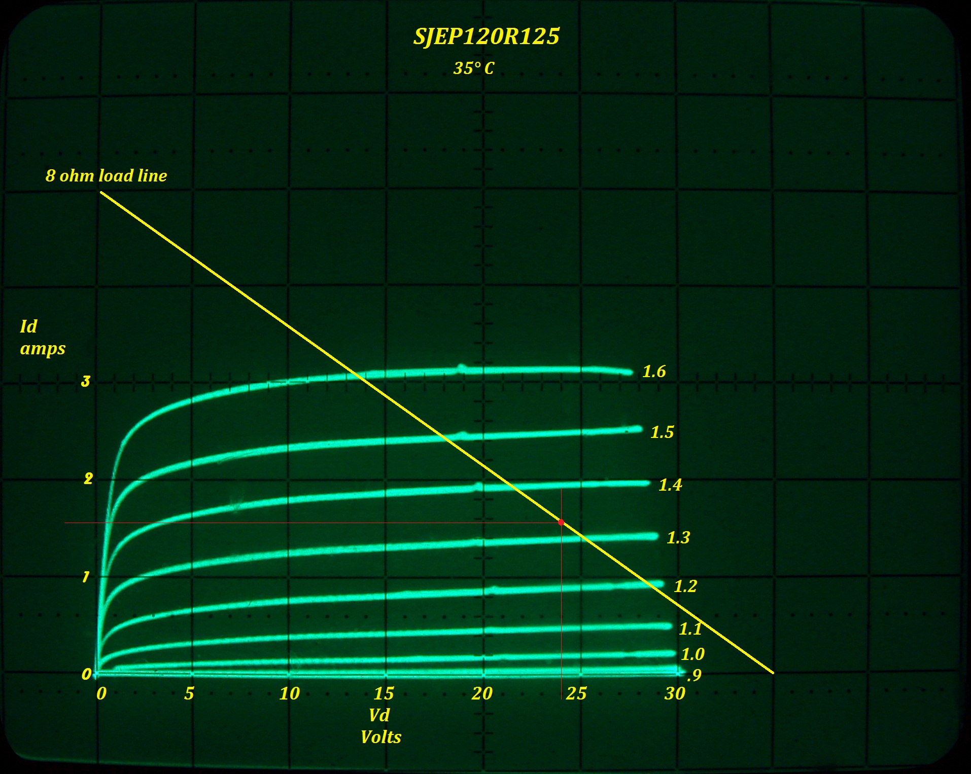

Must be.... I received some SJEP120R125's and ran one thru my home made curve tracer. I think the curves are very close and gives me an op point very close to what Pass talks about. Max Vgs swing is around .6v to .7v to remain in class A. It is quite cold in Los Angeles today and I was not able to get the transistor to go above 35 degrees Celsius. Tried heating it further with a small shrink wrap gun but it did not make a difference on the Id. I have the transistor on a large heatsink.
I did not capture the effect on the below curves, but going above 2 on the Vgs make the upper curves look bad as my tracer can't provide the required incrementing Ig.
