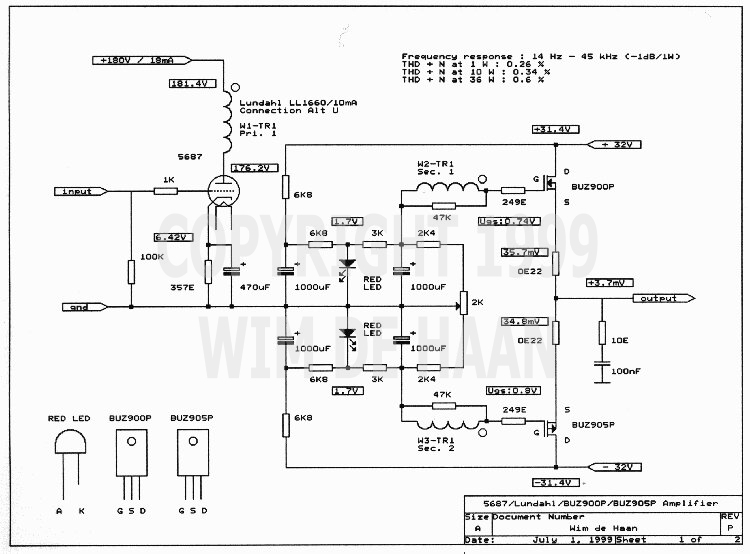

Wim DeHaan's design I posted is a complementary output design. Still a nice idea I will attempt...

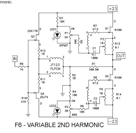

Build the F6 using Nelson's "F6 with Variable 2ND Harmonic" schematic with "ordinary MOSFETs" and the lower (maybe upper too) source resistor with a higher value like 0R47. The FET degeneration will be determined by the Zen pots P3 and P4, not the source resistors. BUT the bias thermal stability will be improved by the DC drop across the source resistor(s). My guess is that this will work without thermistors in the same manner as the many F5s built without thermistors.
Has anyone built an F6 with "standard" MOSFETs? What is needed for temperature stability? Will source degeneration be enough or will active thermistor control of the bias be needed?

In a past post regading ACA, this MOSFET was quoted to have a Gm = 2. Will additional voltage gain be needed in this version of diyF6?
I proposed in a past post of this thread the attached schematic in the event additional voltage gain was needed in diyF6. I already bought the PCBs from the DIYAudio store. I hope the schematic is useful for DIYers. One pending question hung: Where's one inject overall loop feedback in it?

I think I have the answer to that question and I am doing simulations right now.
Ilquam. I think you should try this layout with lateral fets. I started with them. It would be interesting to gt your opinion.
