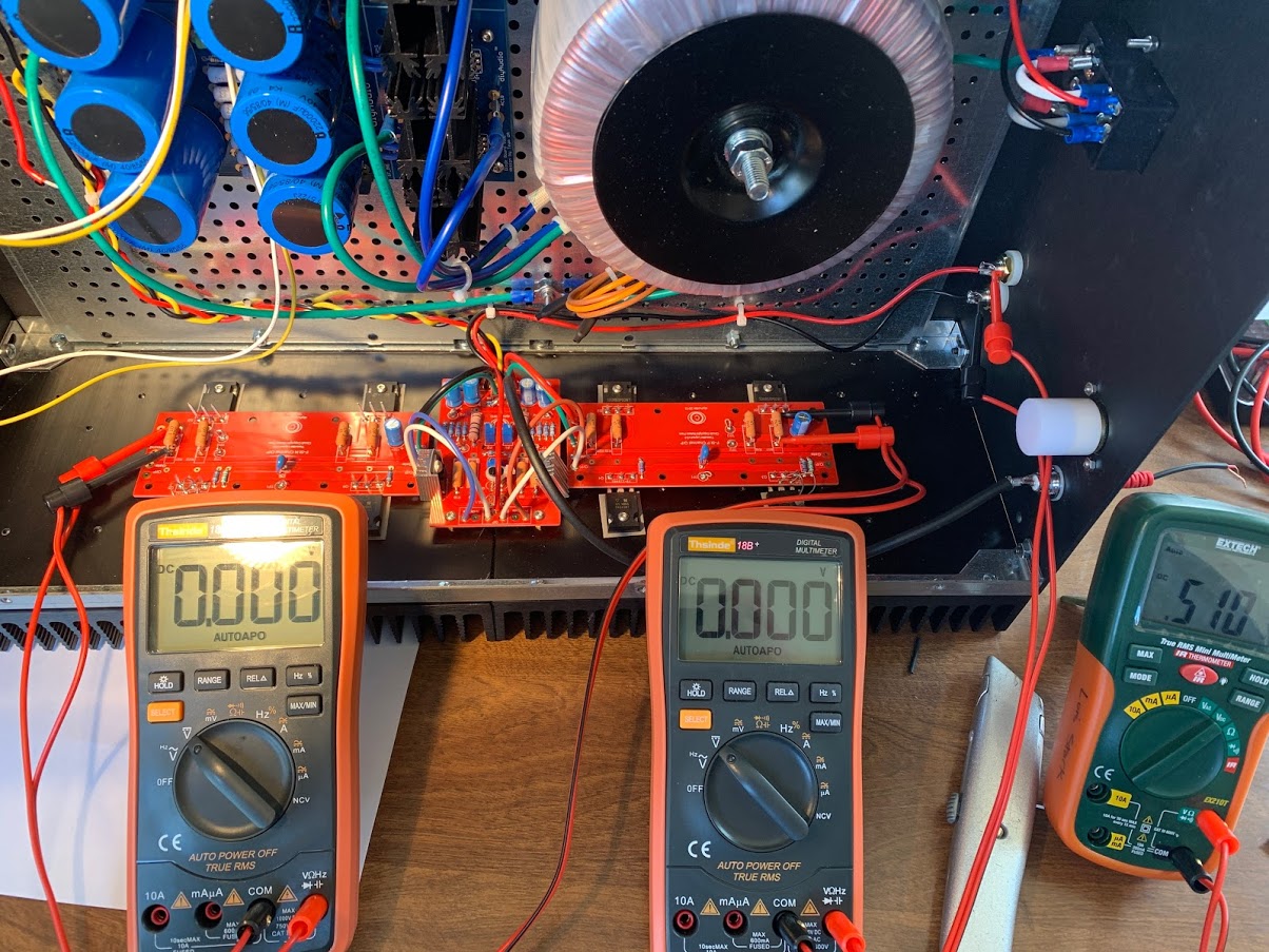

Pretty sure "source resistors" are R5 and R6. I checked them:place your DMM’s across your source resistors instead.
R5 0.4Ω
R6 0.3Ω
I cut off an old RCA cord, and twisted core with shield: shorted. Plugged one each into the Input, shorting signal to ground.Also, be sure to short your inputs if you haven’t allready.
Thank you @andynor!
done. (see above: RCA shorted signal to ground)1) Power off and short the inputs.
Done. Got R5 0.4Ω, and R6 0.3Ω.2) Measure the resistance across R5 and R6. They should be close to zero. If not, adjust P1 and P2 until they are.

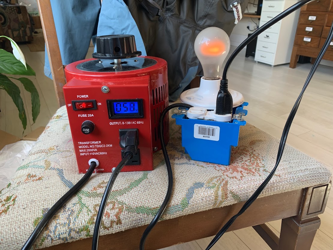

I didn't go to the full 119VAC. My dim-bulb was glowing, and I want to be sure it's safe to dial up voltage on variac.3) Power up again.
Still a bit nervous here, I dialed variac to: 57VAC, bulb glowing, 2.97VDC ST_V+ to ST_V-4) Check DC offset.
5) Check voltages across R5 and R6.
DC Offset (measured at speaker outs) 0.51VDC
R5 and R6 0.000VDC
At the same variac settings above, both R17 and R21 0.000VDC. Which I think is what we want when P1 and P2 are turned all the way down to 1.2Ω each (as low as they'll go at the 'click')6) check voltages across source resistors R17, R21. They should tell you about current going through the P and N half of the output stage.

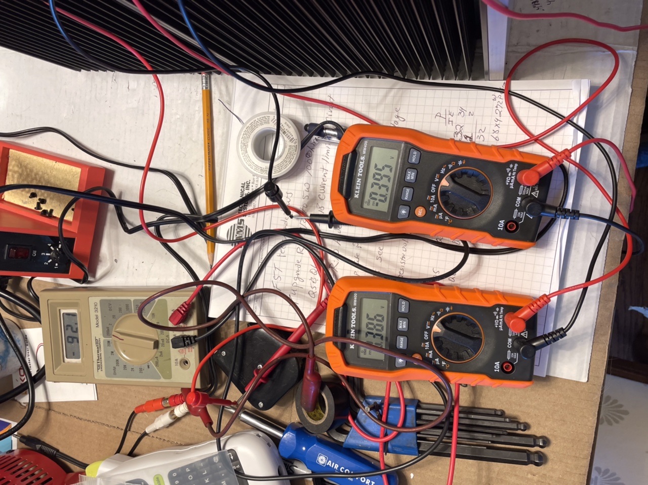

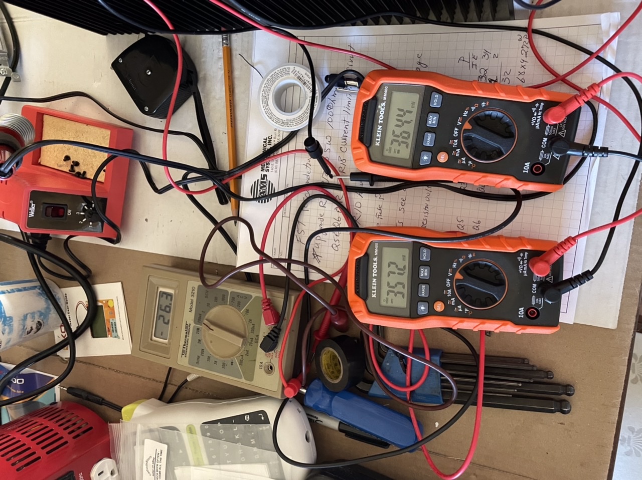

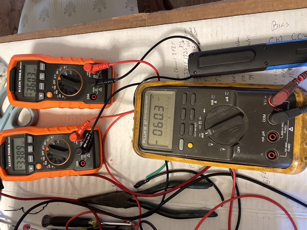

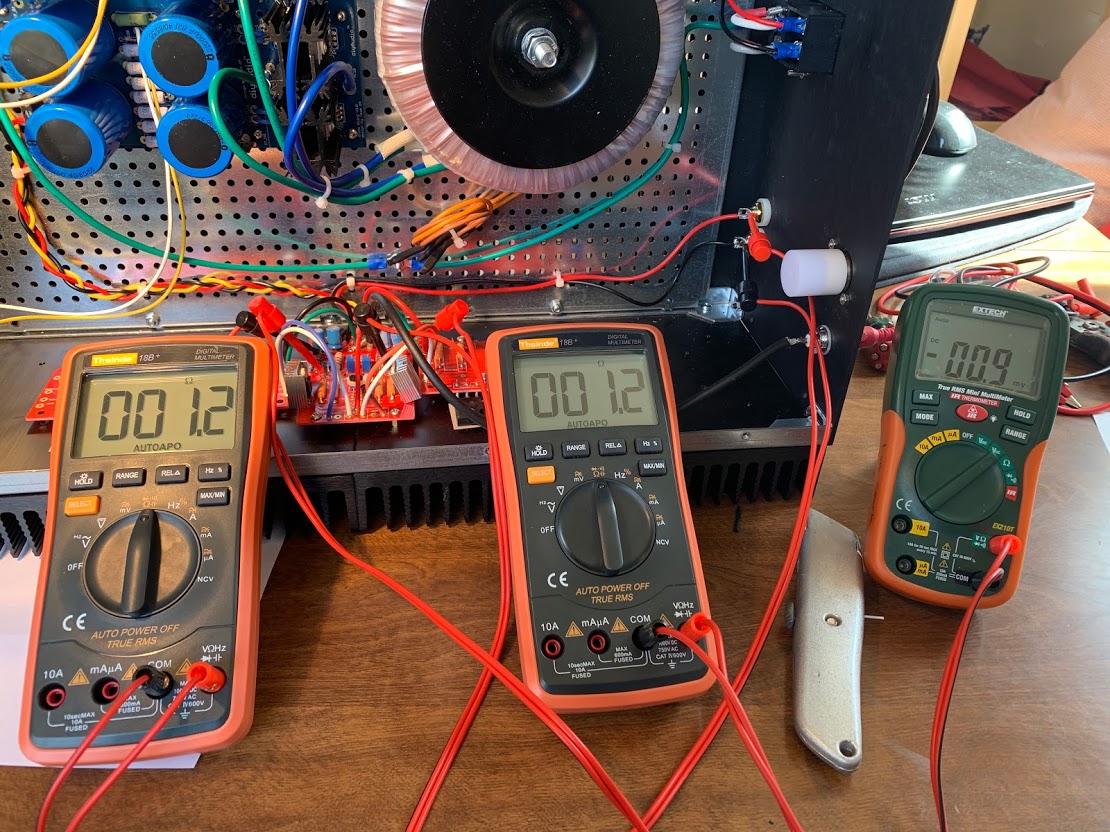

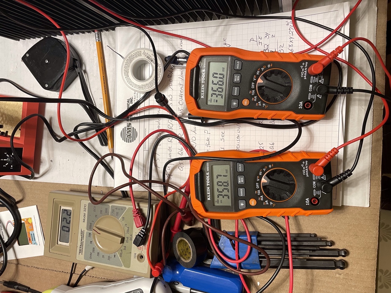

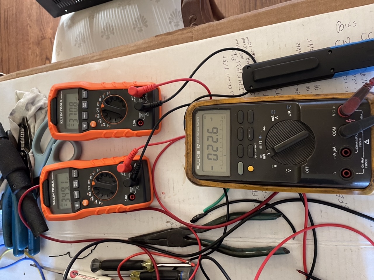

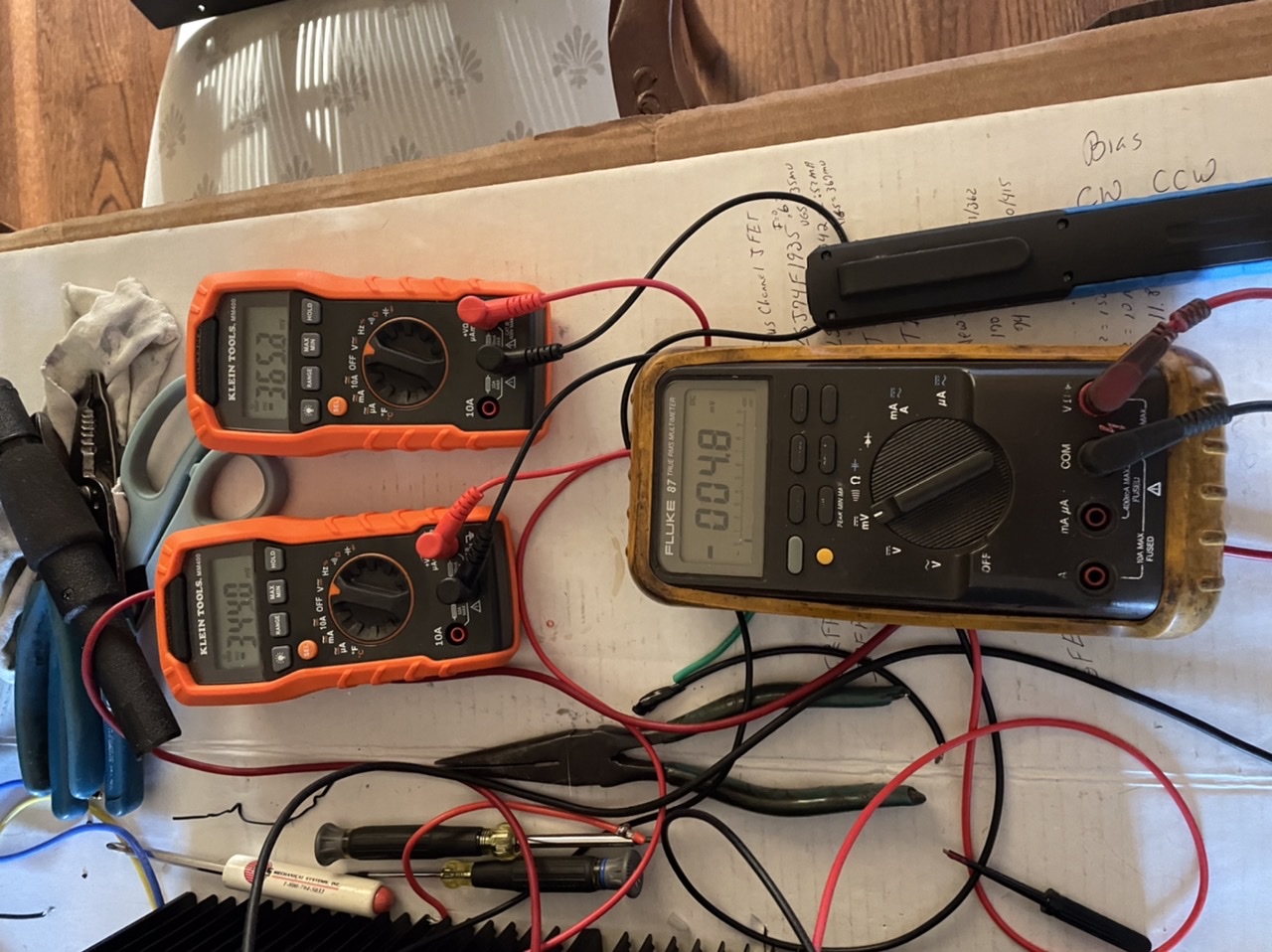

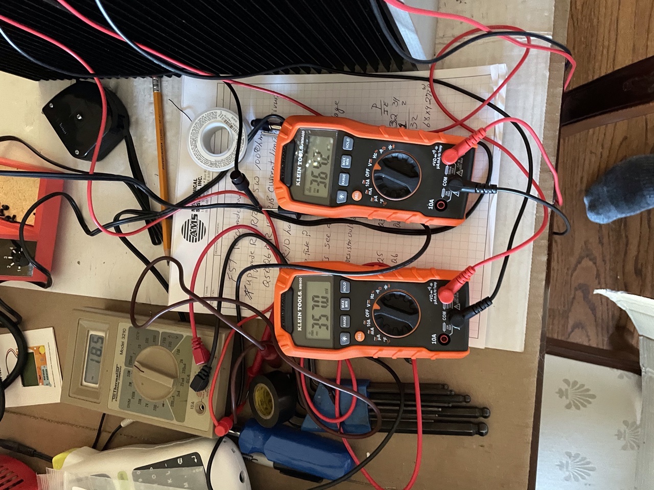

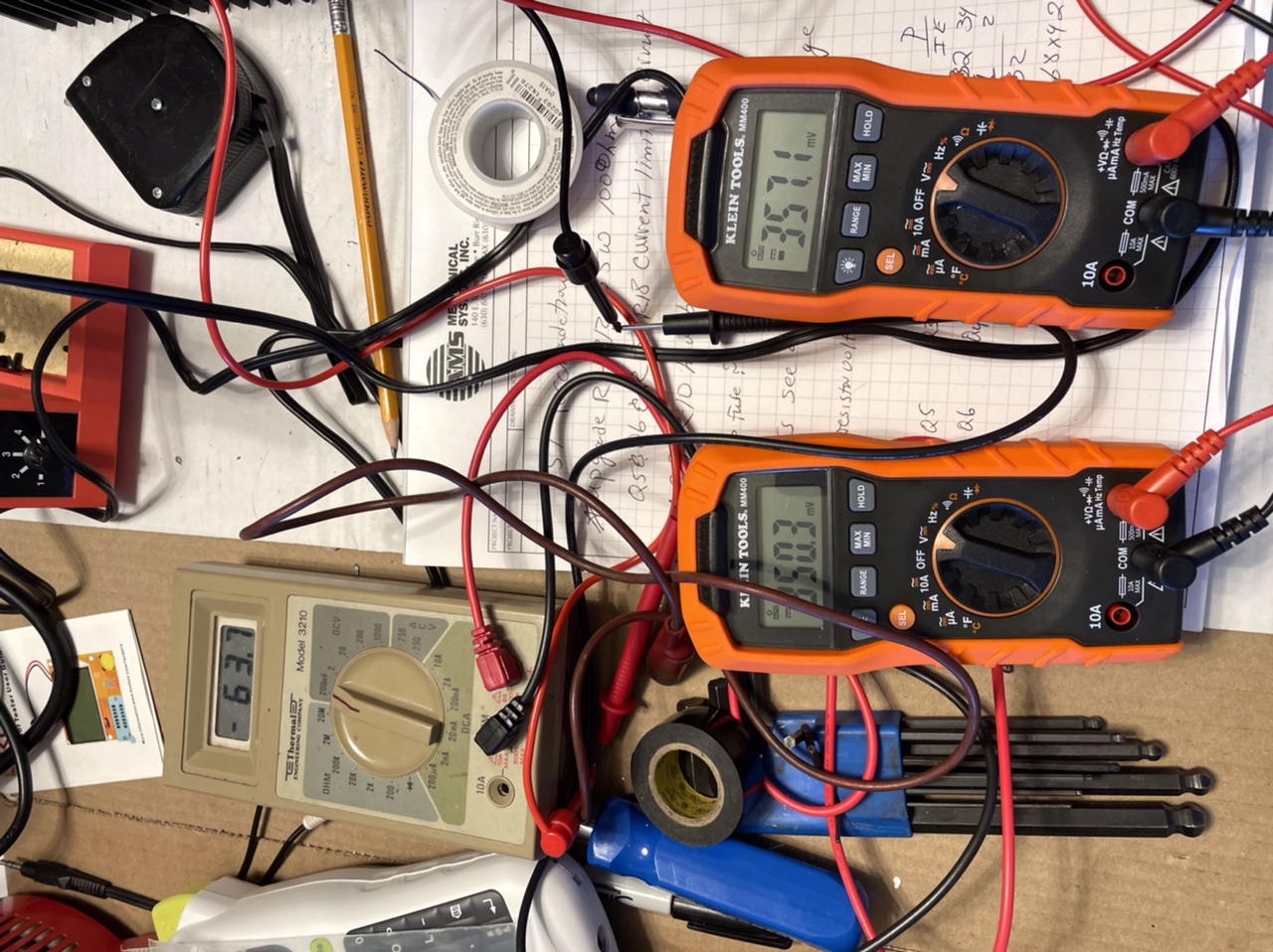

I wanted to share the info you maybe this helps explain my bias/offset situation. I’ve taken pics from the time I turned the amp on and every 15 minutes up to 3hrs. I uploaded the initial and some random in between. I documented the others for review. The (2) orange meters with the yellow Fluke meter is my right channel and the other (2) orange with the beige meter is my left channel. The yellow Fluke and beige Thermal are reading offset and the orange are bias.
Start up
Right bias- 410/388mv offset -114.3mv
Left bias- 395/386 offset -92.1
15 mins
Right- bias 360/338.9 offset -60.3
Left- bias 357.1/350.3 offset -63.7
30 mins
Right- bias 369.9/347.5 offset -51
Left- bias 360.6/353.7 offset -45.4
45 mins
Right- bias 376/353.9 offset -41.7
Left- bias 364.5/357.4 offset -34.1
1hr
Right- bias 383.3/360.9 offset -40.1
Left- bias 367.5/360.3 offset -25.7
1hr 15 mins
Right- bias 370.8/349.1 offset -22.6
Left- bias 364.4/357.2 offset -26.3
1hr 30mins
Right- bias 364.5/343.2 offset -8.3
Left- bias 363.8/356.7 offset -19.3
2hr
Right- bias 365.2/344 offset -4.8
Left- bias 364.2/357 offset -18.5
3hrs and I adjusted left channel @ 2.5hr
Right- 364.5/343.4 offset 3.5
Left- 366/358.7 offset 2.2
Any thoughts?

Thermal equilibrium takes a long time to occur, it's a big chassis and everything needs to get to final temperature.
This is completely normal.
