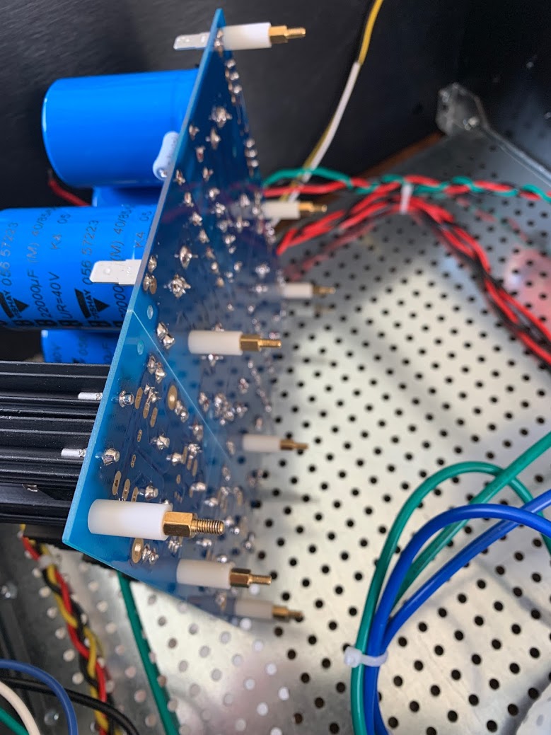

Still a bit nervous here, I dialed variac to: 57VAC, bulb glowing, 2.97VDC ST_V+ to ST_V-
DC Offset (measured at speaker outs) 0.51VDC
R5 and R6 0.000VDC
So you have the variac at 57VAC (about 1/2 AC voltage) and you have less
than 3V DC between V- and V+ on the PS board (so about 1.5V between
V- and GND, and 1.5V between GND and V+)? Am I understanding
that correctly? If so, and assuming there's been enough time for the caps to
charge up, it does seem there's a short somewhere.

Did you use the dimbulbtester to check the PSU alone (without the frontendboard + outputboards connected) for faults?
Have you checked your voltages out of your PSU before you connected your amp-boards? What have been the values? +voltage referenced to ground and -voltage referenced to ground.
As long as the dimbulbtester doesn't dim down/goes off - there is something wrong.
I would disconnect my amp boards from the PSU and would check the PSU-voltages first. With focus on their symmetry (+Vout PSU = -Vout PSU).

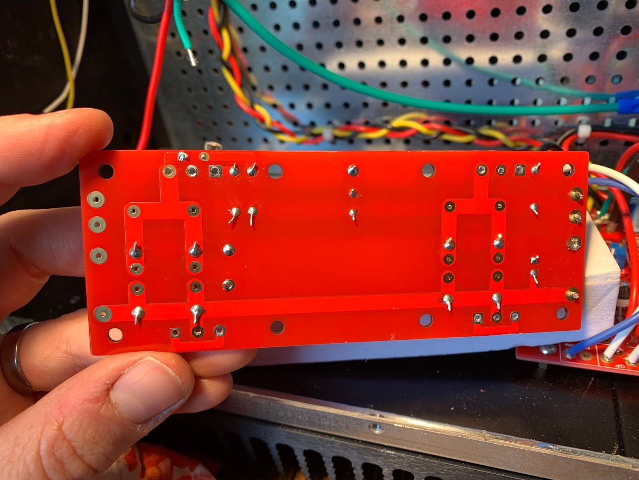

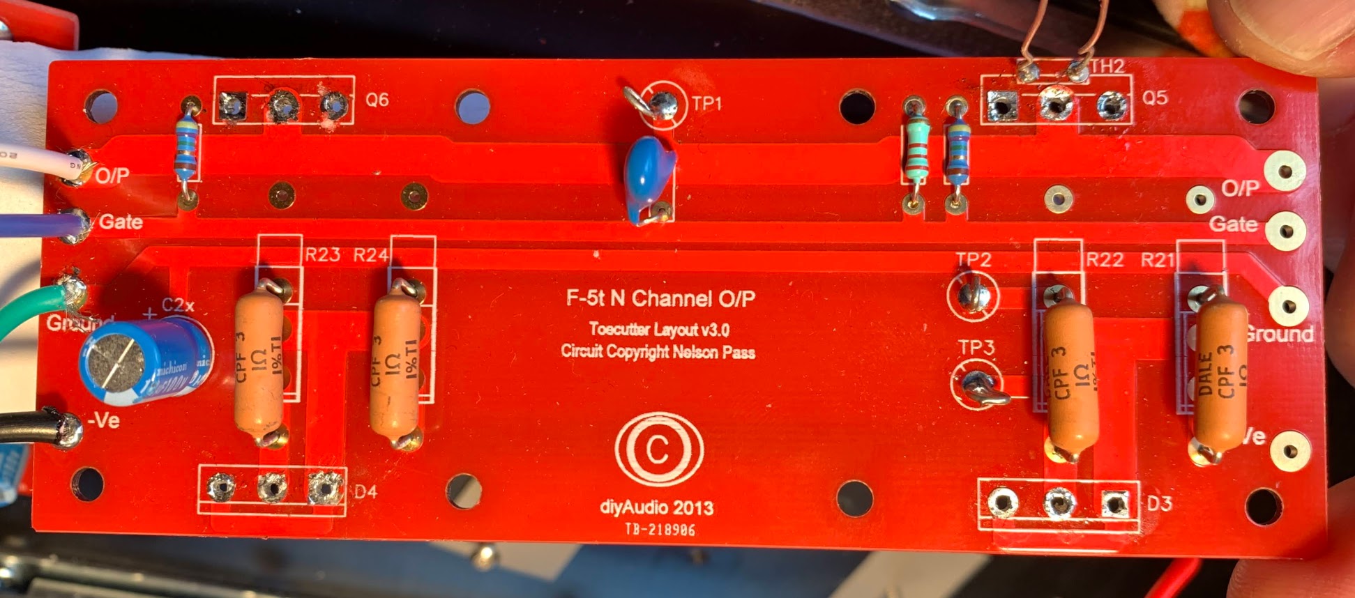

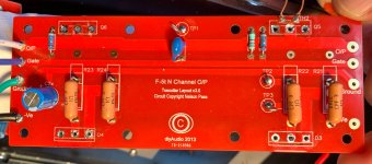

The one thing I did find was a misbehaving Left N-channel board.
LEFT CHANNEL
Variac at 17VAC, ST_V- to ST_V+ 2.55VDC, dim-bulb in circuit
N-ch TP2 to TP3 -0.141VDC
P-ch TP2 to TP3 0.000VDC
Variac 000VAC
FE-board TP1 to TP2 1.3ohm
FE-board TP3 to TP4 1.2ohm
Variac 017VAC, ST_V- to ST_V+ 2.55VDC
FE-board TP1 to TP2 000.8ohm
FE-board TP3 to TP4 1.5ohm
return Variac to 000VAC
FE-board TP1 to TP2 1.2ohm
Variac to 18VAC, ST_V- to ST_V+ 2.56VDC
DC offset at speaker out: 0.449VDC
RIGHT CHANNEL
Variac at 17VAC, ST_V- to ST_V+ 2.54VDC, dim-bulb in circuit
N-ch TP2 to TP3 -0.000VDC
Variac 000VAC
Variac 017VAC, ST_V- to ST_V+ 2.56VDC
FE-board TP1 to TP2 1.7ohm
Variac to 18VAC, ST_V- to ST_V+ 2.55VDC
DC offset at speaker out: 0.438VDC
I double checked the measurements that I put in BOLD above, and they are correct.

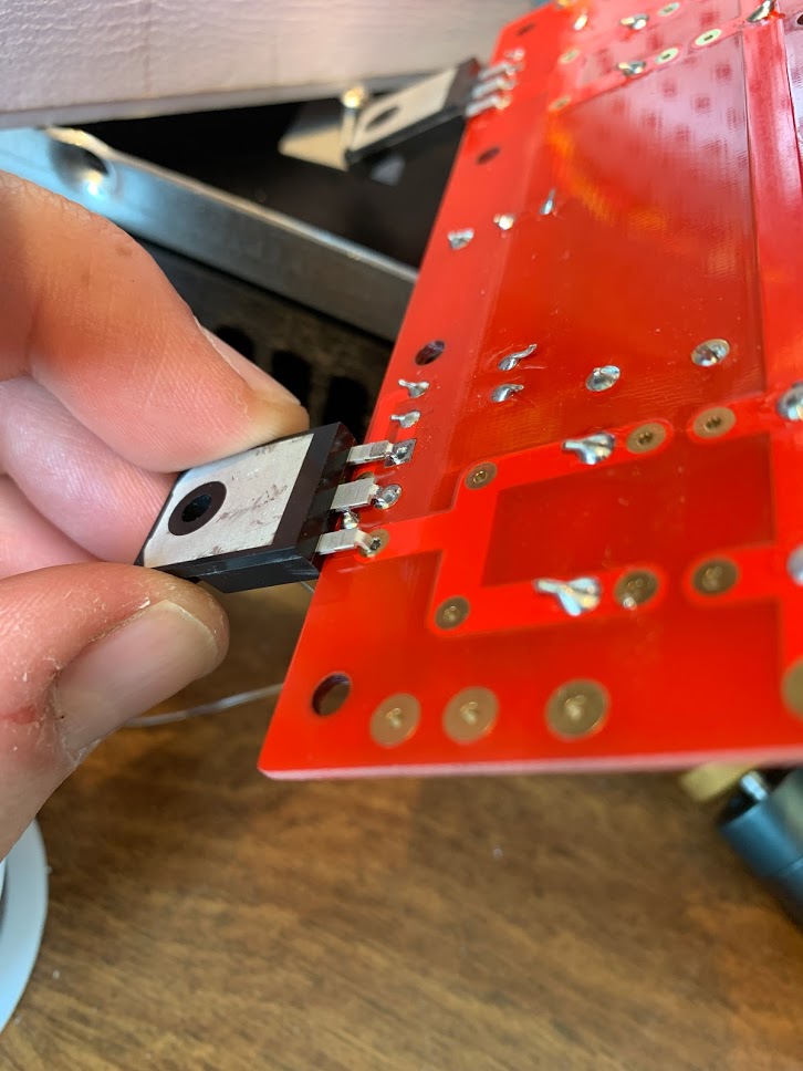

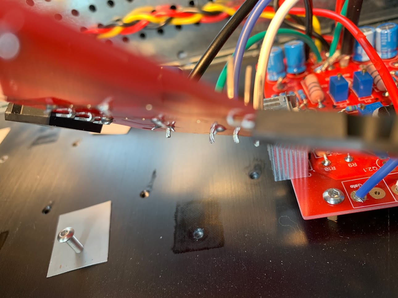

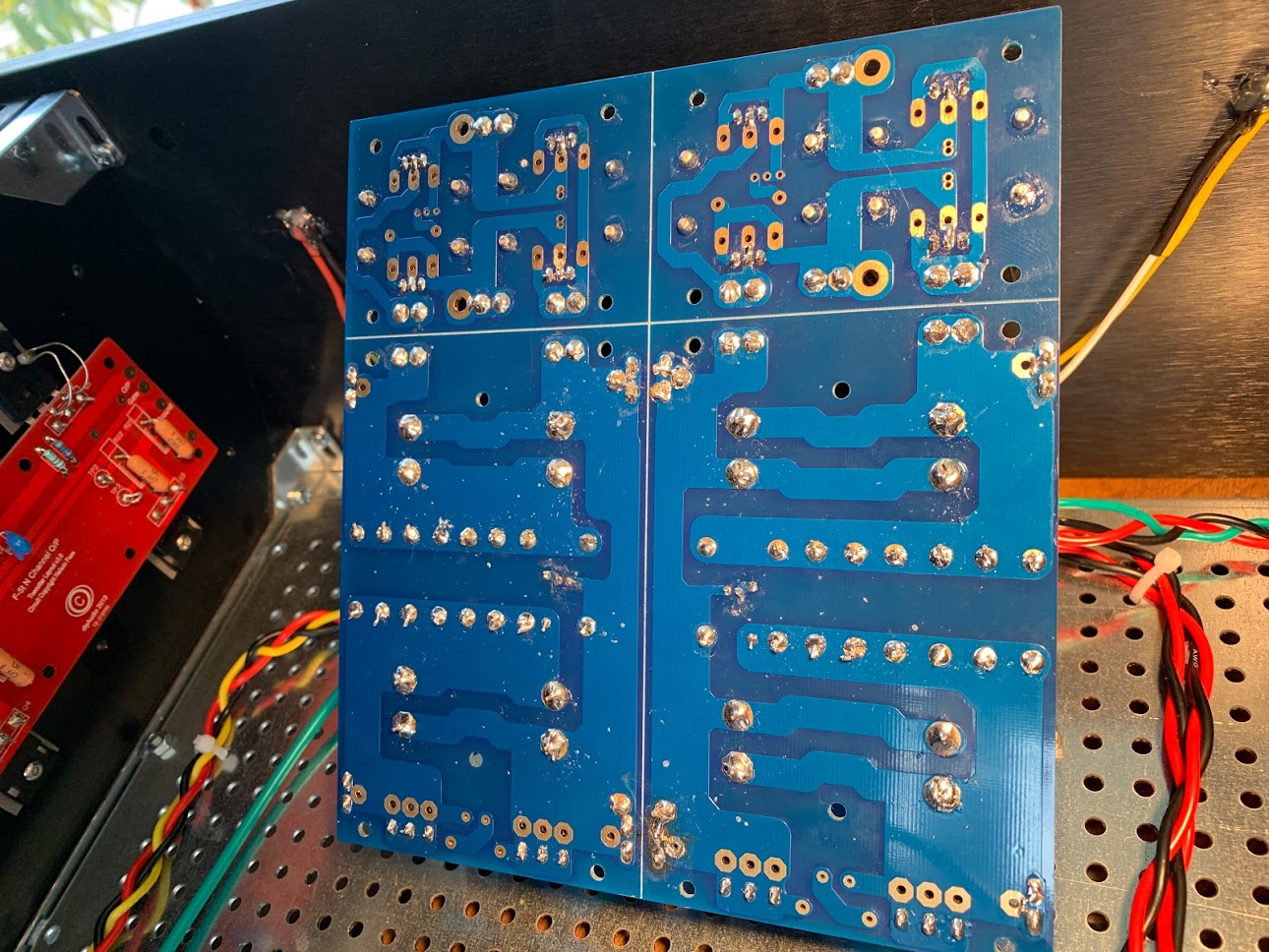

Also of note: I checked the underside of one of my N-ch boards, and it's possible the thermistor was touching one of the FET leads. I pulled the FETs, and remounted them all higher up to confirm they are not shorted.

On your Left-N-ch-outputboard you measure -0,141V DC over the bias resistor
(=TP2 - TP3). There is something wrong. Should be 0V (or very close to).
Have you checked your N-ch-Mosfets when you pulled them out?
Do you have a little Device -tester like the Mega 328 or Peak DCA75?
You could also measure at the Mosfet-legs (N-ch) if you have a low resistance to ground or to the heatsink. 😕
