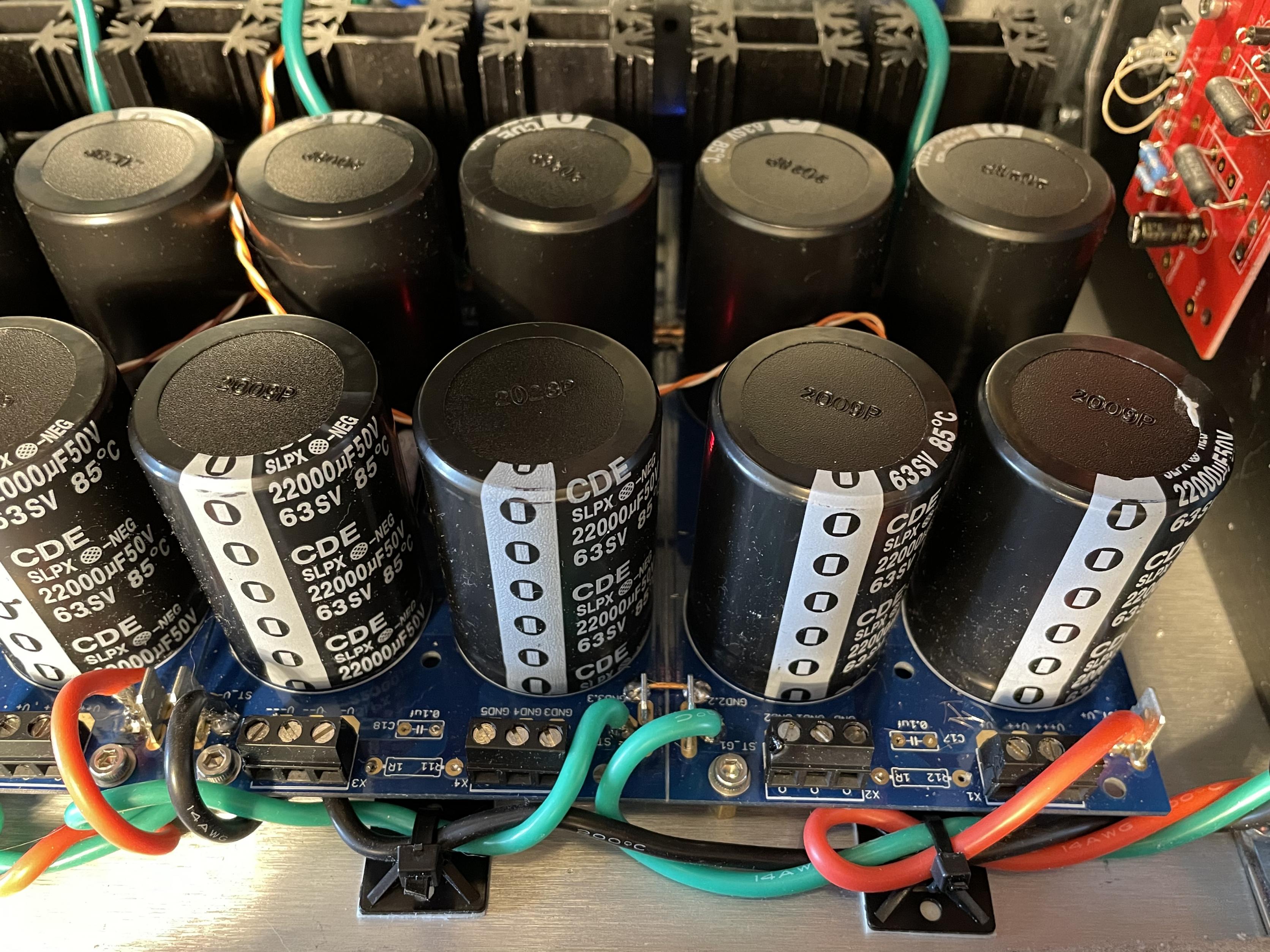

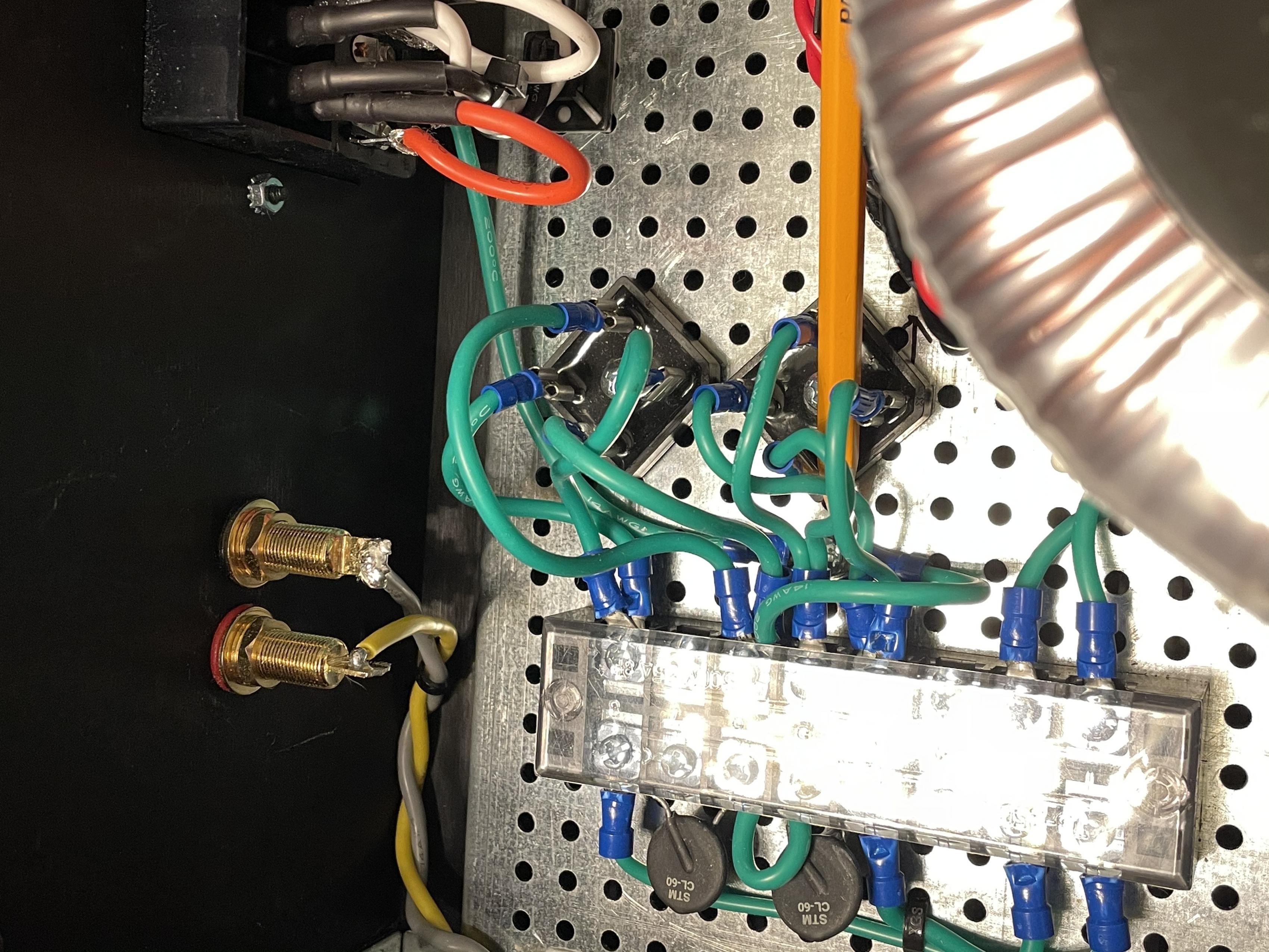

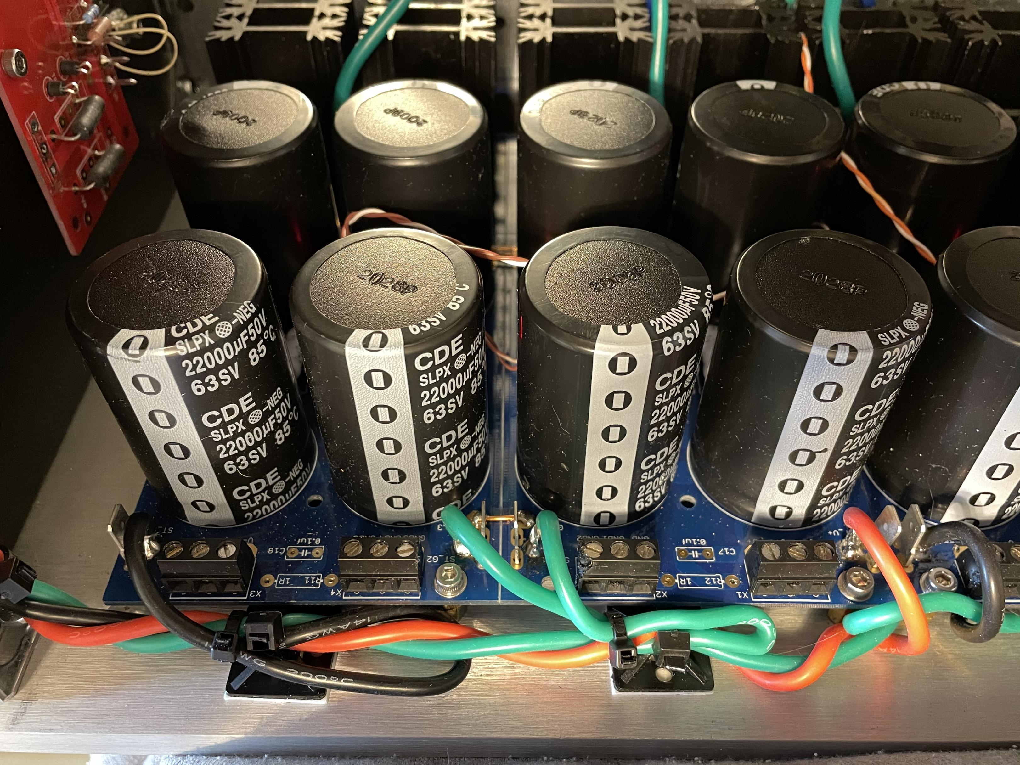

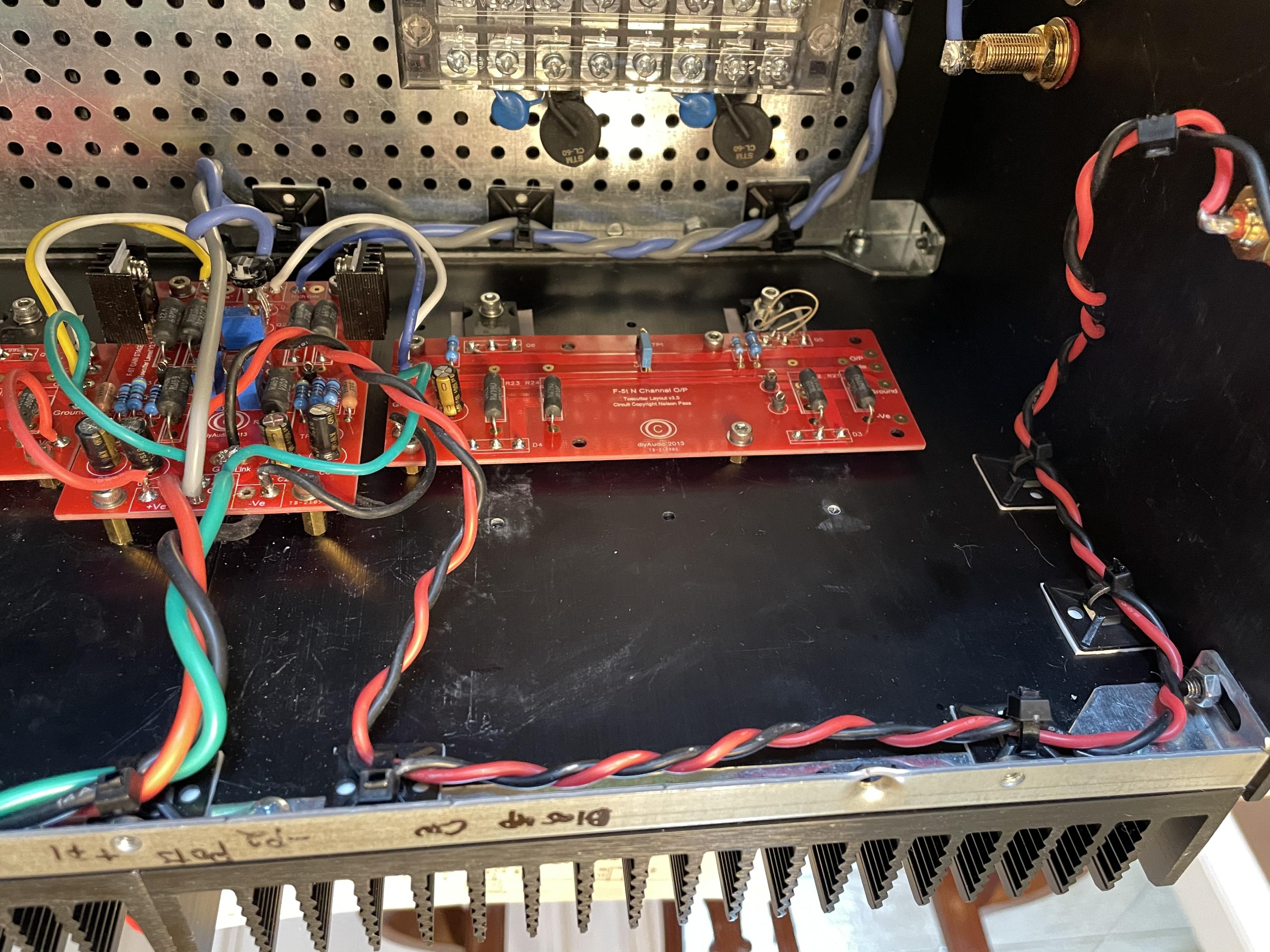

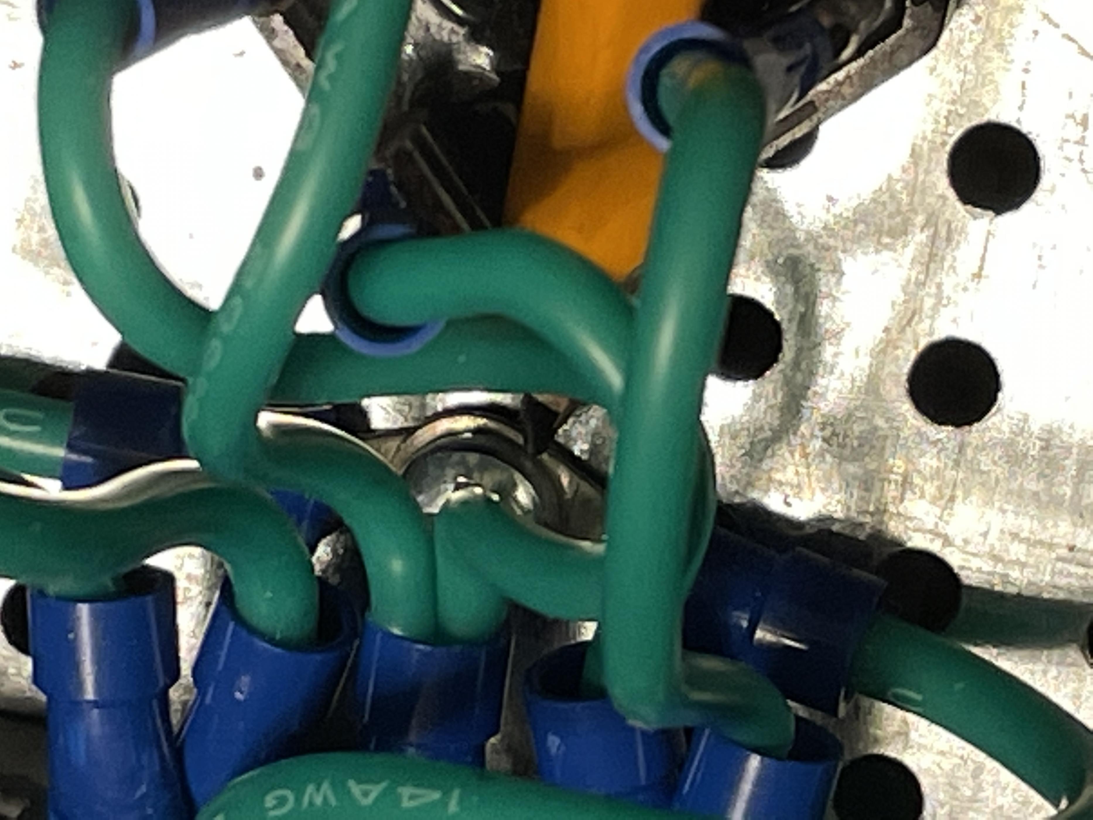

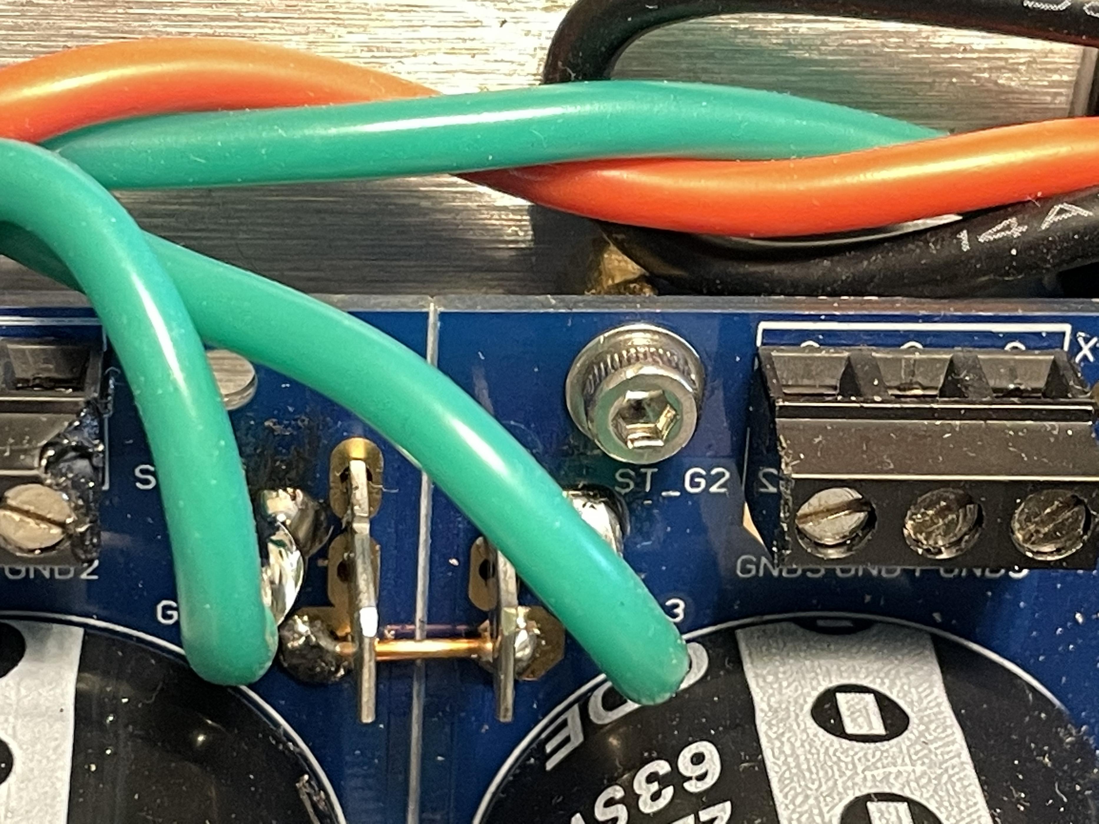

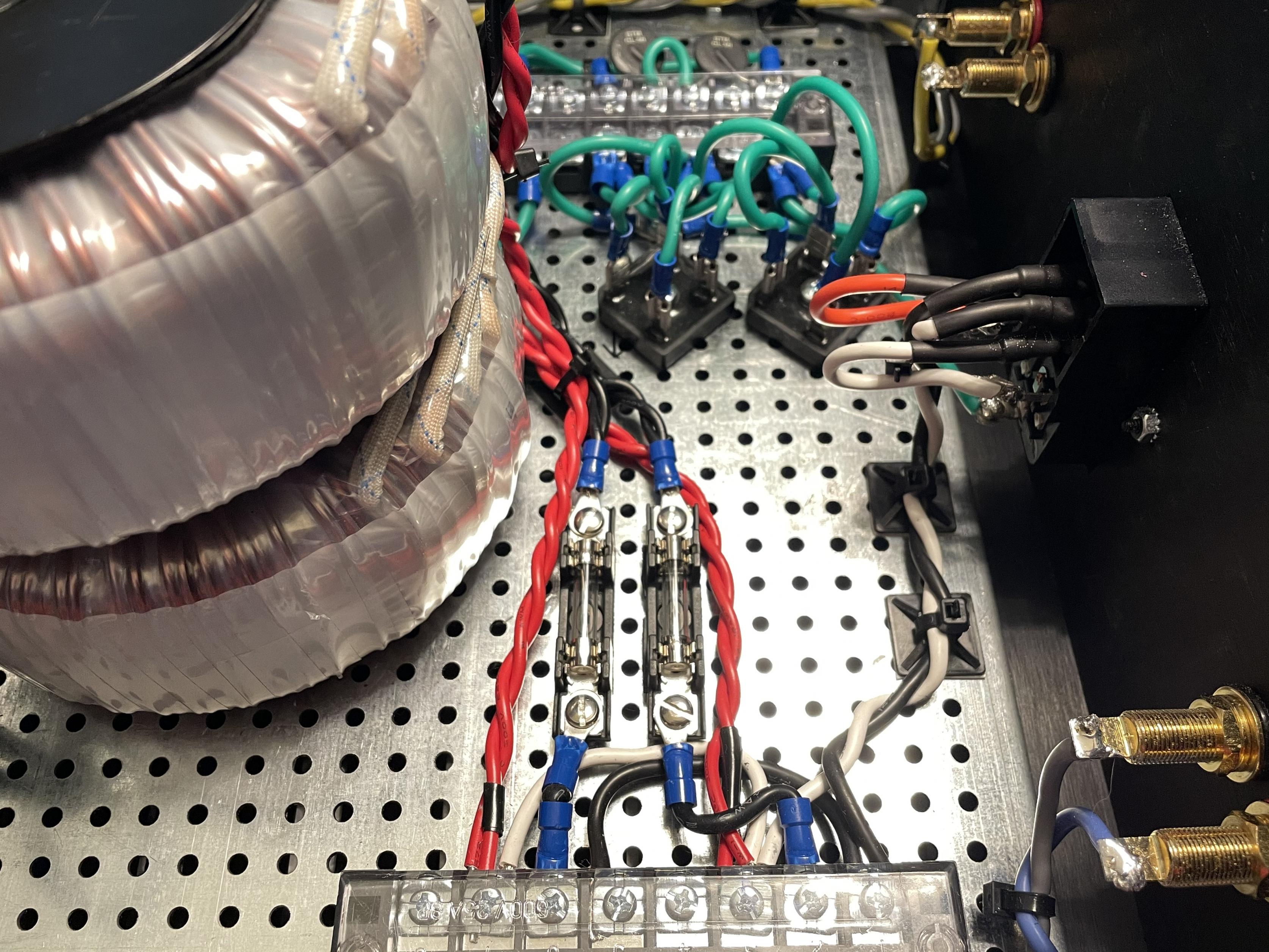

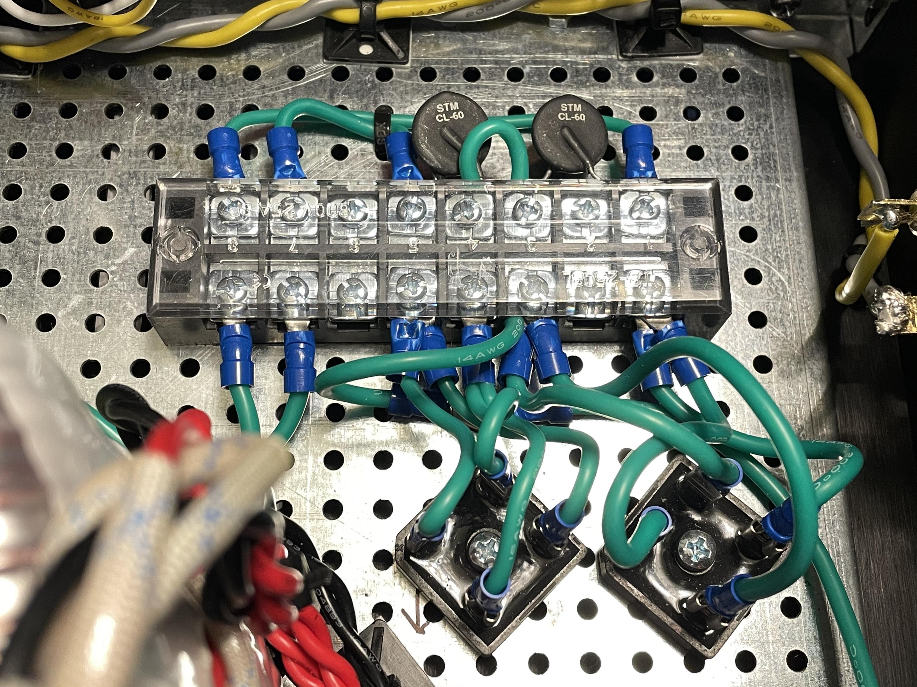

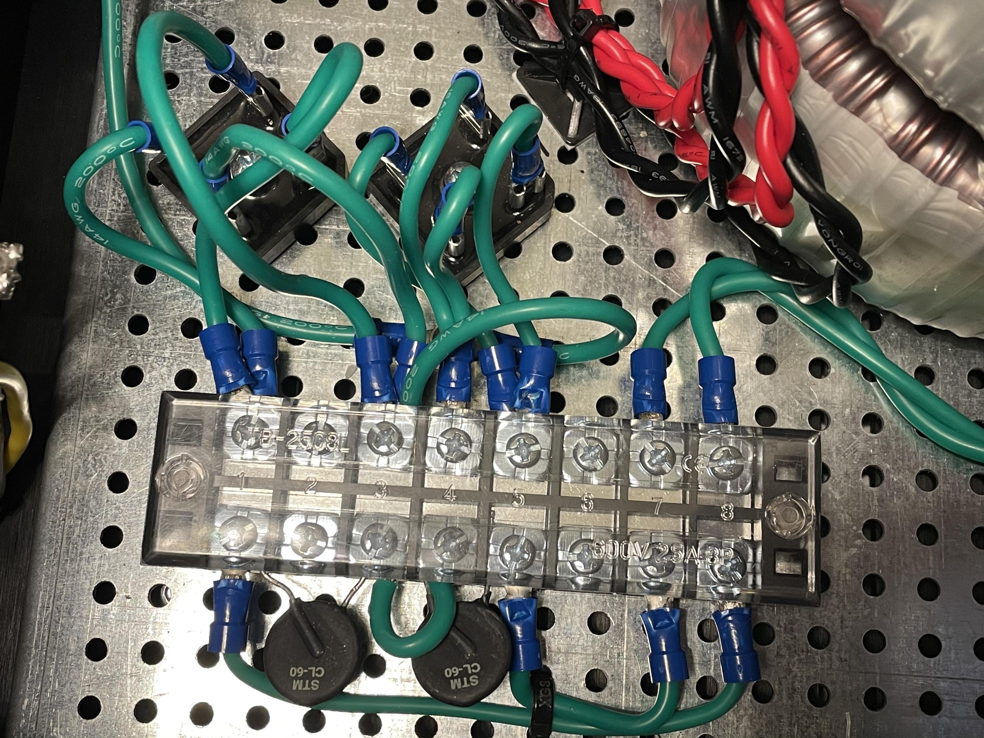

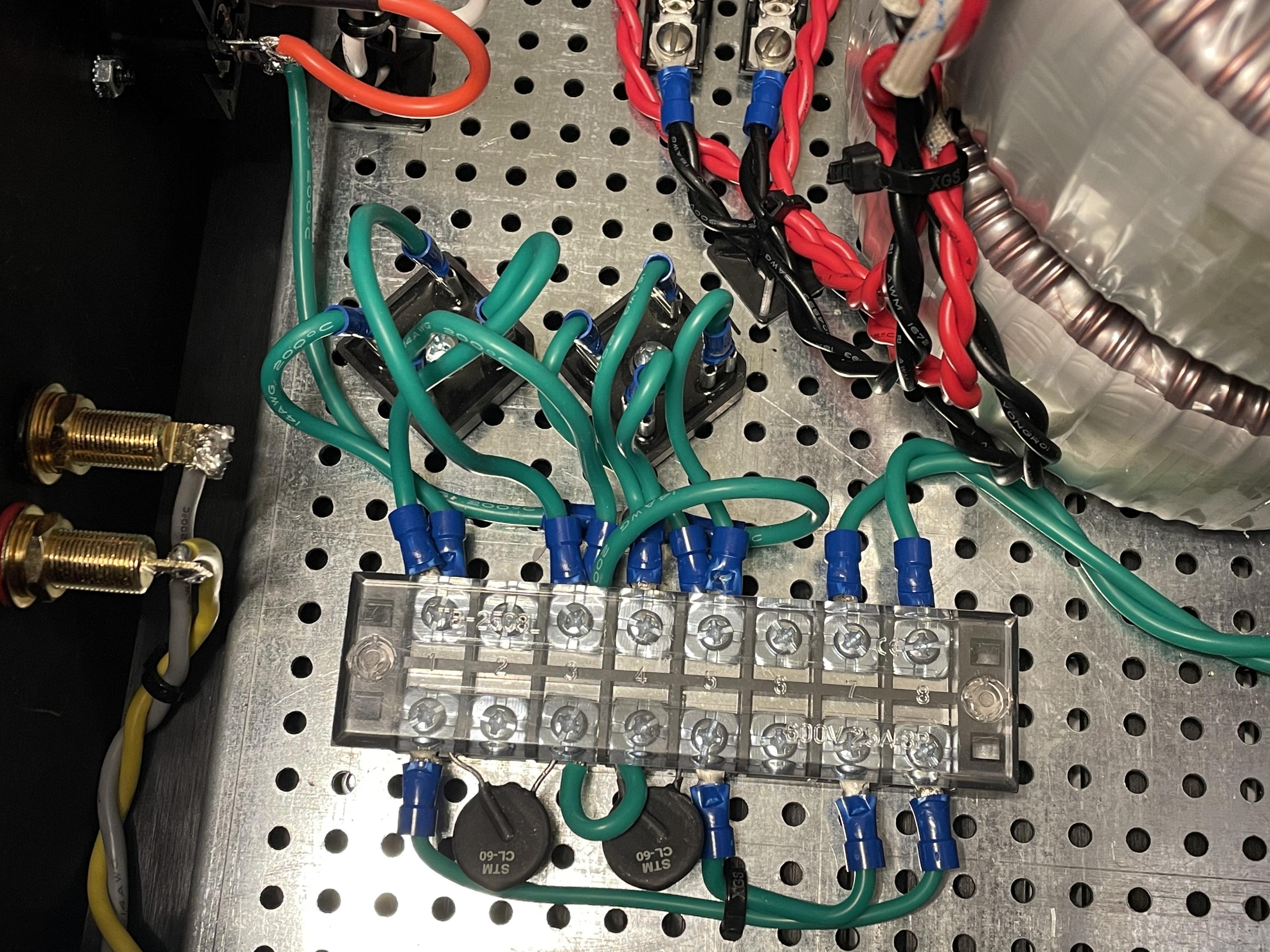

Good morning guys, I got up and made the wiring changes inside the F5T adding another lifting bridge and CL60. I still have the slight 60hz hum in the right channel. Left channel, totally silent. I’ve included some more pics.

Hi, Luvrockin!
Sad to hear the change made no difference. I kinda thought as much, given the tranny turning worked... any more headroom to turn the tranny even more?
Luckily there is always room for change! Lovely part about the hobby.
Yesterday I said something about differences between the two sides of the amp as a good place to start. I see that your AC connection block is very close to the right channel outputs. Ideally, of course, AC lines should run along the middle of the amp. That is often not possible.
Might I suggest you attempt moving the connection block a bit, or maybe trying to cover it with some metal that at the same time touches the chassis? The last suggestion is risky and might not work at all, but loosening some screws and cutting some zipties will be enough for this test. Intention here is to see if there is any difference at all in moving it away from the output or not.you can override the fuses to ease the test.
If this makes a difference, you might have a loop area somewhere picking it up. But we can get back to that.

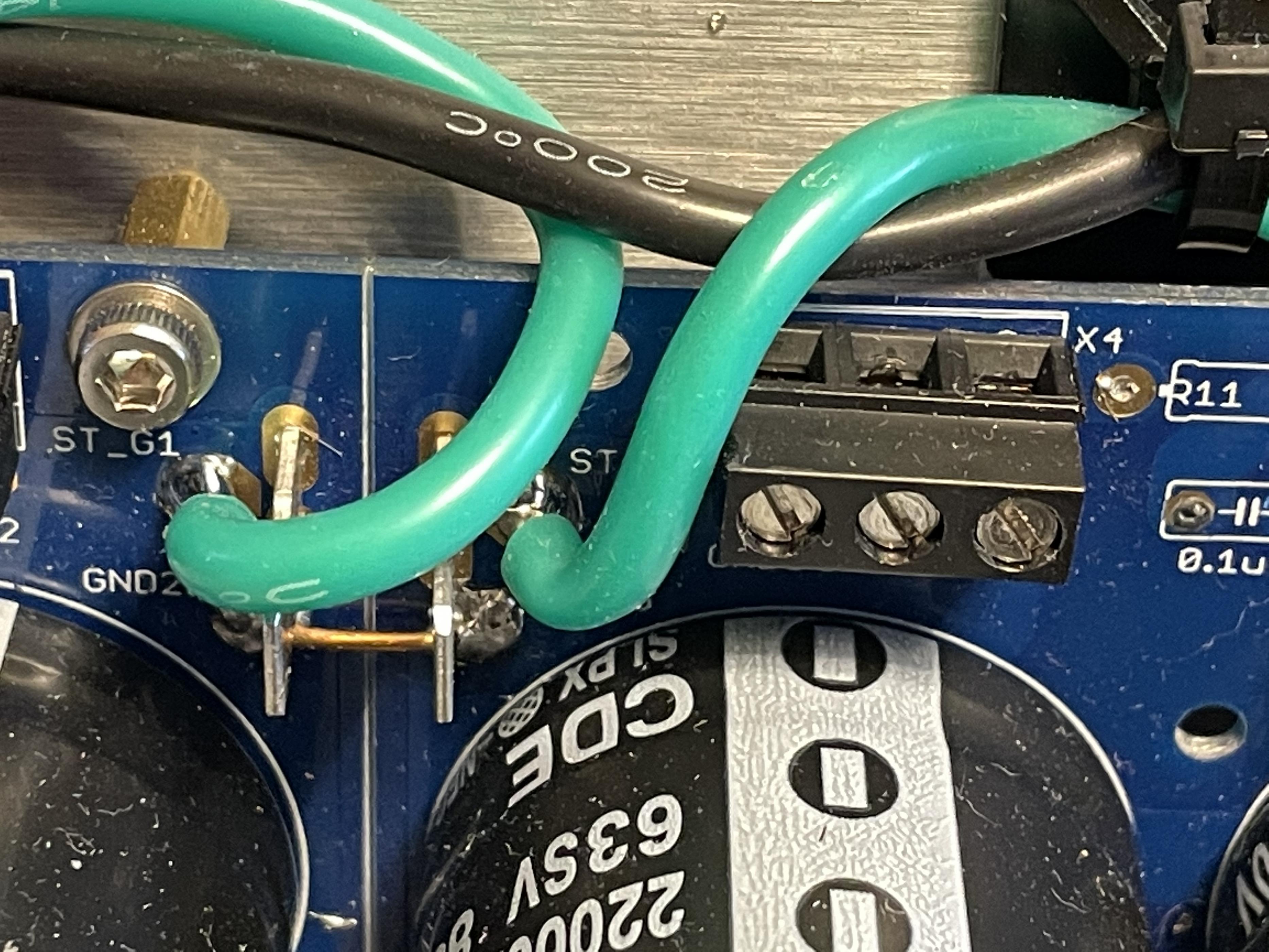

Do also consider cutting the amp board gnd wire off the PSU, and connect it instead to different places out of the six spots in the euroblocks. If this make a difference, you might have a common impedance issue.
If turning the bias down reduces hum, it is indicative of the same issue. But important here is that it pertains only to one channel. That is the place to start.
Lastly: are there any other visible differences between the two amp halves? I am thinking the physical dimension here.

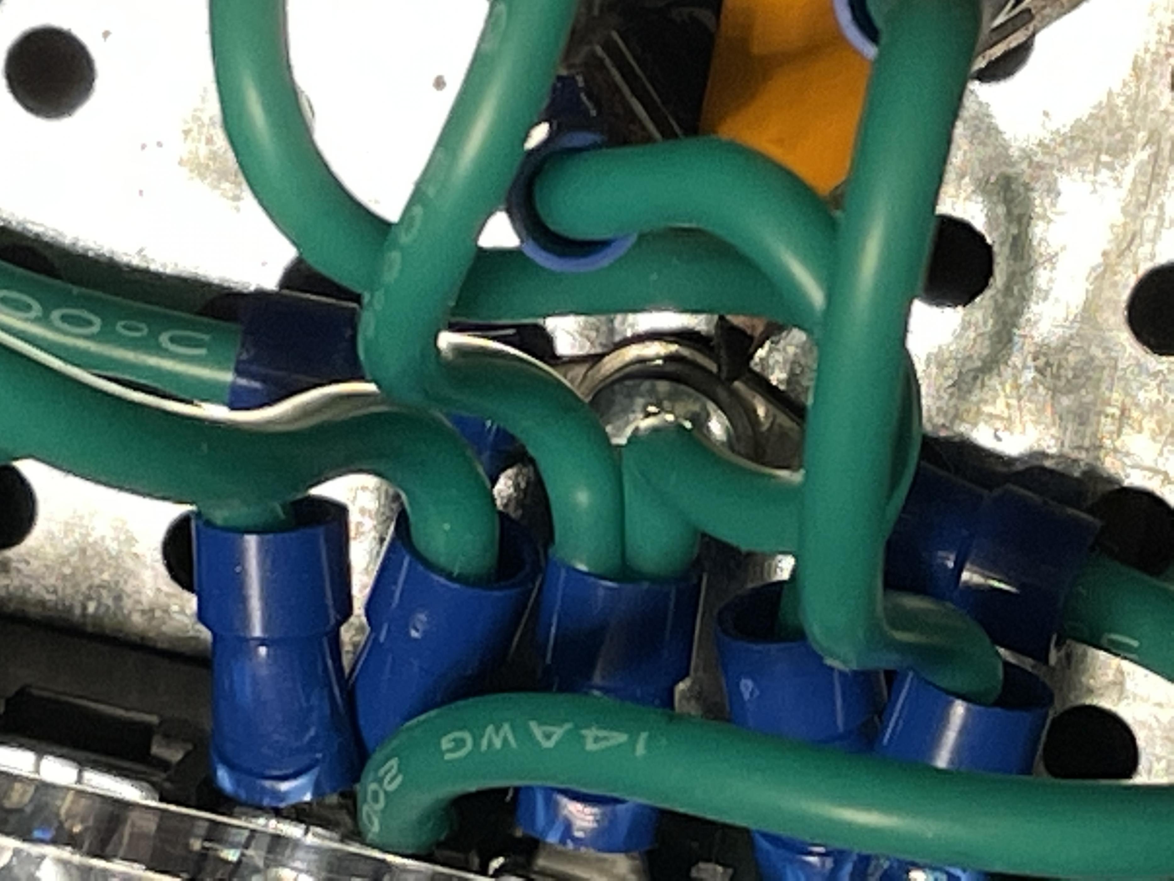

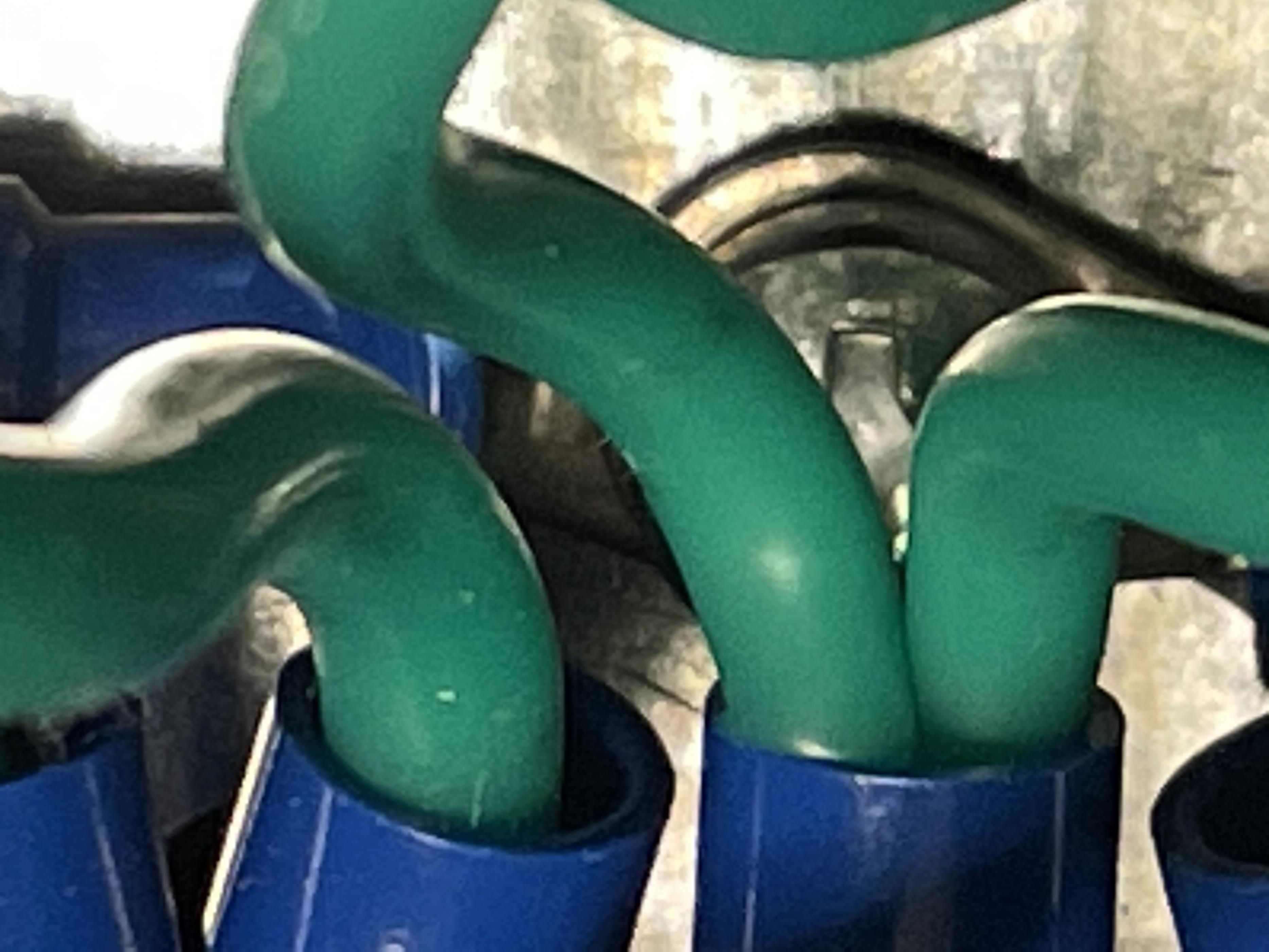

Hmmm. Where is your chassis star ground? I can not from the pics see the point in the chassis where the IEC inlet/safety ground is attached to the chassis. If it is not, it is floating.
It should be connected straight to the chassis floor, not through a connection block.

Dirk, very nice!! Andy, gonna give those a shot especially moving the block because that is right by the right channel. Possibly an excellent catch. If not I’ll go after the other suggestions. Also I’ve added a couple more pics. The star is under the whole pile of crapola, but it’s there. Check it out
Ahaaaa, there it is. Theres the proof, my eyes were deceiving me. Sorry for thinking you could have forgotten that.
And good luck with it all! It is very rewarding when you get hold of the hum source.

Hi, Rockin! Sorry to hear that, but also informative with locating the source.
Just a quick one: have you tried swapping PSUs between channels? Iow, disconnecting and putting the left psu to the right amp boards and vice versa?
That would help isolate the error further. Also, try putting your hand on the tranny and applying some pressure, and or tighten it down a bit more, just to see if it makes a difference and whether the hum is mechanical or caused by something else. Sangram AC offset test is very good. I’d follow his advice, always.
Also, you mentioned increased hum when moving amp gnd wire away from 0v junction. This is a little bit strange, but might maybe enlighten some of the smarties in here in finsing the issue.
I wiuld also try putting a wire with quickcons across the blades at the junction, just to see what less impedance between gnd plane halves do for you.
PS: to check if your chassis is floating, try turning on without a source and UNSHORTED inputs. Note the hum level. Then short input and compare. If the hum is louder with unshorted inputs, much louder, chassis might be floating. But it can be other things as well, but this test might help finding the fault =)
