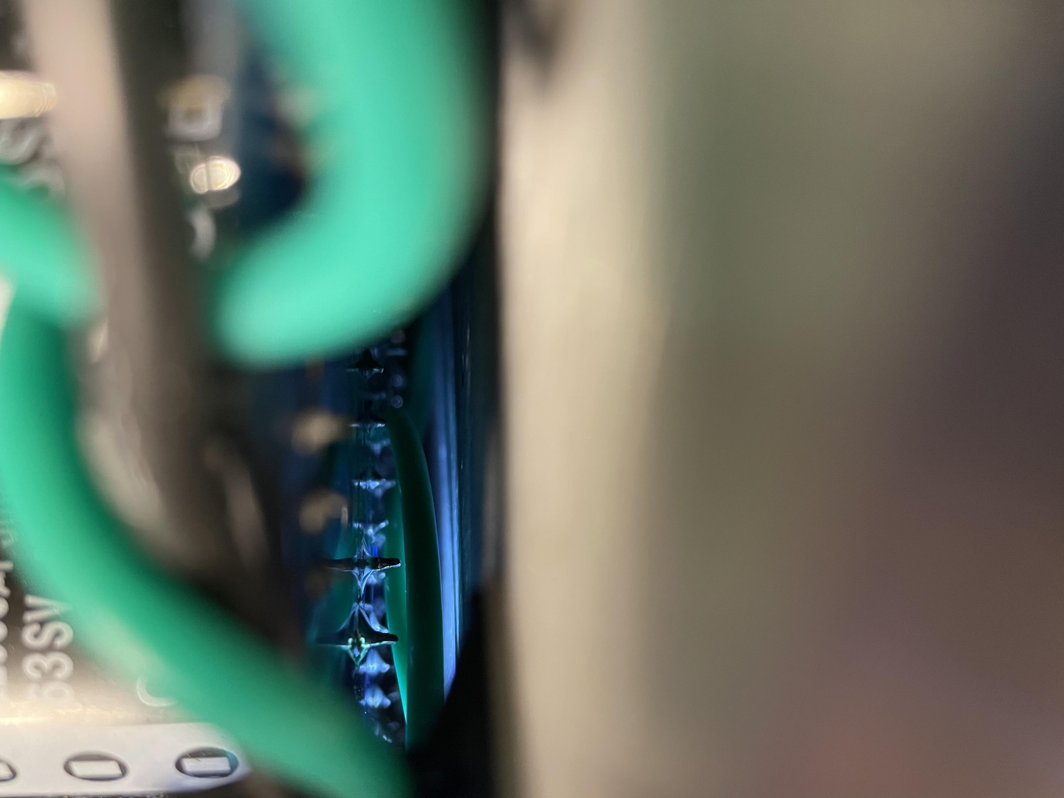

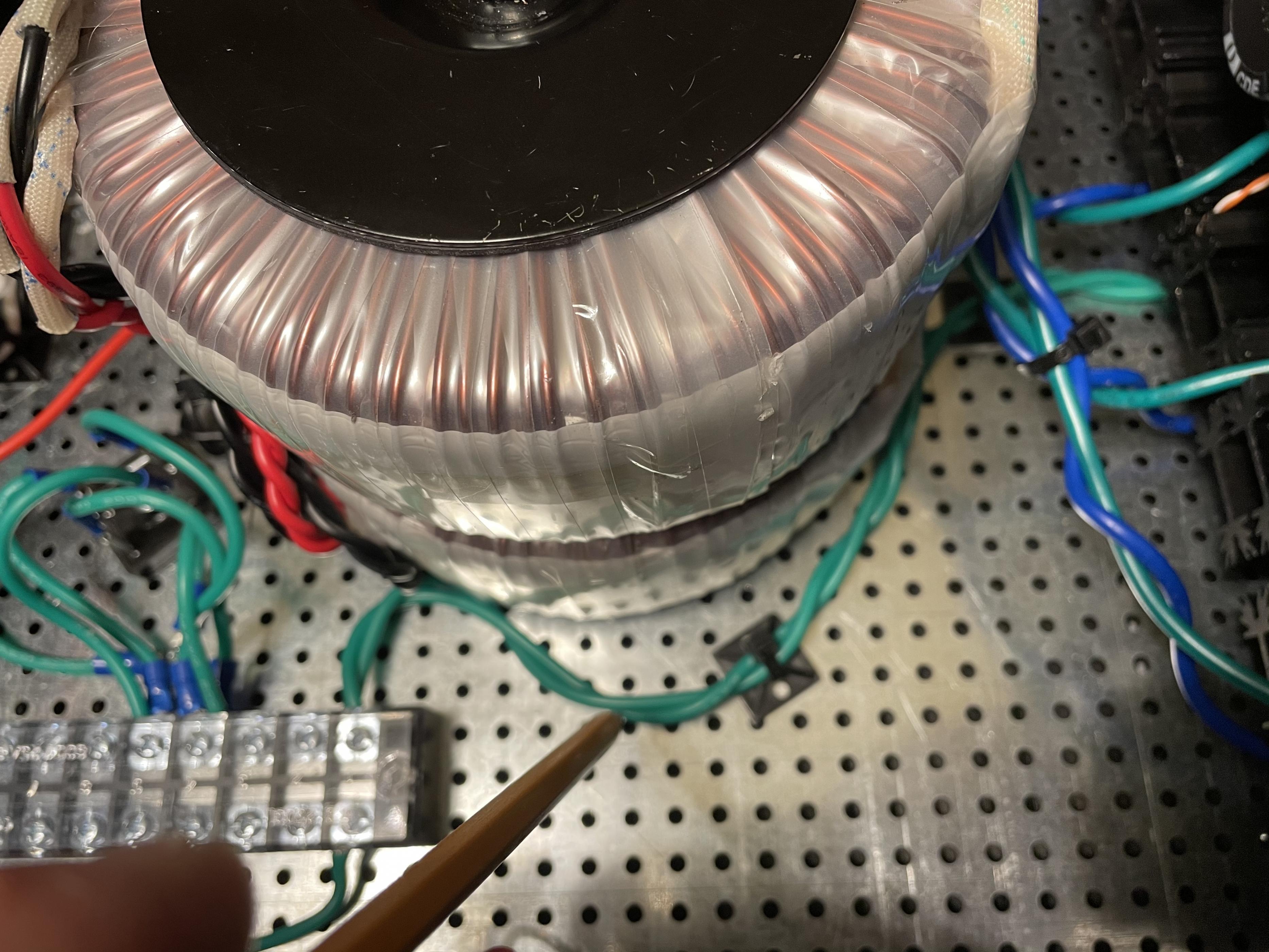

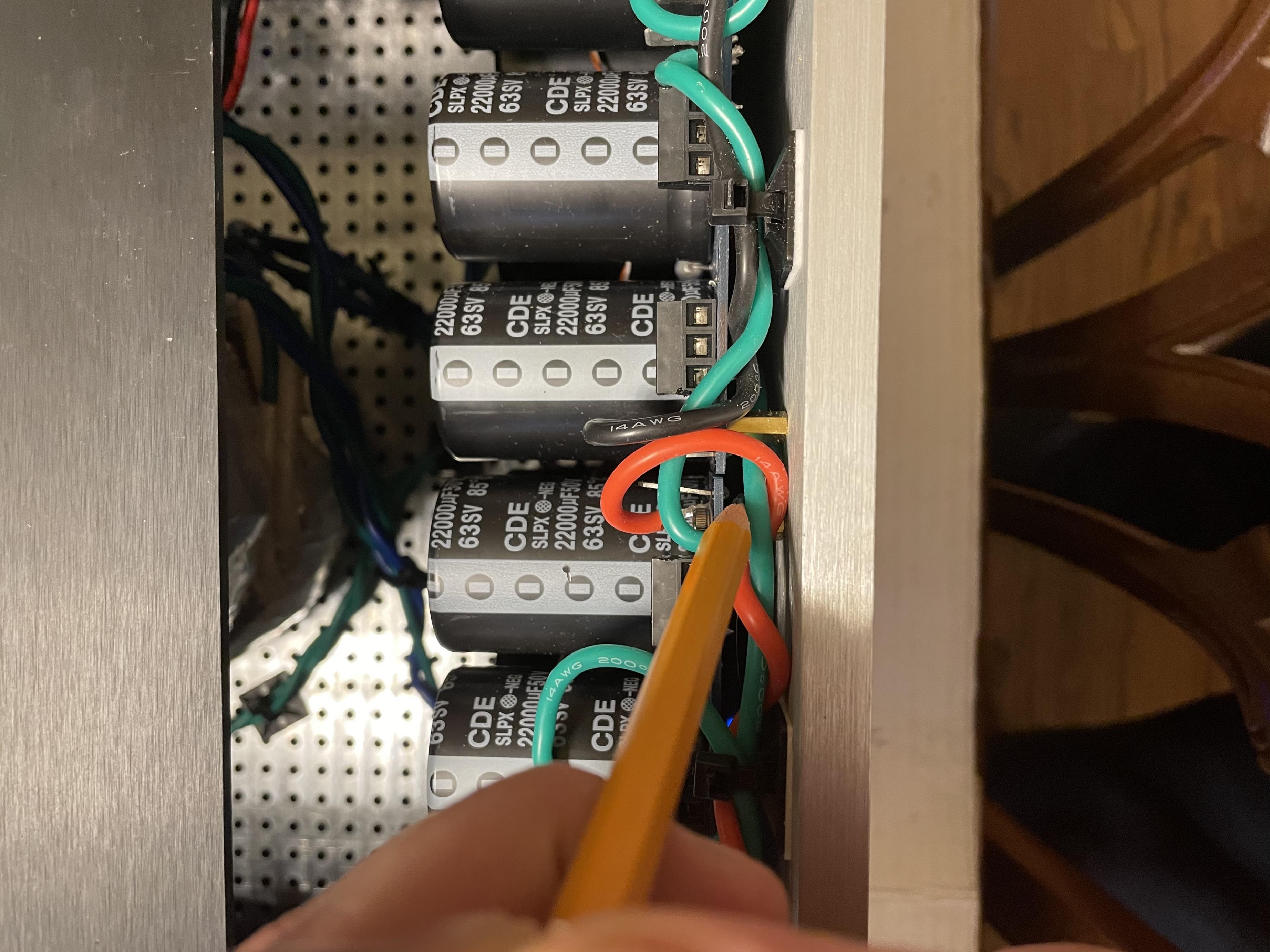

Tried to get some pics of the grounds. They turned out kinda bad
the GND from PSU to amp comes from one "side" of the PSU. The one next to it goes to chassis earth 🙂 and same for the other ch 🙂
I agree, that might not be a problem at all. But to rule it out, it is more flexible to be able to try different connections to see what makes the quietest one, and then solder when happy. At least if all else fails.

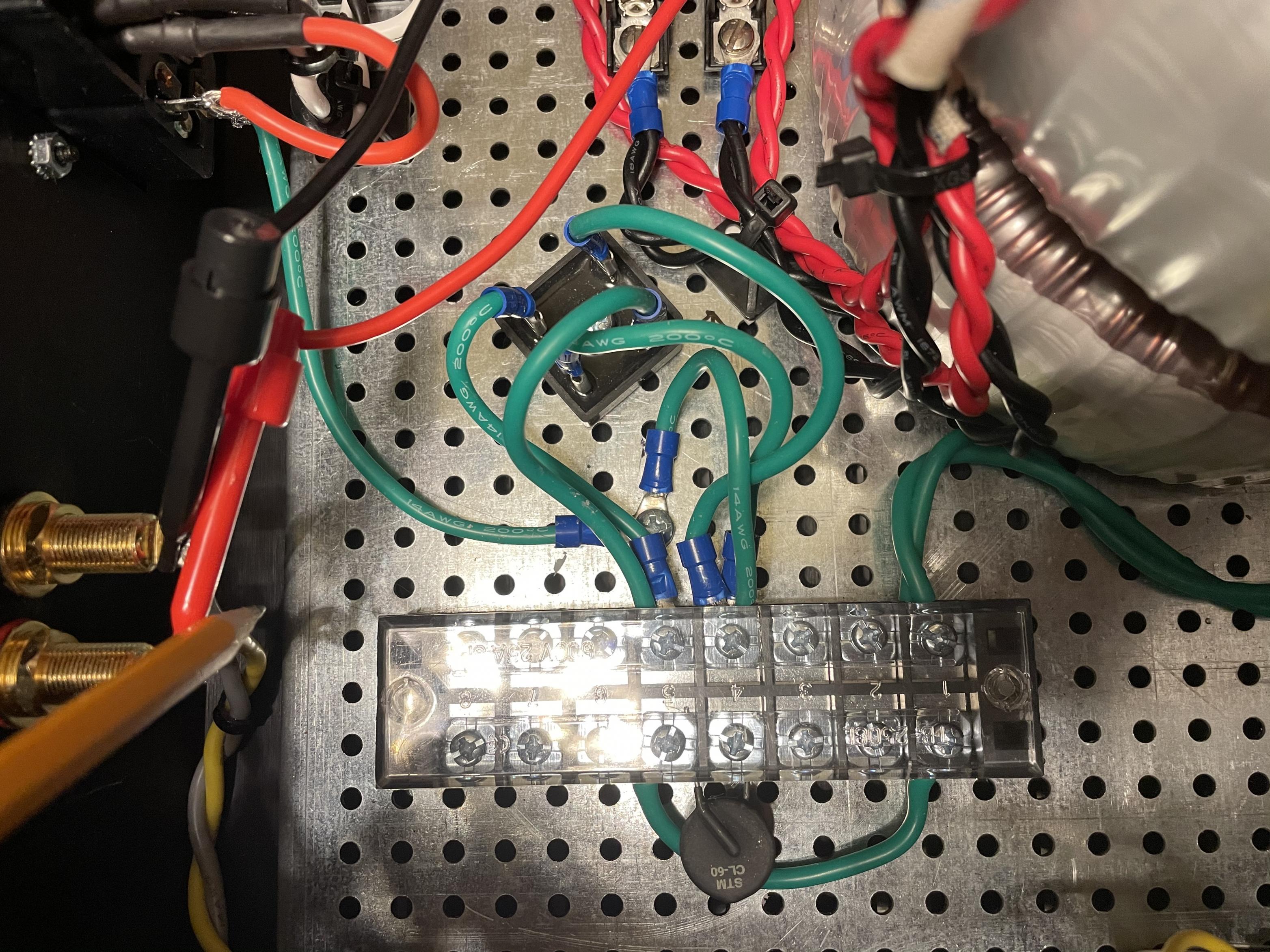

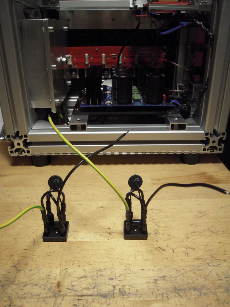

I see it. As suspected. the GND's are tied together before the grondbreaker. Also, i see both a CL-60(?) and a brigde rectifier as grondloop breaker. It should be one or the other. But you need 2 of the the version you choose. GNDgroundloop breaker-chassisearth. And the same for the other ch 🙂
Audiosan, I didn’t realize to use one or the other. I thought it showed both in the schematic. Either way, I have both and I’ll attempt that in the AM. I may have to pick up another roll of green wire.

You could tru the bridge for one ch. and the CL-60 for the other ch. Just to see if that fixes the hum.
AudioSan, I like that idea. Otherwise I have to wait until Monday when the wire arrives. Thank you again.

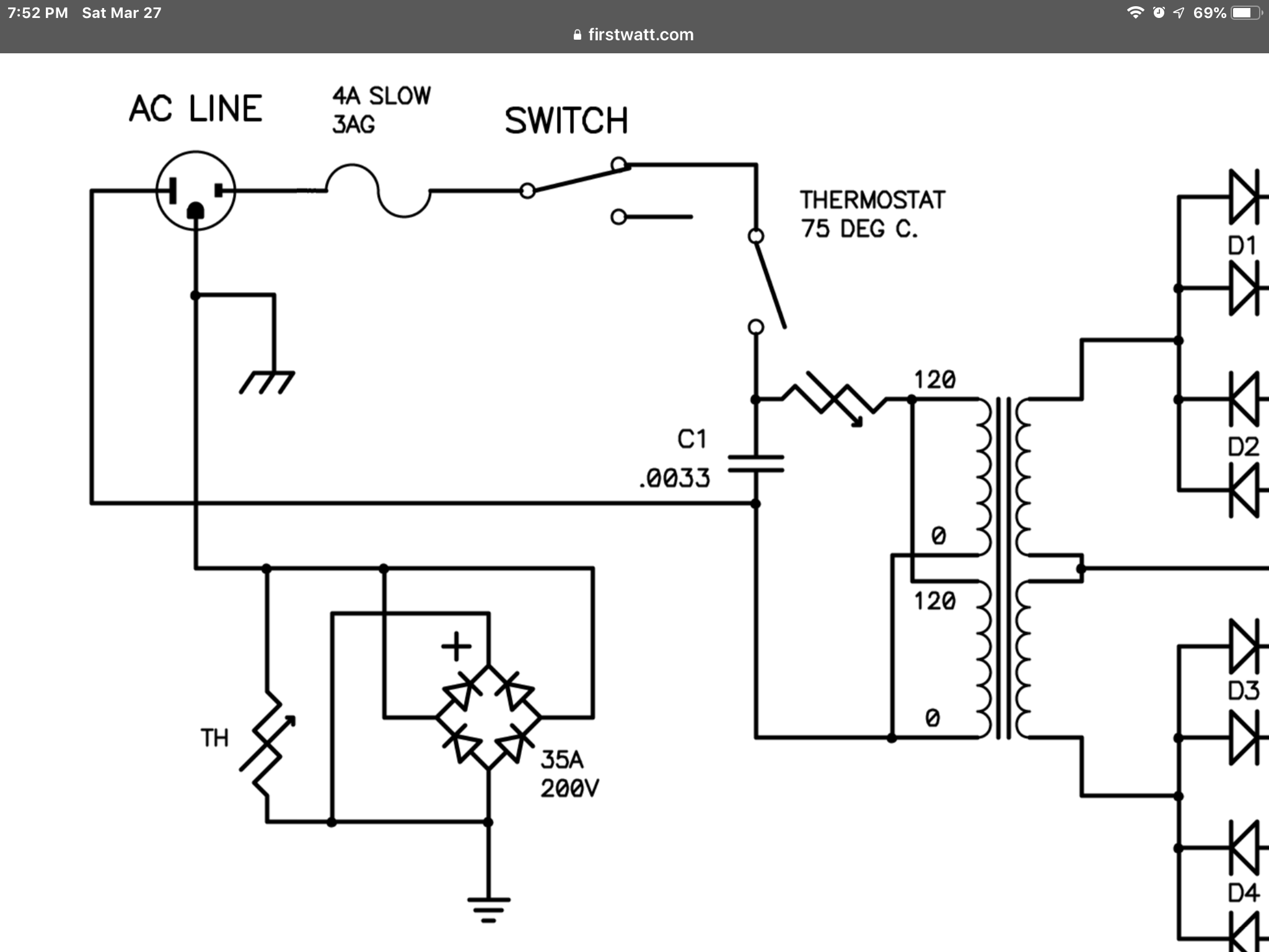

BTW, this is the schematic I followed.
That schematic is for 1 single PSU 🙂 In dual mono everything should be double up. the one common is the chassis 🙂
Got it, thank you! I’ll jump on it in the AM. I basically I can just remove the (2) ground wires coming back to the block from the psi boards and isolate them then take each to ground with the thermistor until I get the wire Monday, correct?
Split the 2 GND wires. Connect a Cl-60 or a rectifier brick to each of them. Then conect them together at the chassis. And from chassis to sefety earth 🙂
The CL-60 goes across the bridge, it is not cal-60 «or» bridge. Using a bridge rectifier as loop breaker, the CL-60 is a part of the loop breaker. The schematic is correct.
So, use either CL-60, or CL-60+bridge. Times two.
Same goes for fuses. There should be two separate fuse holders. If using the stores PSU inlet for dual mono, you are in effect using two times the fuse size that will actually break if you have a fault in the circuit.
