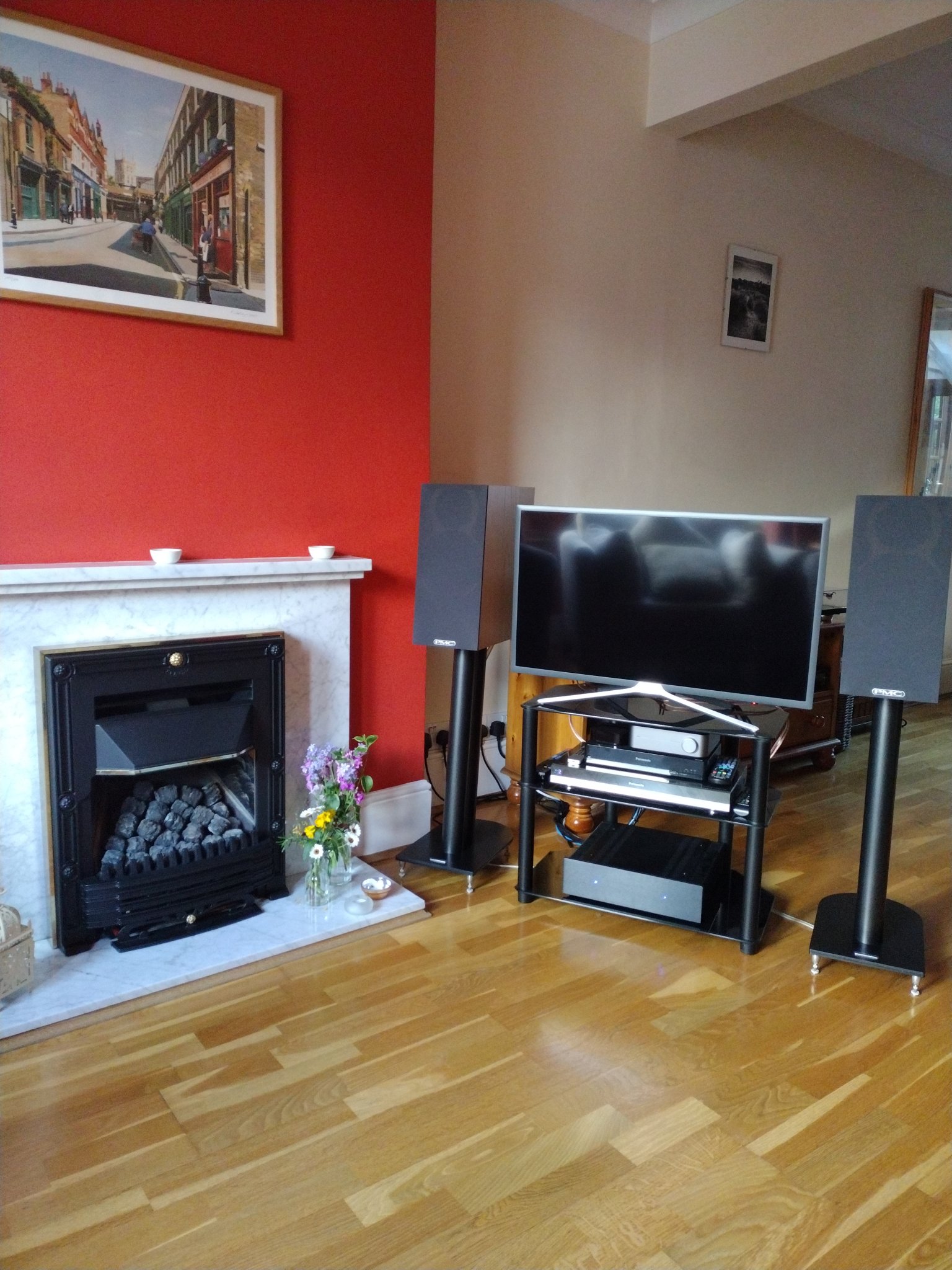

And finally here is the amp in situ playing some fine jazz blues.

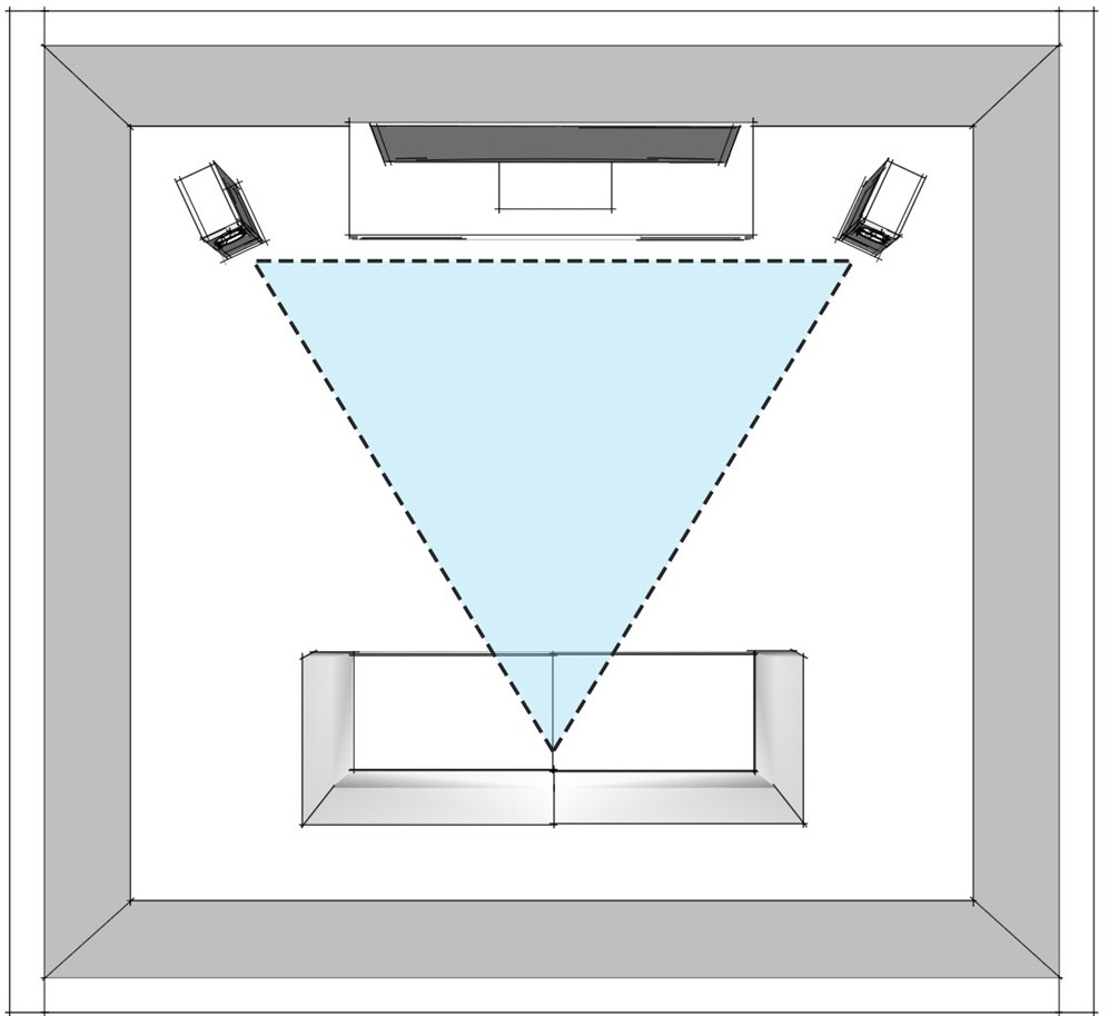

”Speaker placement. Best practice for optimal sound quality.”
Yes but it's a living space for many people. They can't, nor wish to, sit in the same 'optimal' position.
Yes, and not only in the best seat. A very well tuned to the room - optimaly placed speaker system - makes every single soul present in the living space even more happy. It simply sounds far superior: Everywhere.
It is very well worth the extra effort in my experience.
Not to drift too far off topic, but, in my experience, trying to impose the best practice standards of your interests and hobbies on others assuming they will enjoy them equally and willingly make the same sacrifices for them is, ah, unrealistic.
Reading the room is probably more important than treating it.

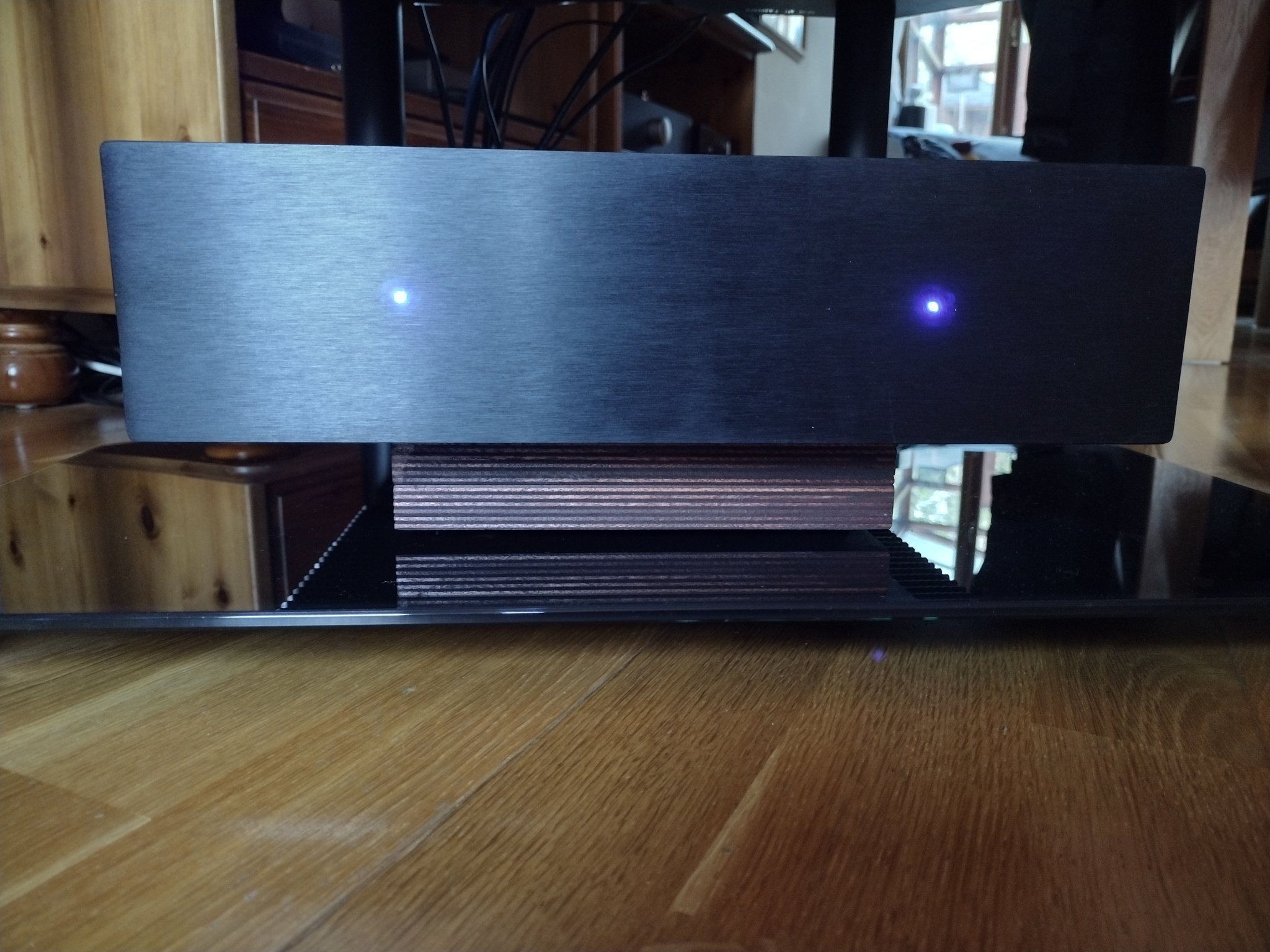

I'm not sure that playing time would make much difference for a Class A amp. If you did your final biasing after it being on 1.5-2 hr, it should be stable after that, if your ambient is the same. I do recall, though, Nelson mentioning to check bias a week or two after putting it into service.
Anyway, you might want to keep track of the bias when you sense higher temps on the heatsinks, before making changes. This will allow a better feel for the amp's behavior. Based on my experience with the F5m, if it is running hotter, even because ambient has risen, the bias has increased. I'm anticipating further changes as the weather warms, so I am following it closely.
Like you, I am also running with smaller heatsinks. Is your chassis the regular 2U Dissipante, or the 2U Mini Dissipante (a bit narrower chassis)? From some of your inside photos, I'm guessing it might be the latter. It sure looks good.
Yes I biased originally after one and a half hours, and when the readings were stable but I will recheck after a longer period - I do check offset whilst playing, just in case! Based on my observations I do think the amp heats-up more when playing, which is counterintuitive to the theory, but this is likely because the micro-climate is also warmer. And yes, mine is the mini-diss but the heatsink size is the same.
That was my point! Hand method works on mine fine. XA 252 is warmest, can still keep hands on there. Cats actually cycle on off with it. Other amps can be slept on indefinitely. XA 252, they get on got a spell only, then roll onto floor to cool off. Seriously!IR temp guns do not give correct readings on shiny metal, don’t bother trying. Place a piece of Kapton tape on the shiny HS USA surface and aim at that.
I finally coughed up 20 bucks for a digital meat thermometer. Holy perfectly cooked steaks!That's what I use - an instant read thermometer. Great for cooking too. 🙂
