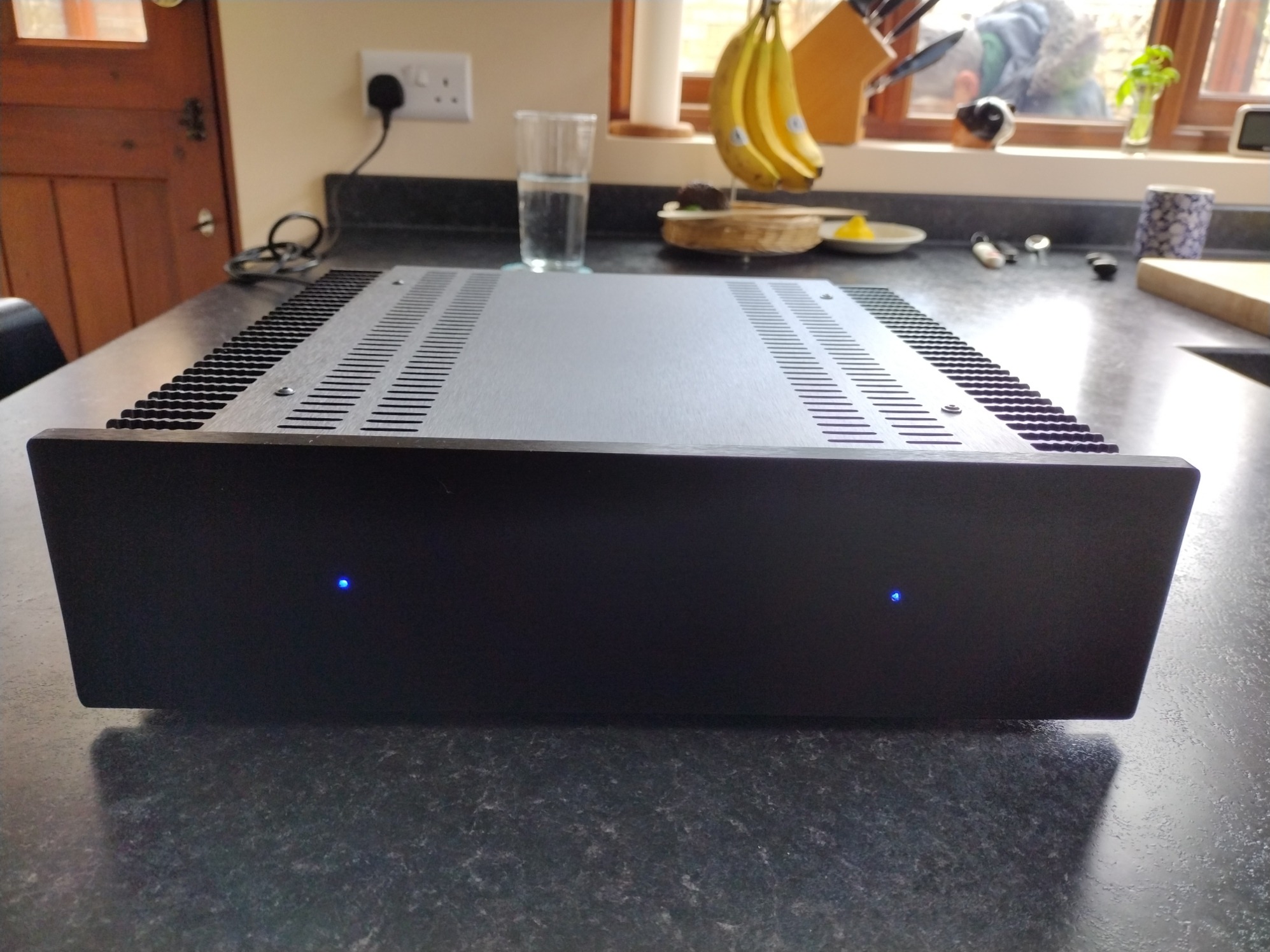

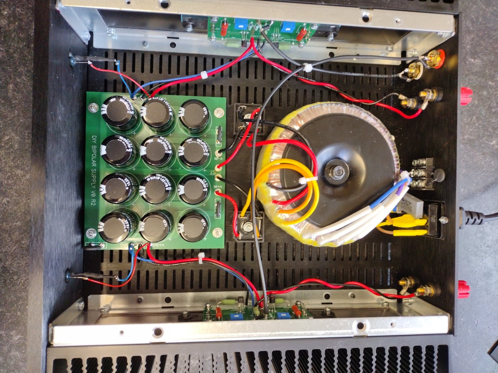

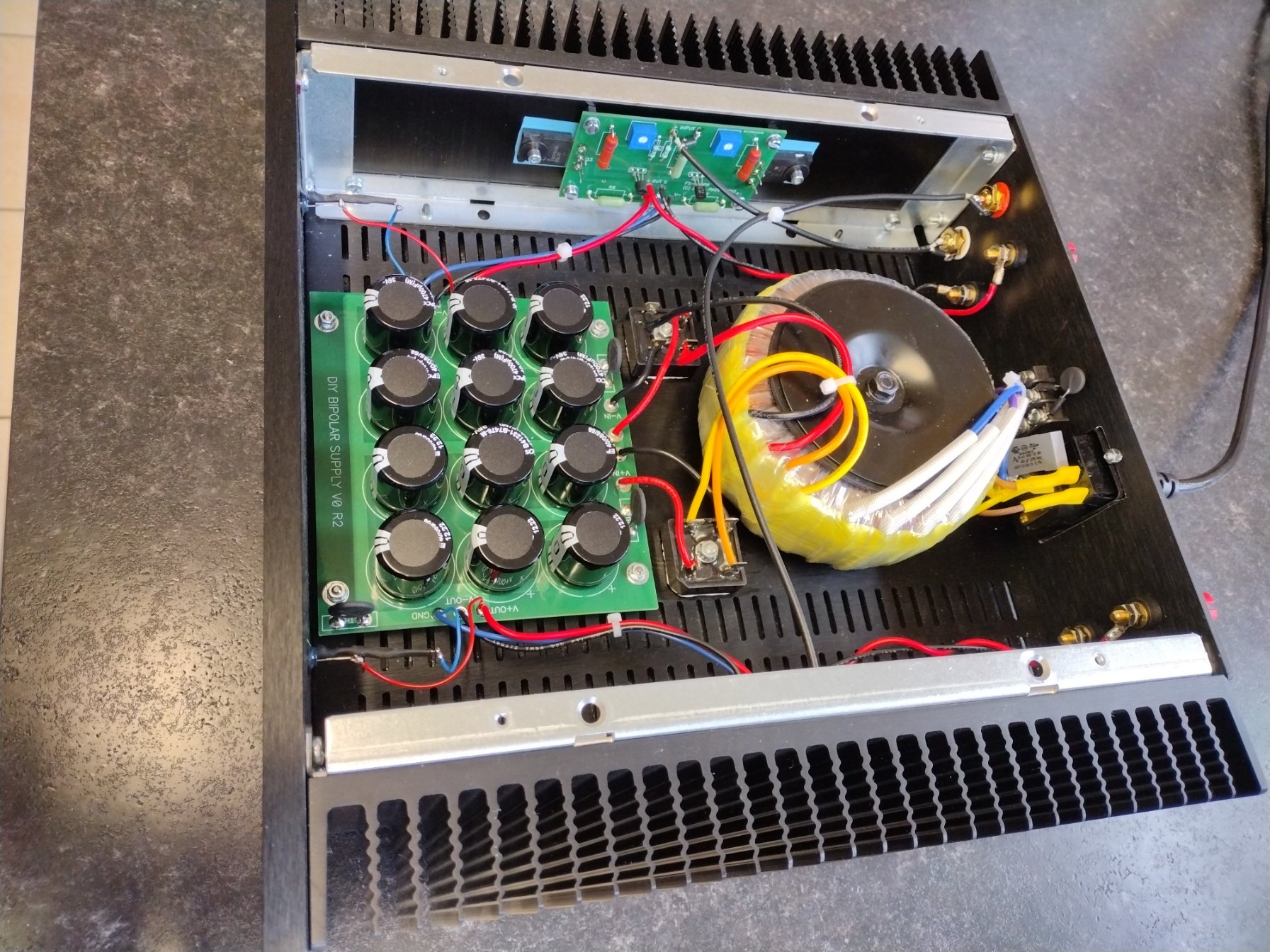

Russellc
Finished and sounding great... Thanks to Nelson and all those that provided support and guidance.
Logic800,
That's a sleek looking Class A amplifier you got there!
Care to share a few more details on the voltage rails, bias points? Understand that you were getting hum with the transformer at the front, and hence put it in the back?
What sort of temps are you getting in the 2U chassis?
Thanks. 1 amp per channel with 24 volt rails, and using 10 ohm thermistors. I had no problems with the transformer so you maybe confusing me with someone else. Heatsinks temp is hot but not dangerously so.
Silly me - indeed I got yours mixed up with another build 🙂:
https://www.diyaudio.com/community/threads/the-f6-revisited.405444/page-27#post-7657717
The diyAudio member remedied his situation by using the power switch at the back of the chassis, in fact nothing to do with transformer placement...
1.0 amp bias, +/- 24 volt rails, that means roughly 48 watts of dissipation per channel; good to hear that you have the heat under control.
What speakers are you using with the amp?
