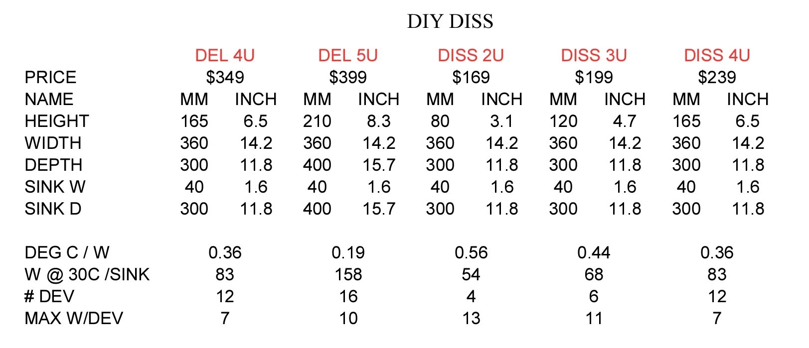

The file Nelson posted at this thread is helpful for the dissapation questions/comments. (Converting Watts needed to be dissapated to estimated temp rise of heat sink)
I've attached a screenshot of the file as it helps align what's being said here by others and it's a great topic to learn.
I'm considering using a 3U Mini-Dissapante for the F5m (package shows up tomorrow!), but want to be sure I can adjust the bias to my liking without running into heat dissapation issues. I'm sticking with 55°C heat sinks in a home with average of around 70°F during most of the year. For those days that are so hot my indoor temp creeps into +80°F, I'll just have to use a "babysitter" with the smaller 3U chassis if needed (babysitter = forced convective cooling using some sort of fan:

Please help me connect the dots, I see the calculations that lead to 75 watt dissipation, but what does the 75 watt diss. tell me?
Please let me know if what I am writing comes across as snarky or confrontational. It’s a 2 way medium with these forums so I can’t tell compared to a real live conversation like on Zoom or Facetime for example.
Okay, on to your question which is a good one.
On the last pages of the F5M article, Pass gives examples of chassis sizes and heatsinks and that is for a good reason. If one increases the bias current, then one has to also take into the consideration the increased heat dissipation so that the output Mosfets are within their safe operating zone and for general safety purposes. A safe rise is about 25 degrees C above ambient. 30 degrees is also okay as Pass used. You’ll see that various sized heatsinks have ratings of degrees C/watt. So for example at a 75 watt dissipation if one used a 2U heatsink, it will rise 42 degrees C above ambient, for a total of 67 degrees C which is much too toasty. I try to aim for a max of 50-55 degrees C for safety. This dissipation is divided amongst the output transistors which there are two. The large chassis used on post 626 will definitely accommodate this (it appears to be a 400mm deep, but I can’t tell if its a 3U, 4U or 5U height). The heat rise won’t be as generous compared to my extreme example of using a 2U.

It’s the 5U 400mm deep. Which I was planning to use for another amp build but decided I couldn’t wait for a small case for this amp. 🙂. The case is massive overkill for this amp. The sinks are at about 40C right behind the amp while the amps are way up at the top.
Same question though, does a larger heat sink tend to be less prone to temp fluctuation, seems logically
That’s another good question. I haven’t had that experience personally. What I do find is that larger heatsinks take time to thermally stabilize. So I try not to make any hasty judgements about the heat or warmth of a heatsink until a good hour has passed (I also use an infrared Fluke to measure these things as well as the old timey test, my hand!). 50-55 degrees C for me is plenty warm and puts a smile on my face that my amp is being put to good use.
For smaller heatsinks, they heat up much more quickly.
This may affect biasing methodologies different from what is used in the F5m but I will try not to obfuscate this thread by mentioning those ideas. I leave that up to the reader…look up Pass M2, M2X, etc…
