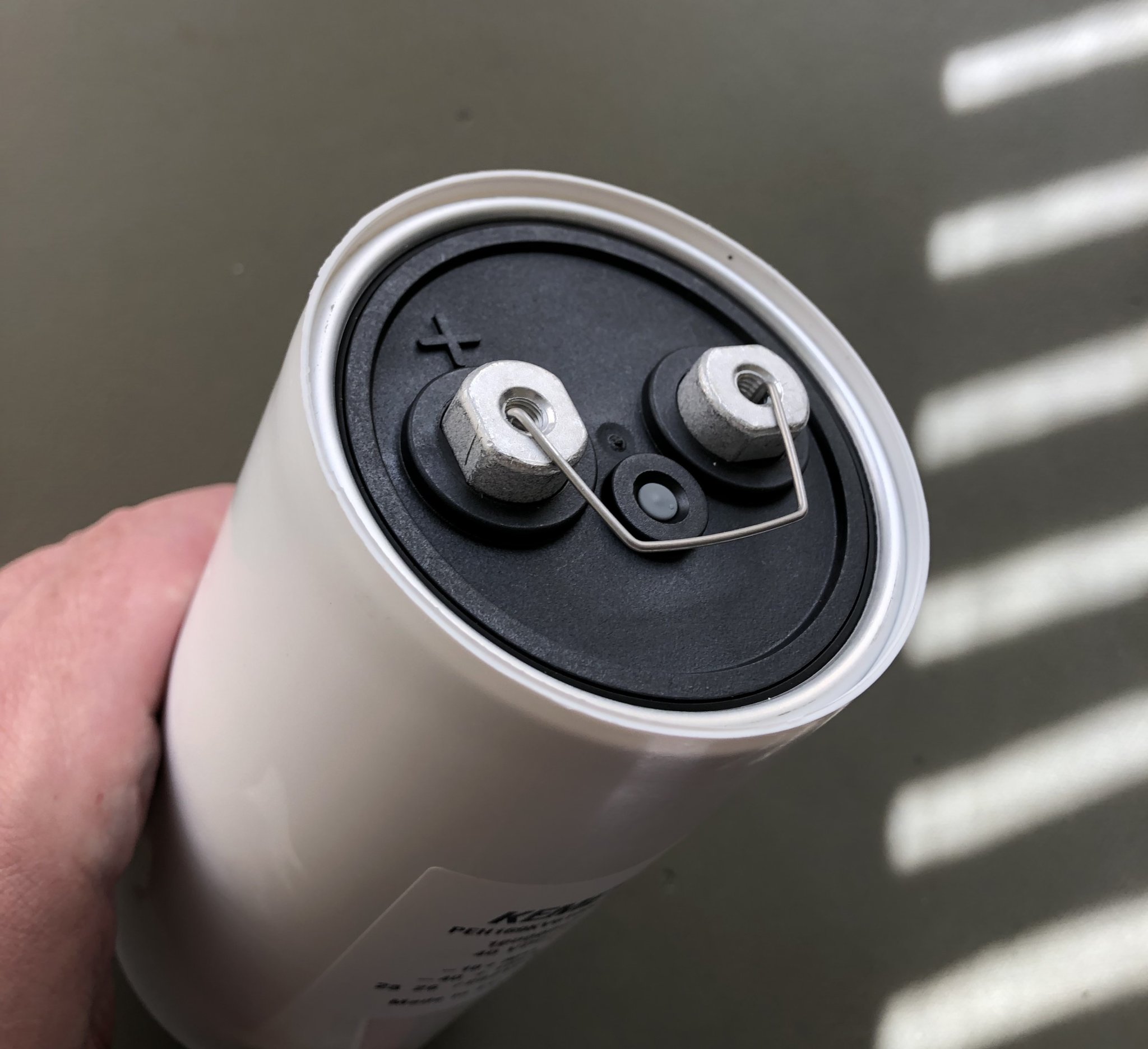

BTW, even if you have charged up a supply and don’t have bleeders installed, it will eventually discharge….it just takes a while. You should always check with your volt meter prior to messing with it or connecting it to your favorite main amp circuit. But honestly, this is all about safety, so measure with your DMM and then discharge the capacitor. Bleeders are for safety and are installed for that reason.
I even measure the voltage of capacitors I receive in the mail. Especially large caps (like 47000 microfarads). In cold weather, you’ll notice they have some charge. I discharge them with a resistor and THEN solder them to my power supply board.
I have often thought WHO is building the F5m. Are they seasoned builders? Are they diy newbies with a few amps under their belt? Or are they absolute newbies who have never built a linear power supply before? Probably all of the above. Hence, the need for 6L6’s excellent guides which will provide these safety details I am sure.

These massive PEH169's I just received came like this... I'm getting ready to switch my power supply over to a config I read about on the CRC vs. CLC thread. If it works out it will be the foundation of any future projects coming down the pipe for awhile. And it will power this F5m first.
As far as builders, I'm sure it will be a broad mix of seasoned guys, greenhorns, and everyone in between. I think there's something in it for everybody. But particularly the new guys. It should be very easy to build and get going for most folks.
