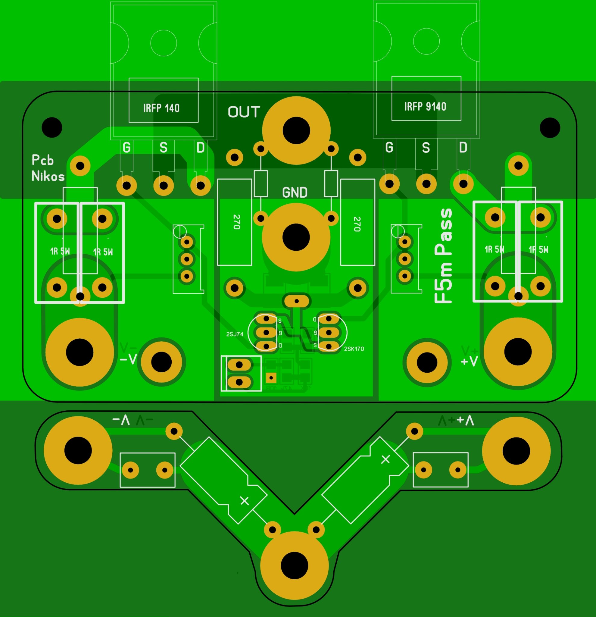

I make this board for F5m ...what do thinking? any suggestions ?

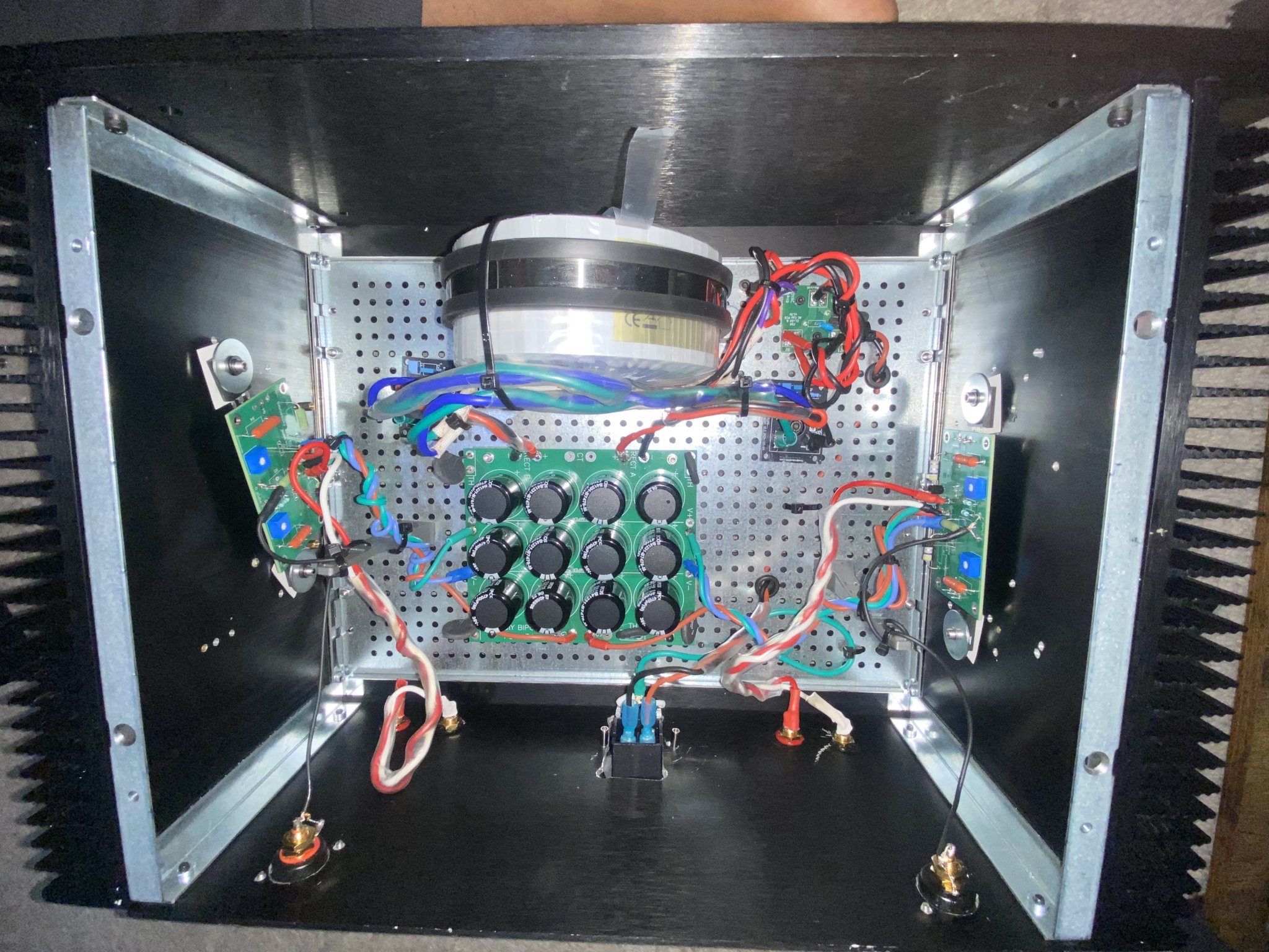

Hi My name is William and I would like to share my experience as well as some lessons learned that led to the completion of my amazing sounding F5M amplifier! Thanks to @Nelsonpass @ItsAllInMyHead @birdbox and all in the awesome people in this forum
I know wiring is not as fancy and neat as other people on the forum. And sorry guys I used solid core wire for the speaker outs. Found it easy to solder.

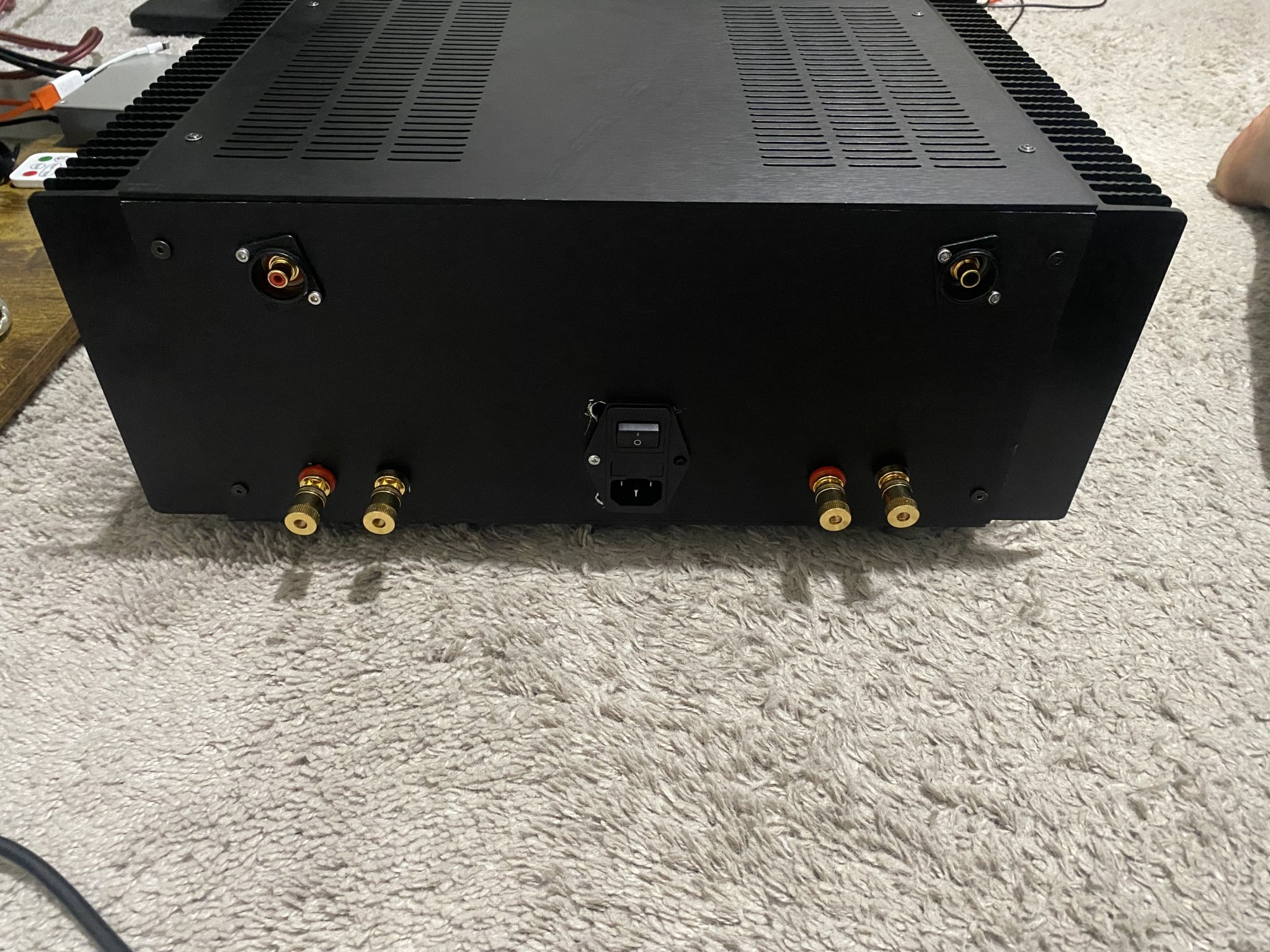

I almost don’t want to show the back panel I cut and drilled, but it is a cautionary tale (you’re going to get more of these in this post). Be confident you have proper technique before ever picking up a jigsaw (or your PEM mounting hole will look like mine). Also, spend a little extra and skip drilling your own holes, and instead buy the Deluxe Chassis from the diyaudio store, or Modushop (wish I knew that Modushop sold them before I made my purchase). This is a 4U 300mm chassis for reference.

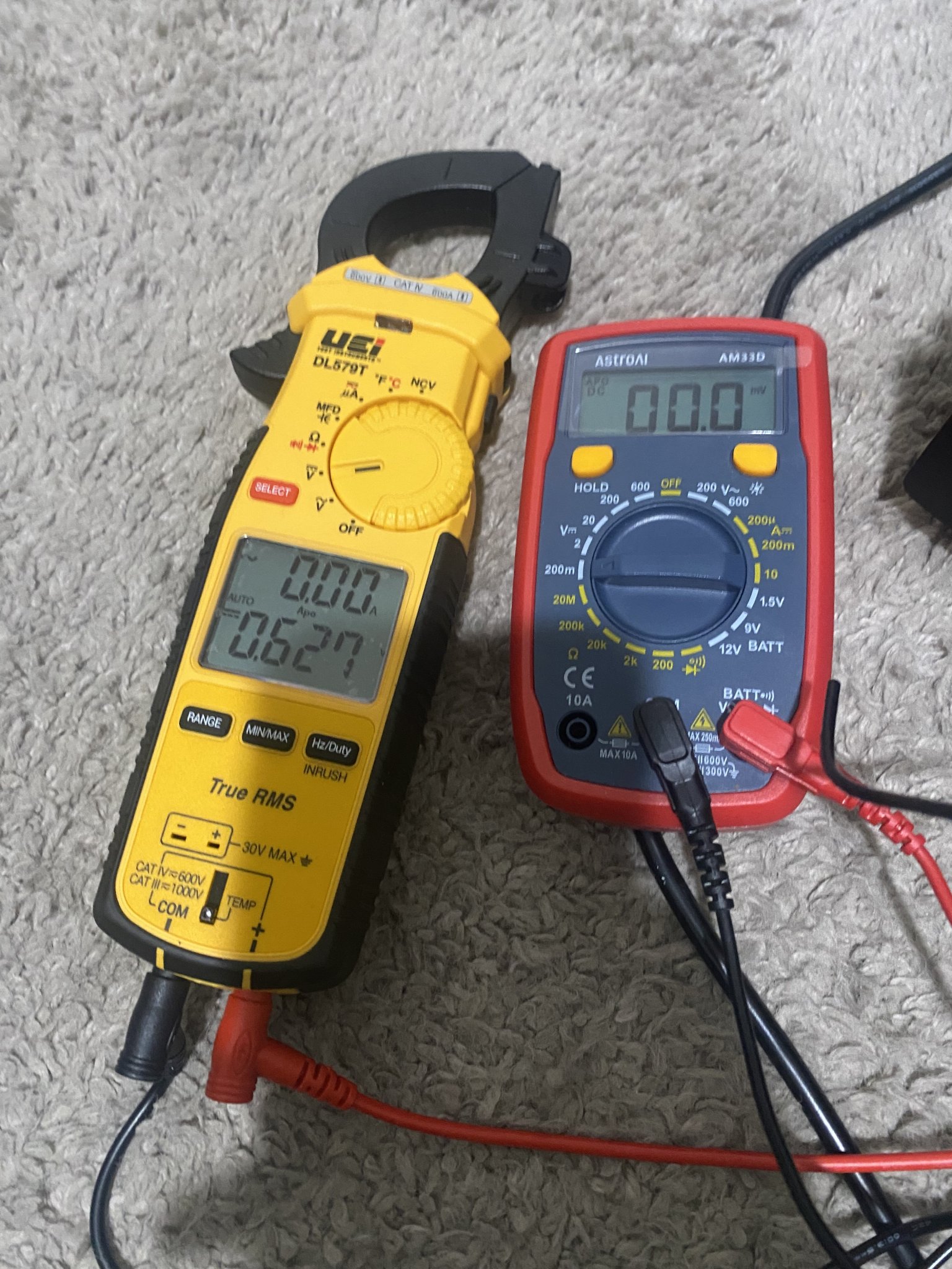

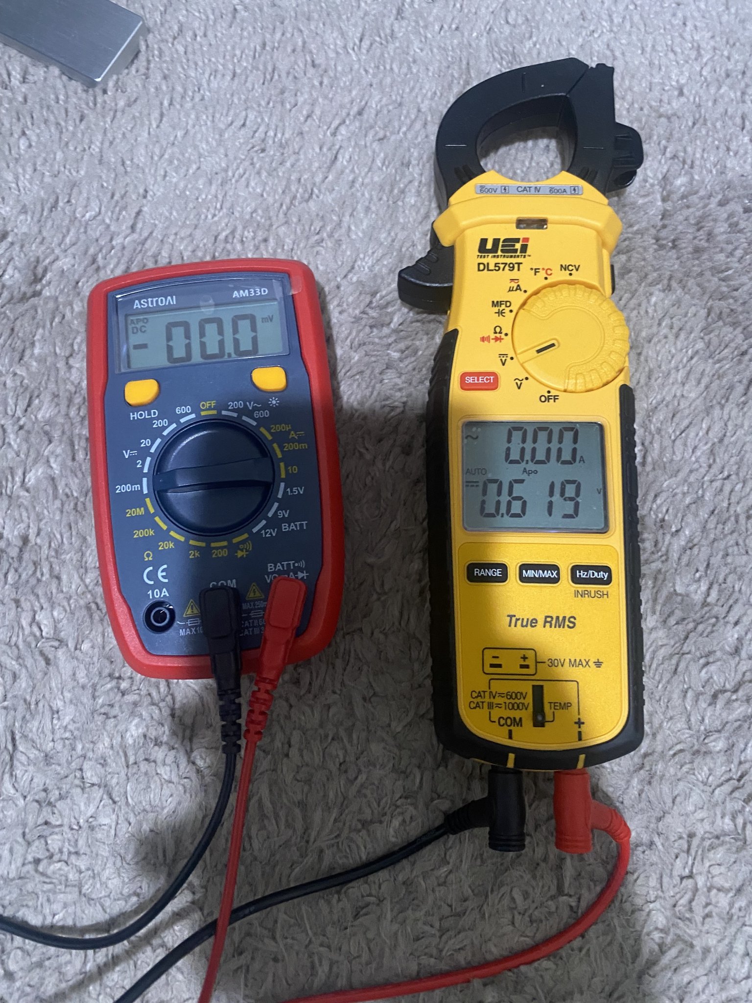

The bias on my F5m is a little higher than my original target of 1.3A (.611V across the 0.47R resistor(s)) with near zero DC offset. I found it not too difficult to bring the offset to zero if you let the amp get fully warmed up and reach the point where voltage across R6/R7 stays stable, and if you not even nudge, but more so apply slight pressure on the pots in the direction towards zero offset it can coax the offset in the direction you want with minimal change in bias across R6\R7.

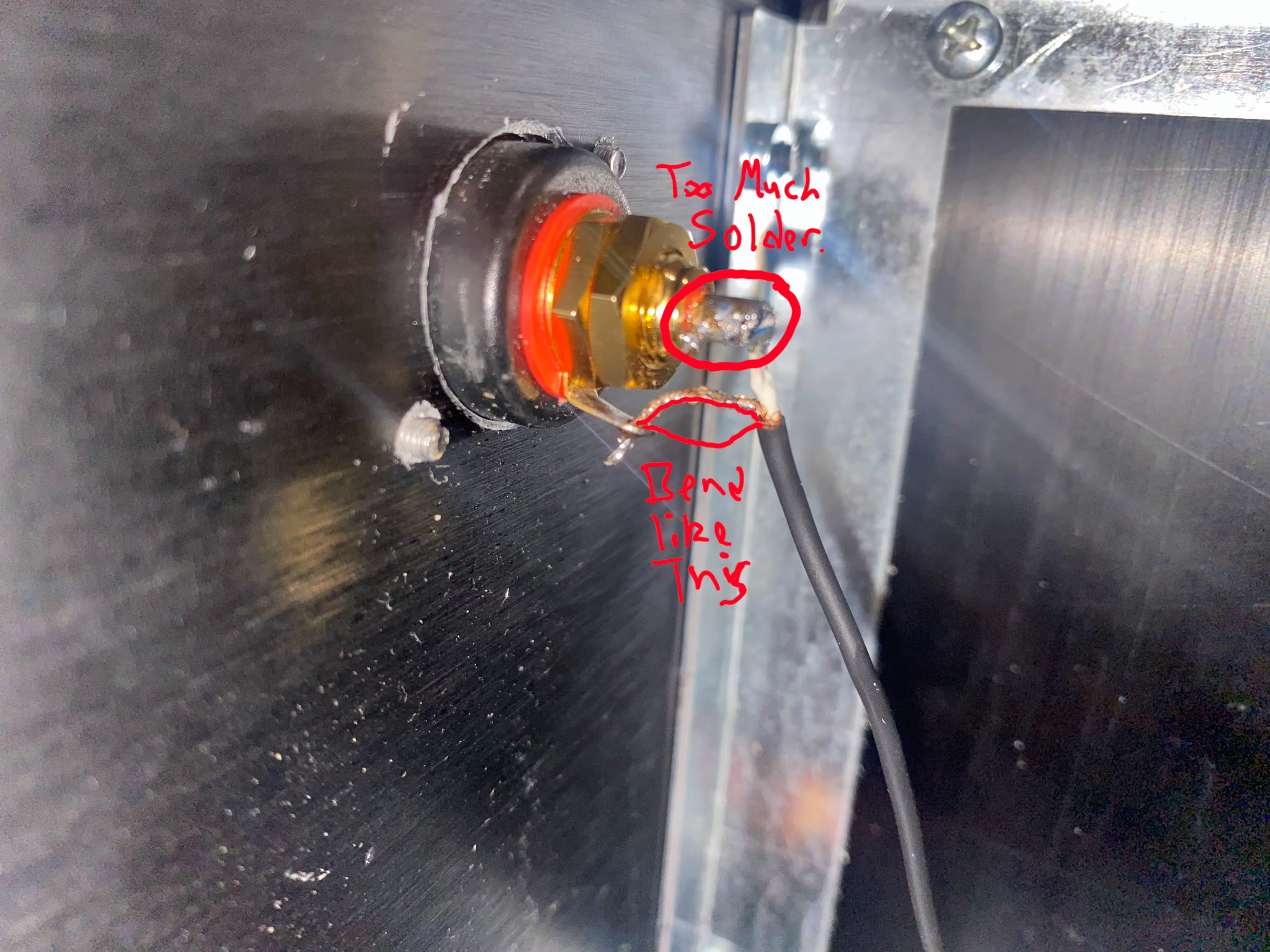

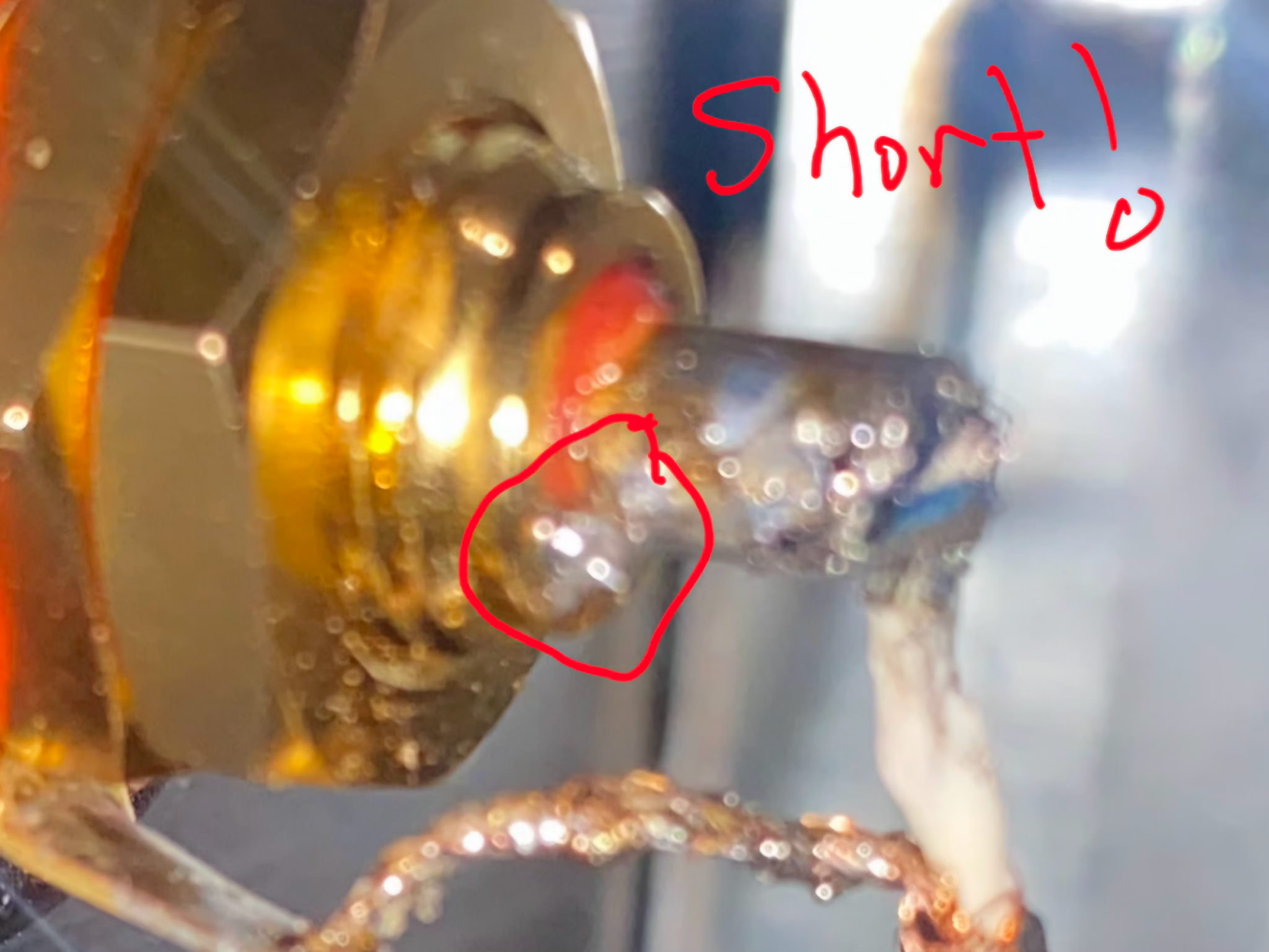

I will also share this just for anyone that this could potentially help. Make sure you don’t have shorts between input pair. I had no sound for a minute until I contacted @birdbox who pointed out I had a short on my Neutrik RCA post. Once I removed the solder short, then music played.
