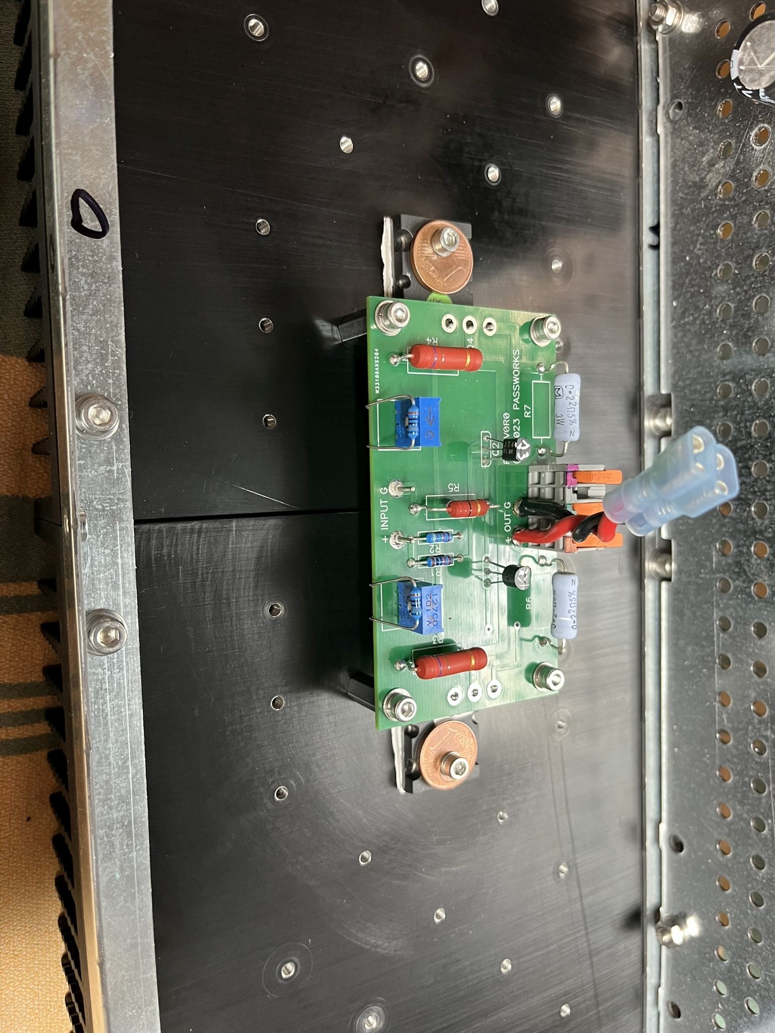

I actually looked at placing the boards lower when I was doing initial layout, but the boards don't fully match up with the UMS. There's 4 holes to mount the amp boards, but they do not all work with the UMS mounting pattern as only 2 will line up. I was scratching my head for a while, then just decided to mimic 6l6's approach. In fact, a lot of what I did mimicked 6L6's layout. That was intentional. No thermal concerns were mentioned with his build, so that's the route I went, and I'm not too worried about it. If it's not cooling efficiently enough, I'll just flip the amp upside-down, problem solved 😉 (or dare I bring up feedback control loops for actively controlled forced convection babysitters again?)
My gut tells me the difference in temps will not be all that significant, but I really have no clue as a noob here and my gut instinct is wrong 50% of the time. Darned convection never fully there when you need it, and then shows up when you don't want it (like the wind chill factor in MN when it's -16°F). This all sounds like a test problem in a thermal dynamics class. It's a good data point for a beginner like myself to account for going forward. At least I can avoid the math as it can be easily measured by flipping the amp inverted and measuring the difference in temps. I shall report back with results.....but first, gotta get this thing biased up tonight. Very excited to hear what it can do. For now, I got this distraction called "work" that's getting in the way of all my F5m fun.
The boards are super light weight , no caps, hardly any parts. I just hung them dead bug style off the mosfets like I did my original F5, (with even tinier boards, Peter Daniels boards). It's worked fine for years....

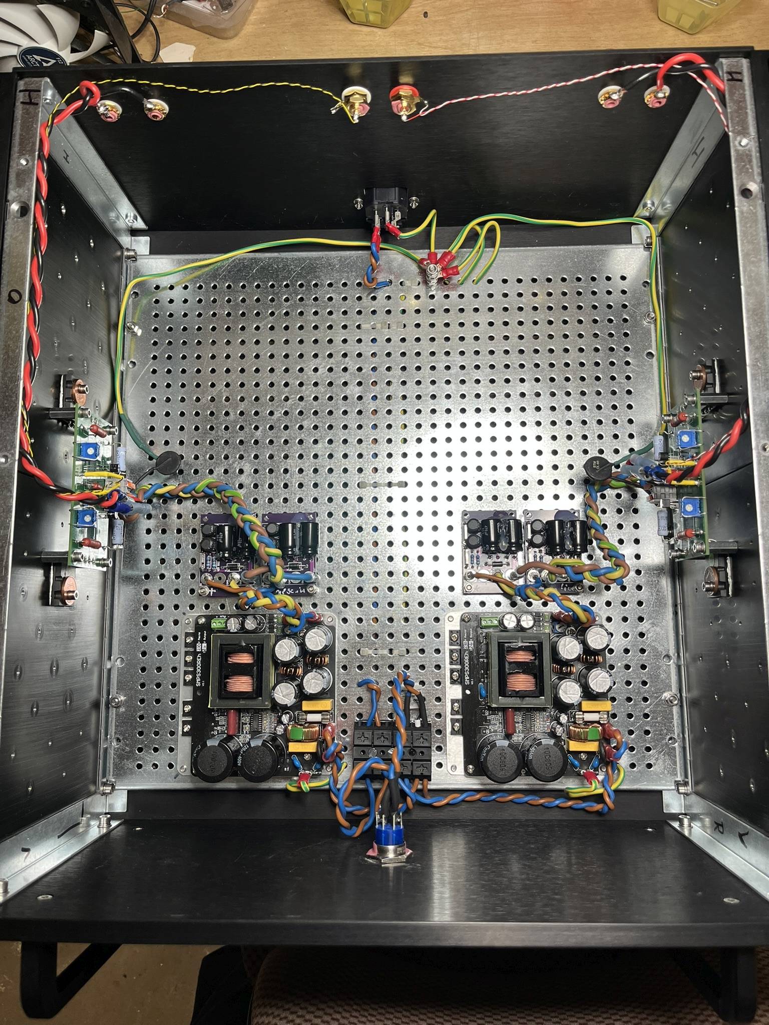

Not with laterals, but with Toshiba SJ201 / SK1530. These have a gate-source voltage of around 2V. I forgot what I changed other than making the source resistors 0R22 Ohms. I think I paralleled the trimpots with some resistance. Can‘t look right now because I‘m on vacation.
Worked perfectly and sounds mighty fine. Combined with 2 Connex 300REh as dual-mono power supplies, it is my favourite amp at the moment.
Regards, Claas
F5m.
Here's what I changed:
  • replace Q3 and Q4 with Toshiba 2SJ201 / 2SK1530 matched pairs
  • change R6 and R7 to 0R22
  • parallel R8 and R9 with 680R
There's loads of space in a 4U400 case once you use SMPSs ...
I just put a pair of PO89ZB filters (configured for positive resp. negative) behind the Connex SMPS 300REh. Doesn't do a lot, just reducing a tiny bit of buzz that I could hear with my ears against my 100 dB/W spaekers.
Claas
It is still on my list to measure it, but so far I'm too busy listening to it 🙂 ... so, can't really tell yet.
In my M2, also with 2SJ201 / 2SK1530, it looks like I had less than 0,03% THD at 1W, with 2nd and 3rd harmonic of comparable amplitude. However, those were measurements still done with ARTA, and I can't fully recall my set-up and measurement parameters ...
Regards, Claas
