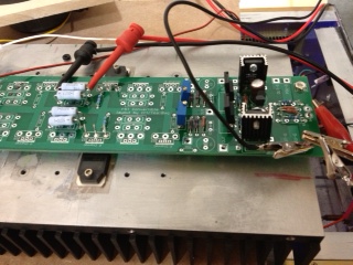

cascode referance voltage = rail voltage/(R25+R27)xR27
so for 50V rails it will be:
50/(10K+4.75K)x4.75K= 16.1V
for 32Vrails:
32/(10K+4.75K)x4.75K= 10.3V
Audiosan,
Proved these work in real work measurements.
Thank you.
Biasing seems a little trickier than standard F5.
I am going to do some more testing of values for R5,R6. I think I will go to 2.2K from 1K.
I find as the voltage climbs, my pots have limited and timid offset adjustability. I removed the thermistors to see if it helps, and it does not. Makes it easier to set bias for me.

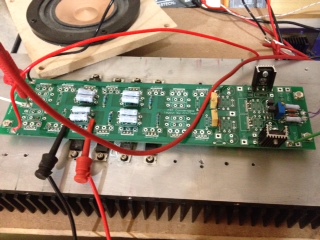

Attached Pic 1 -Cascoded version running 48V, Jfets at ~16v
PIC a version 2 one running strait out.

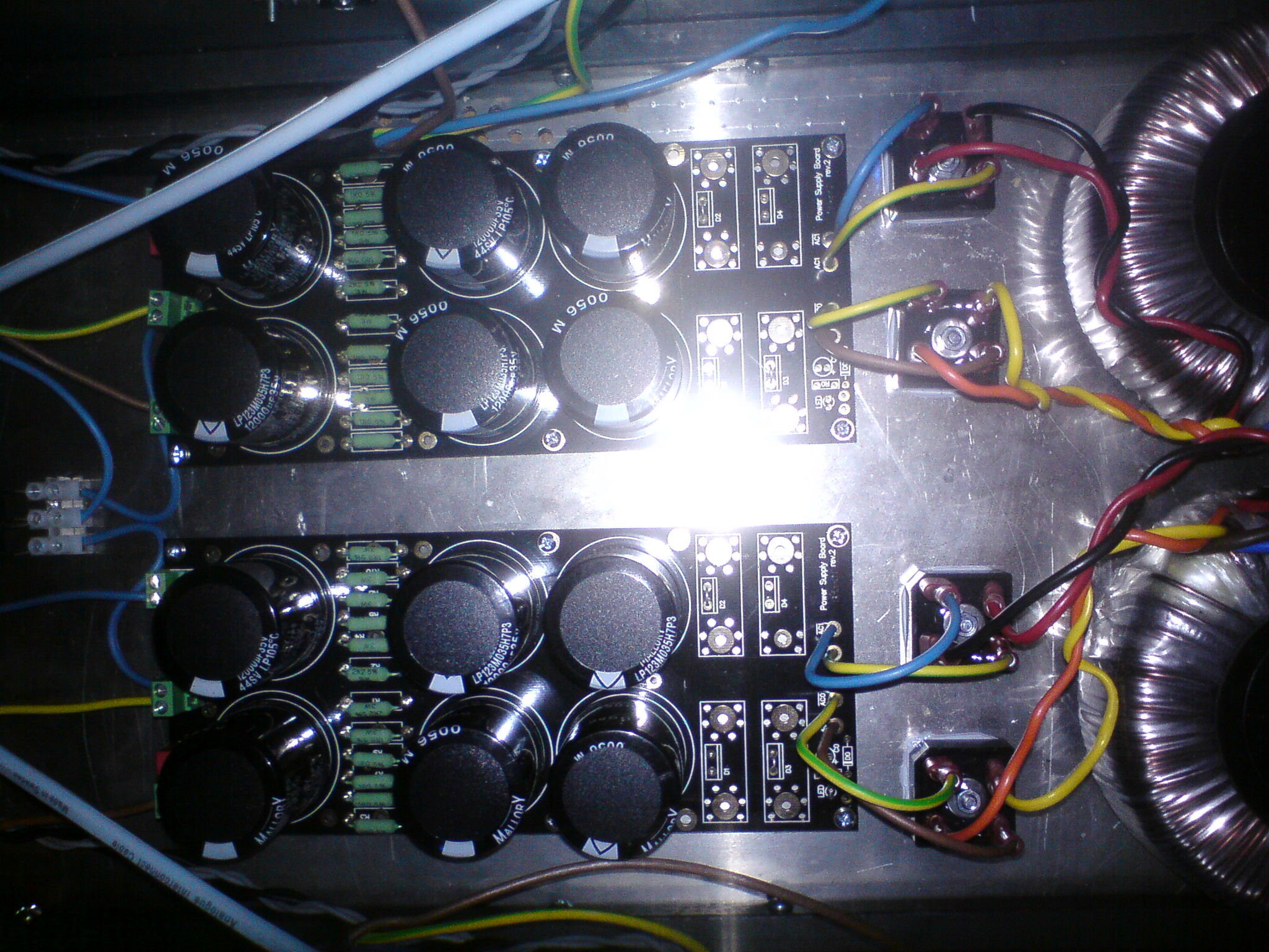

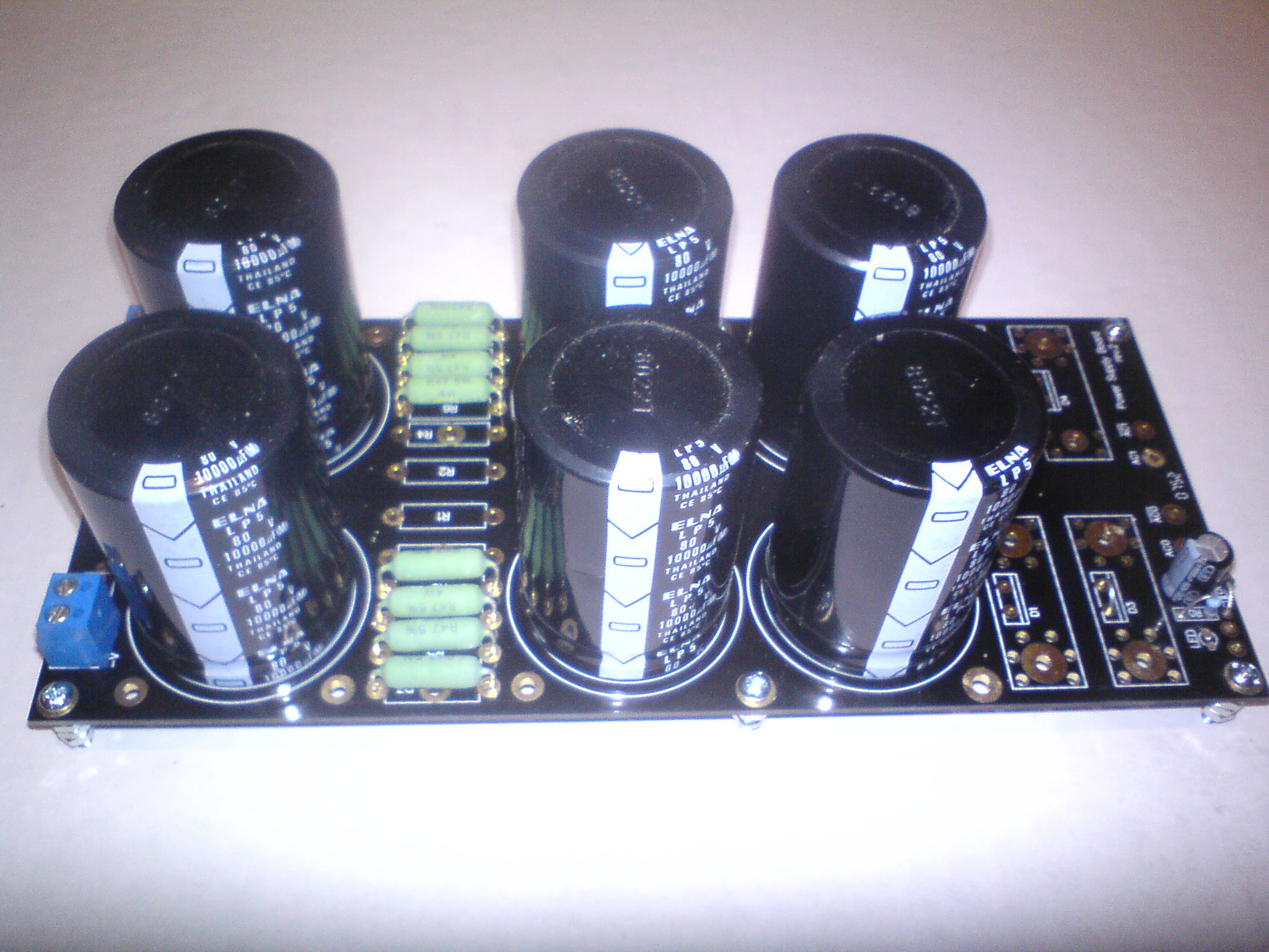

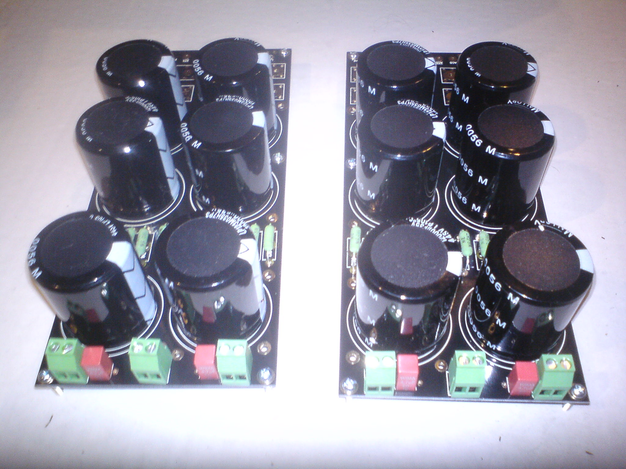

I would recommend the one from chip amps.com under the Aleph PS section. If you look around you can get some decent size bug caps on it, plenty of space for 5 .47R resistors and a place for 2.2K 5W bleeder resistors. And six big caps, 4 TO-220 type diodes can go here, and each can have a 2" tall heatsink. I will try to post a pic of one, if nobody has one quickly. It's <10.00usd. That's hard to beat!😉
here is 3 without the diode's🙂 one with 6x10.000uF 80V
2 with 6x12.000uF 35V
they all have 2.2Kohm bleeders and 4.7uF bypass caps. CRC resistors is 4x0.47ohm on one. and 5x1ohm on the 2 others.
