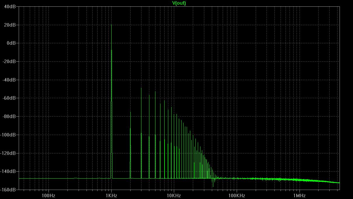

15V peak into 3 Ohms, with bias of 1.3 A, and 24V rails
Left image is without diode, right image is with diode

So I love trying to figure this out. It would seem that an interesting sreenshot would show a picture of what is happening to the response of the get with just the resistor and then with the diode added. I am goin to try this and see what it shows about the response change.
