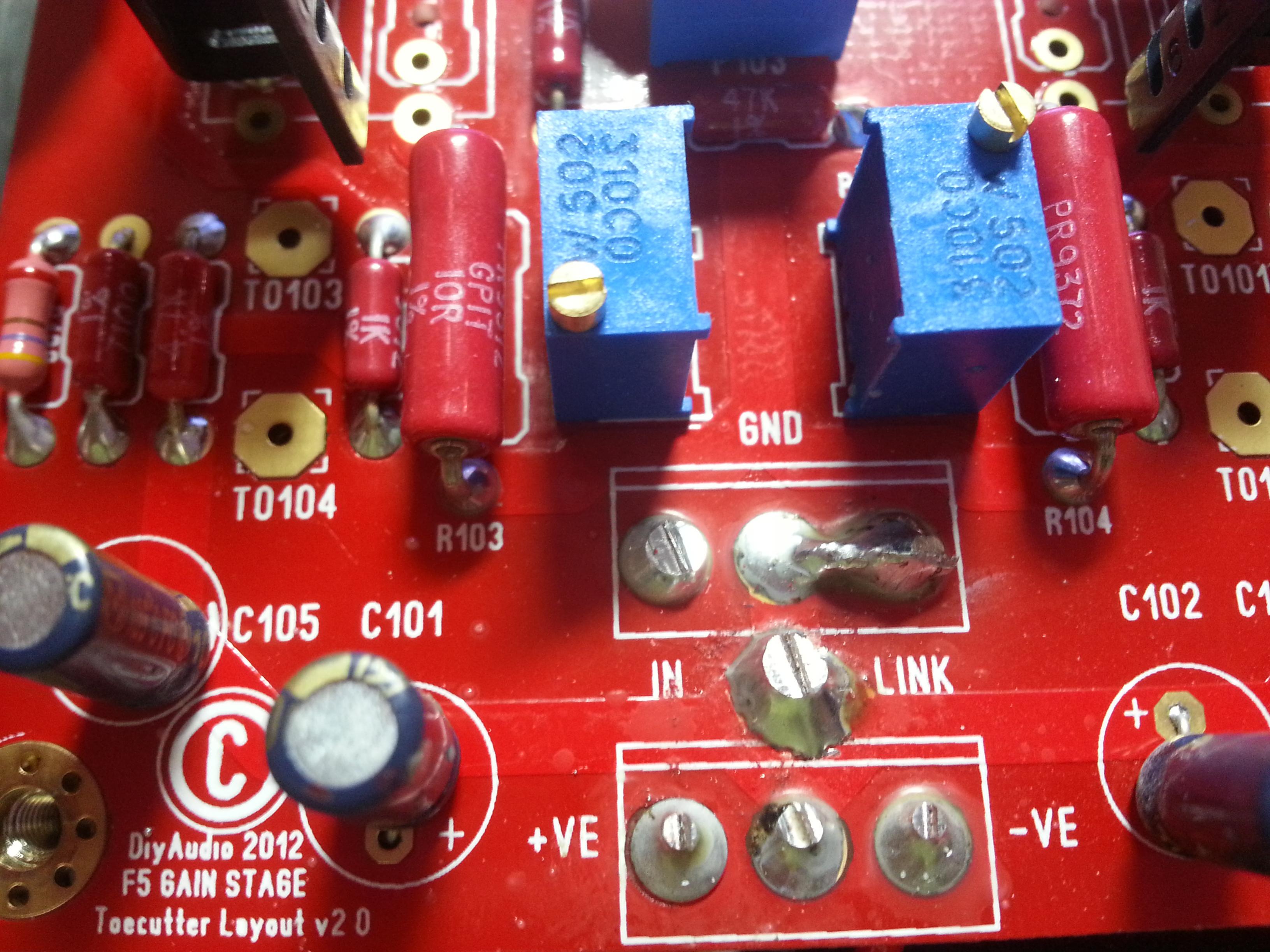

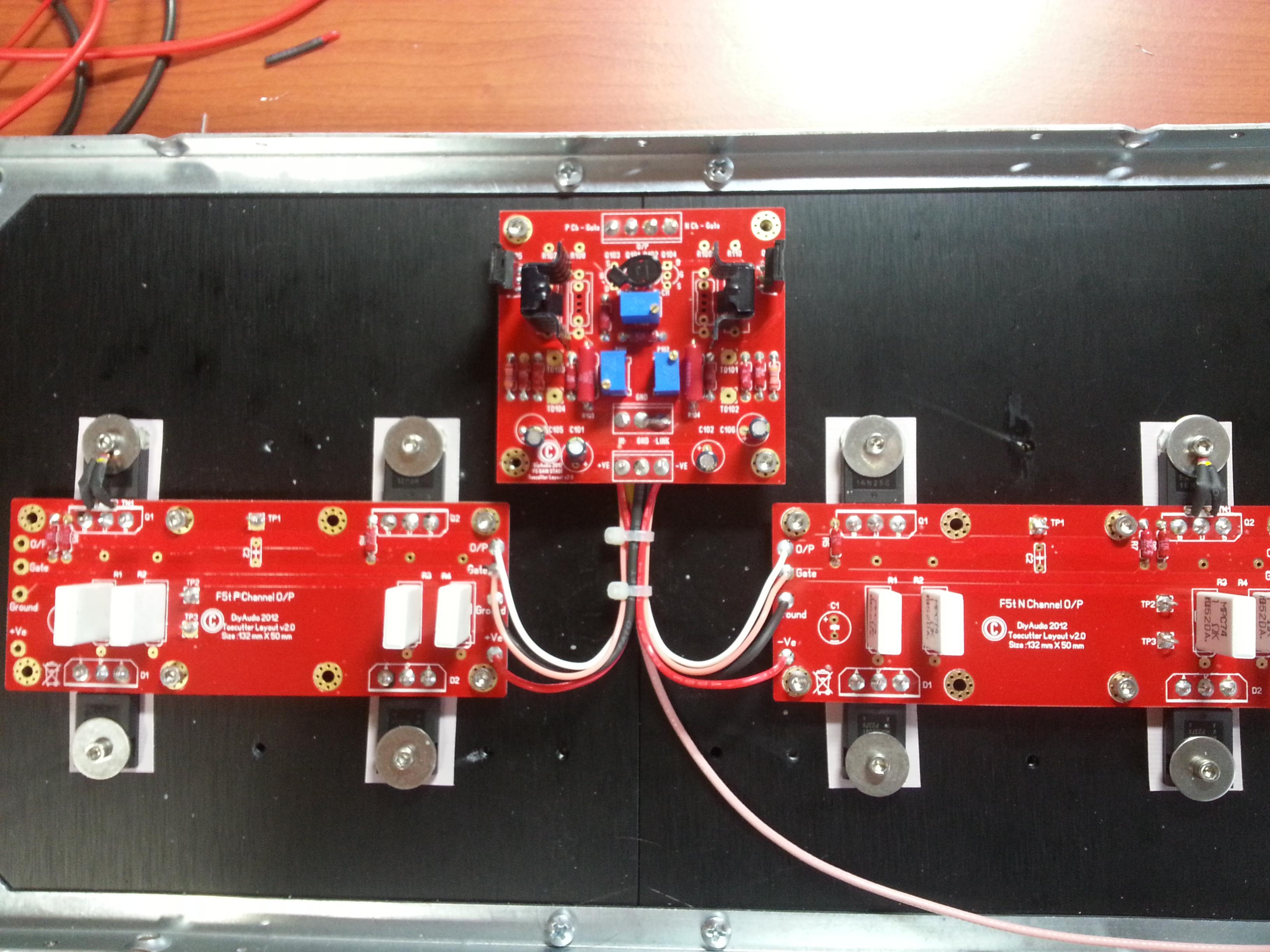

The first channel is complete 😀
The connection of the +V, -V and Output will be on the remaining holes of the O/P PCB but I have a doubt about the ground connection to avoid the ground loop issue.
I attach also the TH's picture. Seems that the only place to glue it is in that position but I remember that the best is directly to drain pin of the FET.
Any suggestion is most welcome 🙂

Thermistor on Fet screw is perfect. Ideally, you would like all ground to route through main board and go to PSU. This becomes your star ground point, with only single wire going to the PSU. Looks very clean so far.
Hi Buzz... As you see in the picture now I have the ground from the FE to the 2 output board plus the shield of the signal cable. If I well understand I will route 1 cable for the ground from one of the holes free on anyone of the output board to the PSU. The ground of the 2 PSU (+V and -V) will be shorted and this will be the star ground.
It would be better if you could double u on one of the inputs on the FE board. THis would be your branching point. You are encountering one small quibble with boards. Not quite enought holes for ideal wiring. THat being said, it worked perfectly for me with slack wiring job.
Those who built FT5 said that diodes does not heat up much, wouldn't it be better to mount separate ALU bar for diodes on both sides mounting perpendicular to board? This way you could lower the FET a bit putting it on the center of these 5U heatsinks, allowing for higher bias.

They do not get warm at all. Either way you do it, you want them thermally connected so that they track each other. I haev done both ways and have not noticed any audible differences, but then again, I do not have a hard load for the amp.
