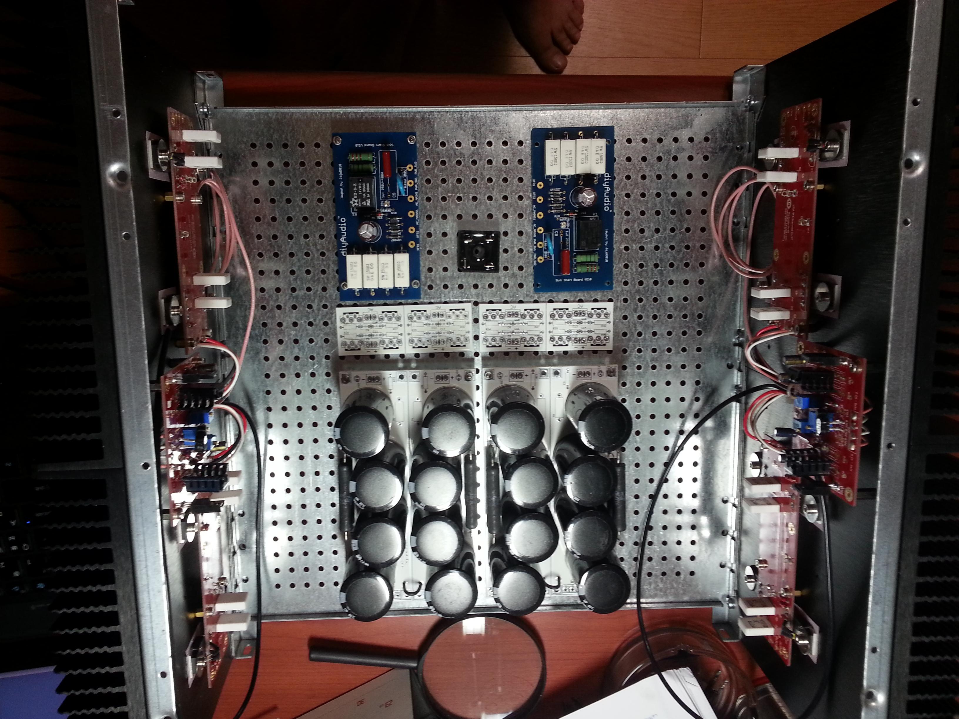

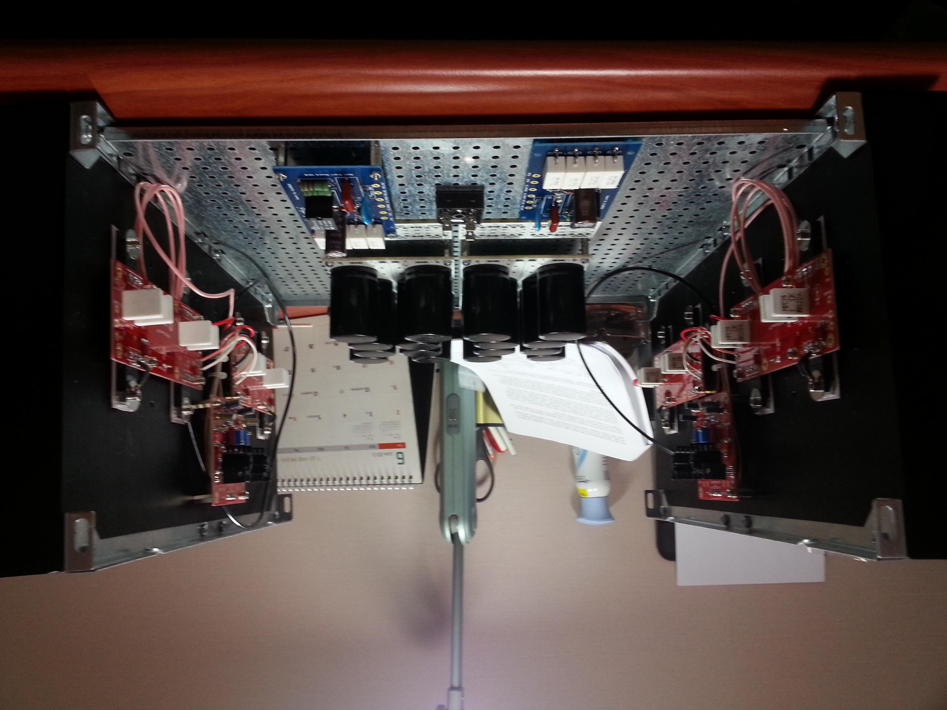

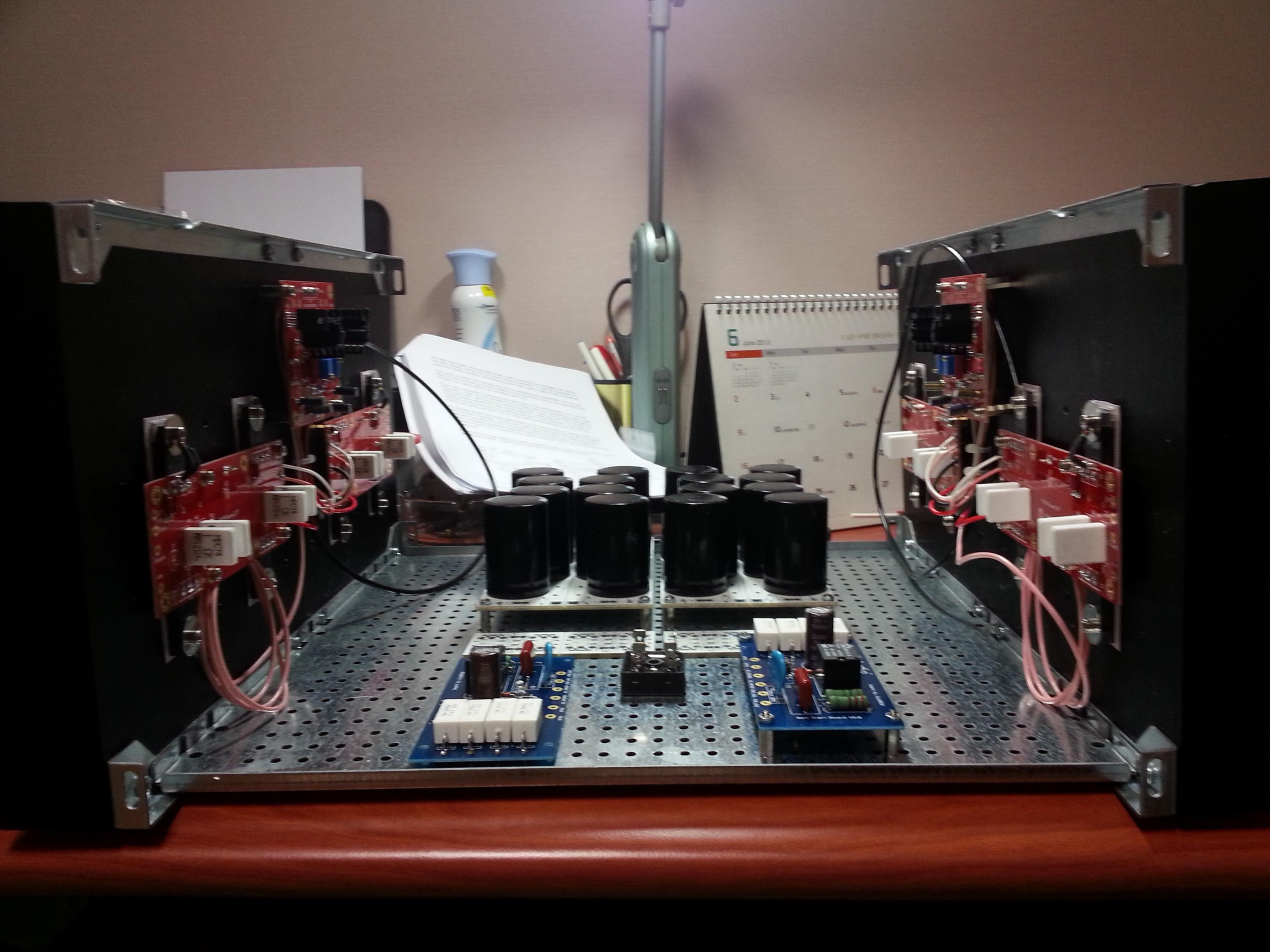

Hi Buzz and everybody in the thread,
the second channel is complete and I am now preparing for the final layout.
Can you please tell me raffly the dimension of the toroids? I am palnning to buy from the store the new risers having +/- height of 120 mm and large 200 . I think is enough for the trafos but I need your advise, as usual 🙂
In the pics you can see the final layout. Using the risers all the PSU section and the 2 soft start will be elevated by 120mm.
I have also a doubt about the earth bridge. This will be the only common part for the channel. Should be better to have one bridge dedicate to each PSU or is useless? Thanks and regards,
Emeyuoi

120mm should give you enough hieght, as I think the biggest transformer is about 3.5". Diameter wise, you are loooking about double that.

The transformer used in my build is 143mm diameter x 79mm tall. It is 600VA.

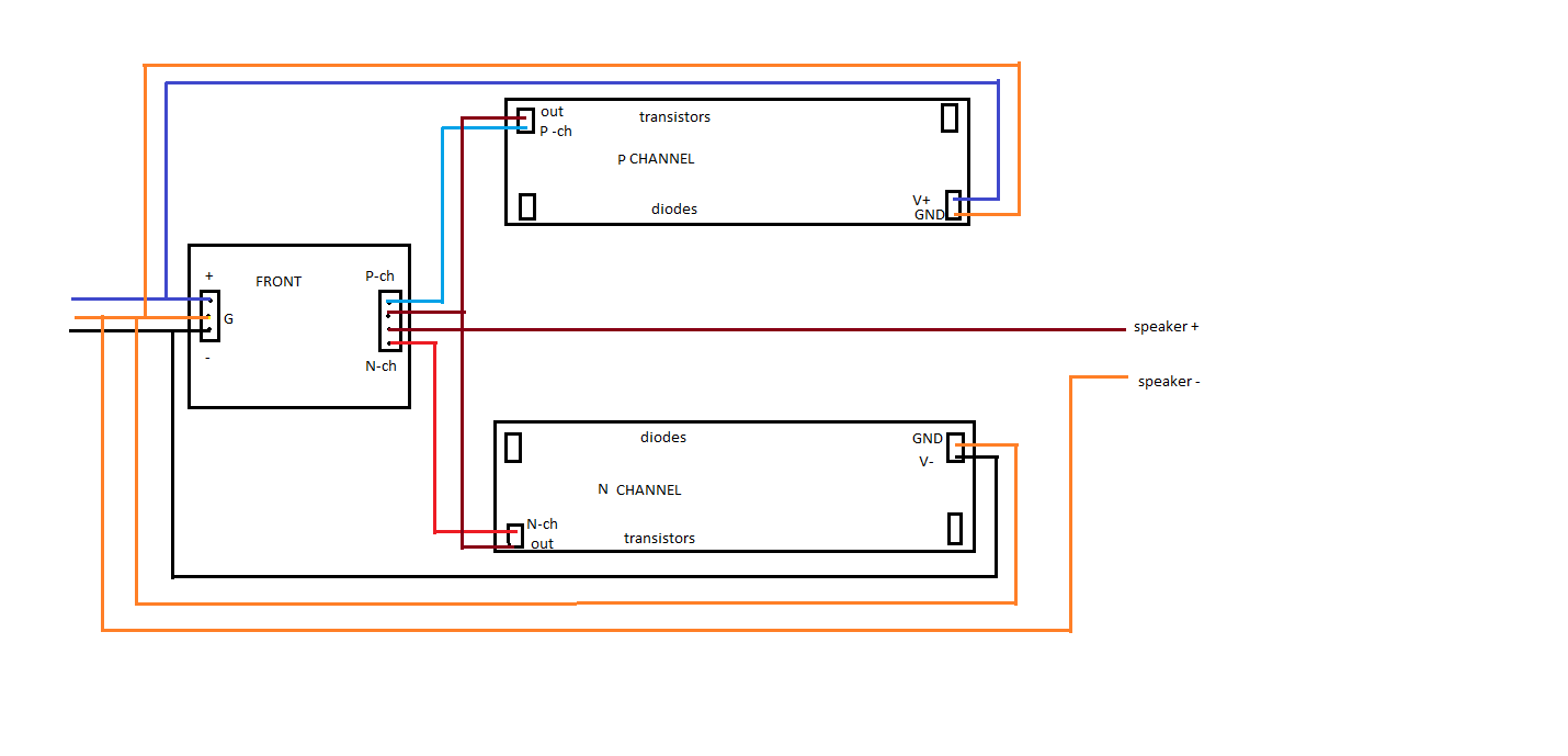

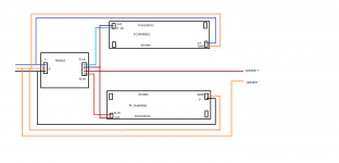

Hi Rixsta, sorry for the late reply. I read on the threads that you have a loop ground problem. I am just progressing on my first build and I can't help you in detail but as I understand from Buzz and reading in various threads in the forum the only way to avoid ground loops is having only one star ground on the Front End board. In this way the 6 ground connections on the PSU unfortunatelly are not usefull and you have to connect all the ground cables in the same point and back to the PSU with only one (big size) ground cable.
I hope that my understanding is correct and this is best way and I am sure that somebody in the forum will give us all the support

Thanks emyeuoi
Im just in the process of sorting some things and wiring up, the diagram above as reference for the boards, and also will drill a hole where you have as thats a great idea 🙂
I see what you mean about having to wire them all to the same point as star ground.
I know this point can be at the Front End boards but thought it might be able to be at the PSU output too.
